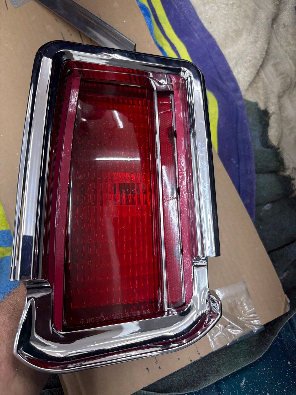

Now the long tedious job of assembly. I got one fender back on yesterday and assembled the tail light assembly. Also cleaned /painted the front and back bumper brackets. Waiting on new gaskets etc. probably start polishing the trim next.

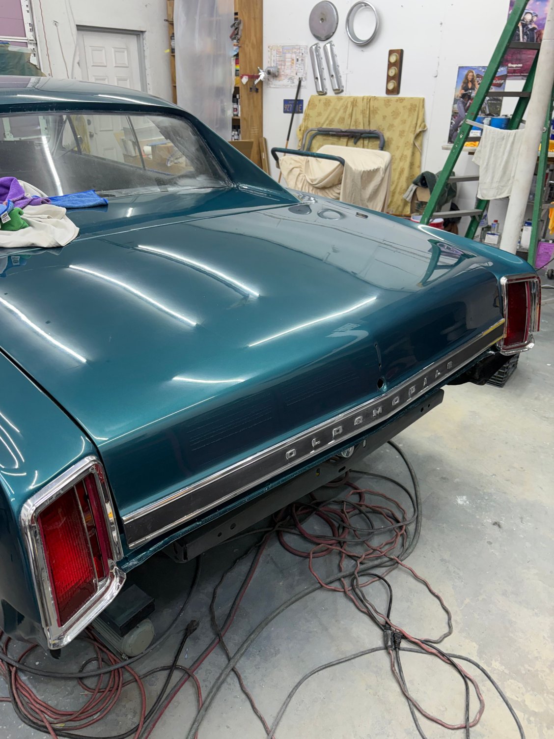

Trunk lid on, lights in, windshield in, fenders on. Fenders aren’t adjusted yet but making progress. I think I will start polishing the stainless next or put rear bumper on. I also need to put the front grill, headlights assemblies together and back on too. Hmm, where to start?

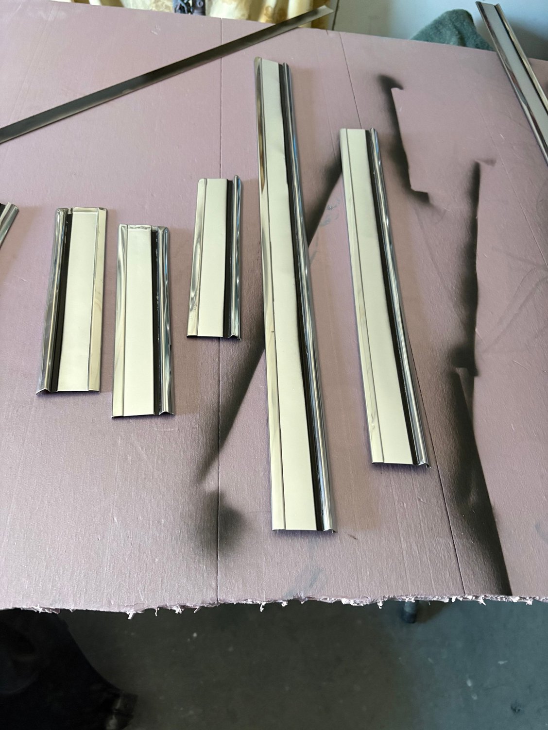

Old May 9, 2026 | 05:59 AM
  #168
Andy's Avatar
Joined: Jan 2020
Posts: 2,895
From: Sarasota Florida

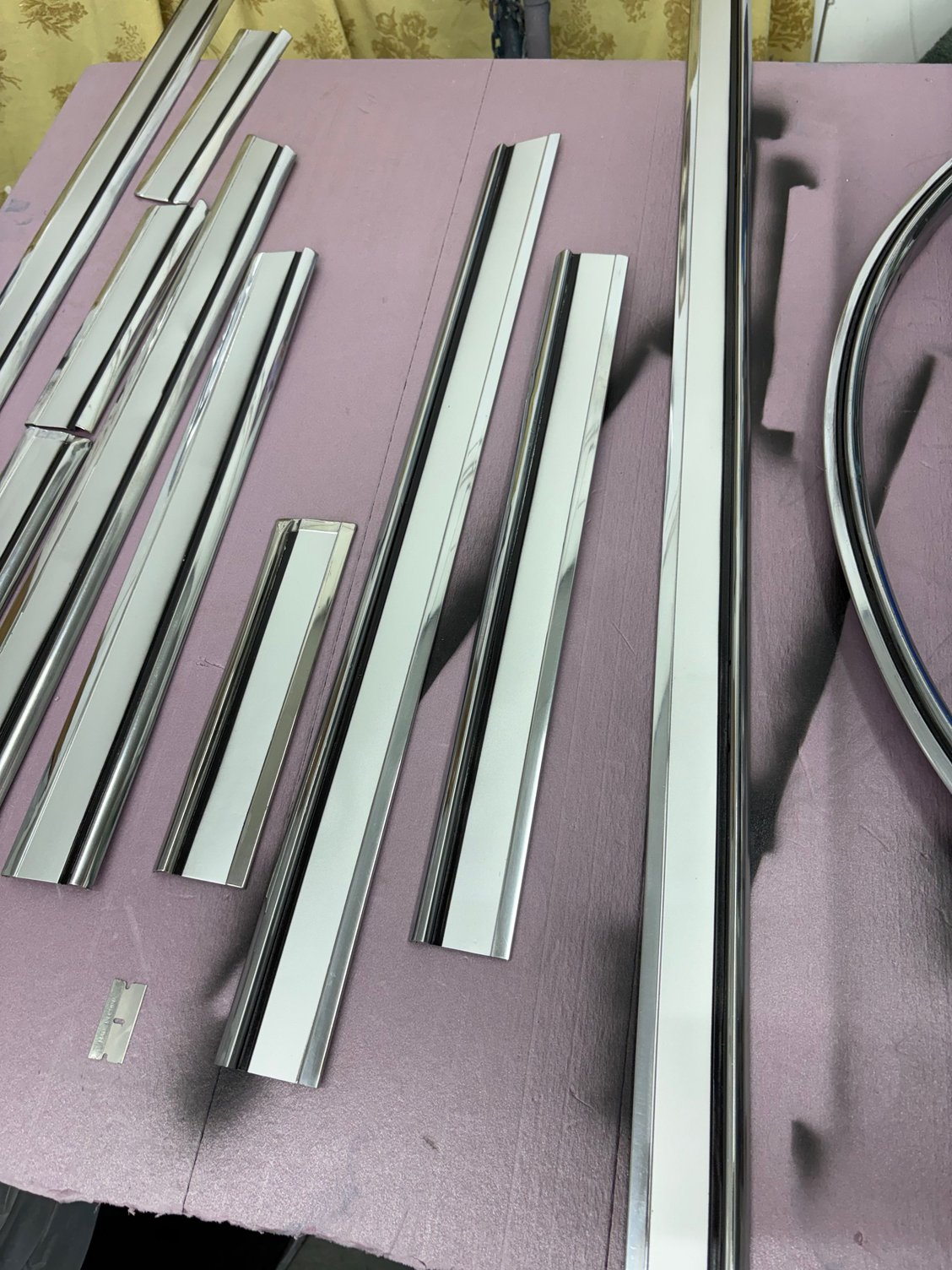

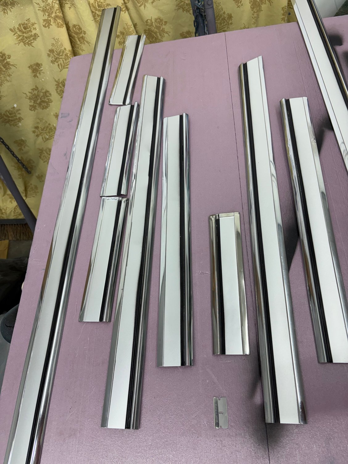

I got most of the trim polished, taped off and painted. Got the new tires mounted on the super stock 1 wheels. Need to install trim and bumpers next.

Old May 9, 2026 | 01:30 PM
  #171
Iron Oxide's Avatar
Joined: Dec 2024
Posts: 26
From: The Eastern Shore
Hi Andy, that trim looks great - what are you using to polish? I had only partial success with harbor freight cotton buffing wheels and grey compound so I now have a few alternatives on order from renegade (those orange and yellow ones I believe).
Old May 9, 2026 | 02:55 PM
  #172
Andy's Avatar
Joined: Jan 2020
Posts: 2,895
‘using harbor freight wheels and a black and white compound. They aren’t like mirrors etc, I also used 0000 steel wool and blue stainless polish. My trim was in pretty good shape, the taping off and painting the argent silver and the black was time consuming as well. I used vht ford argent silver high heat paint.
Old May 9, 2026 | 05:38 PM
  #173
Iron Oxide's Avatar
Joined: Dec 2024
Posts: 26
Really nice Andy. I thought mine were decent enough to start but they must require a coarser grit prior to the cotton wheel to get the job done. We shall see. Thanks for the motivation, your car is looking terrific.

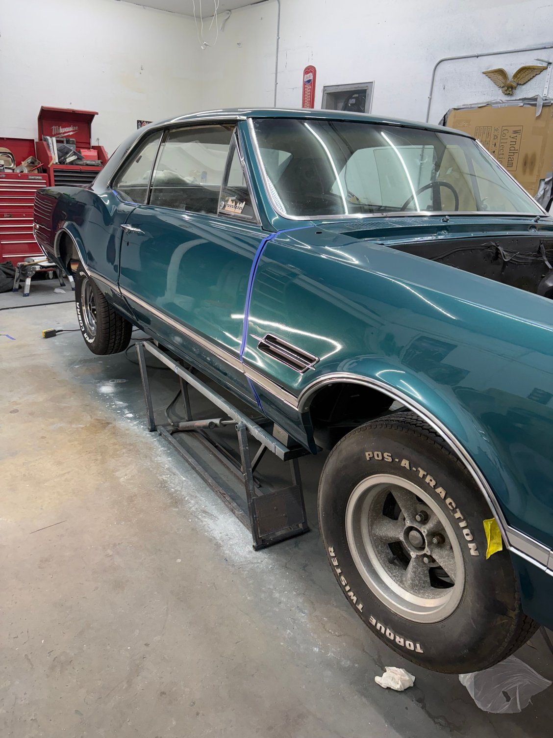

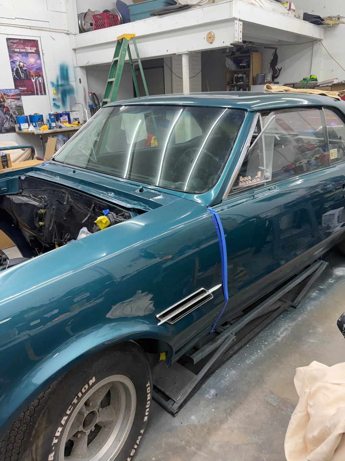

It’s coming together, slow but sure. Exciting!! It’s starting to look like a 442..making progress..that’s what’s important..🤓 Next up, align front fenders and put the front end / grill etc together.
