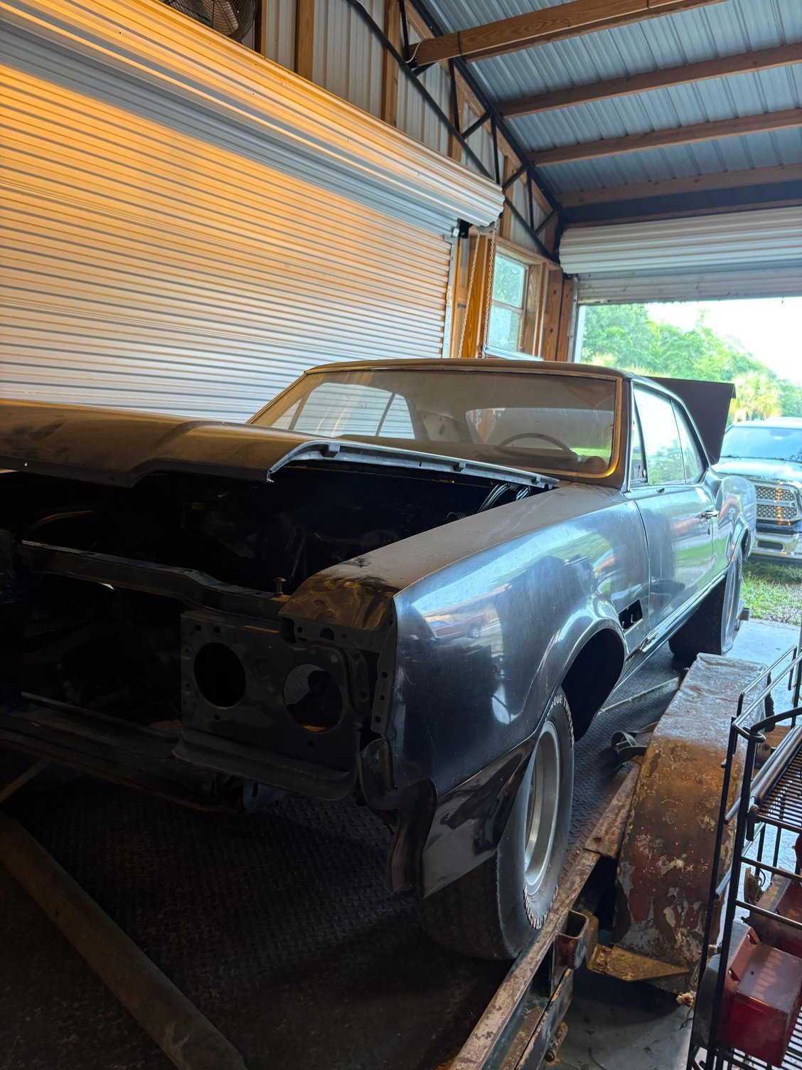

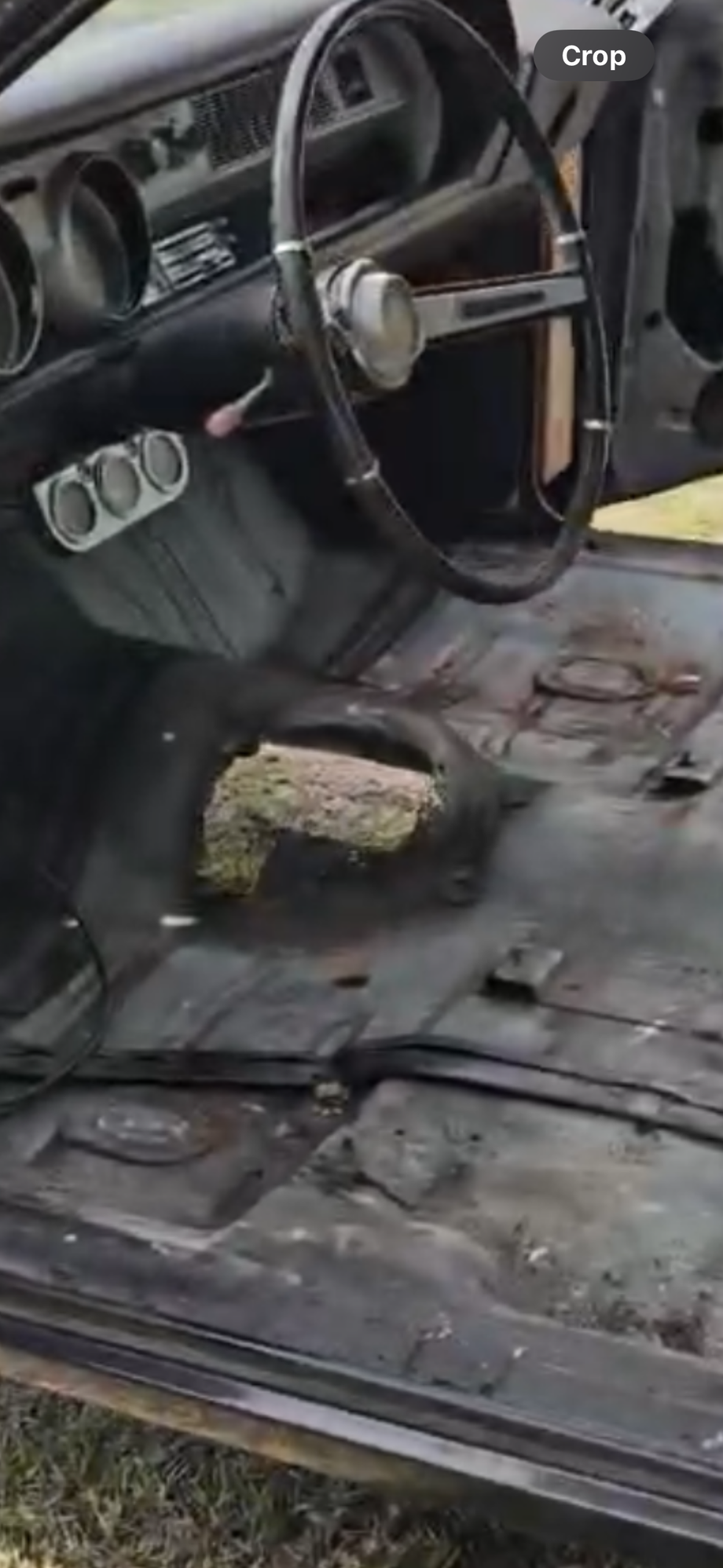

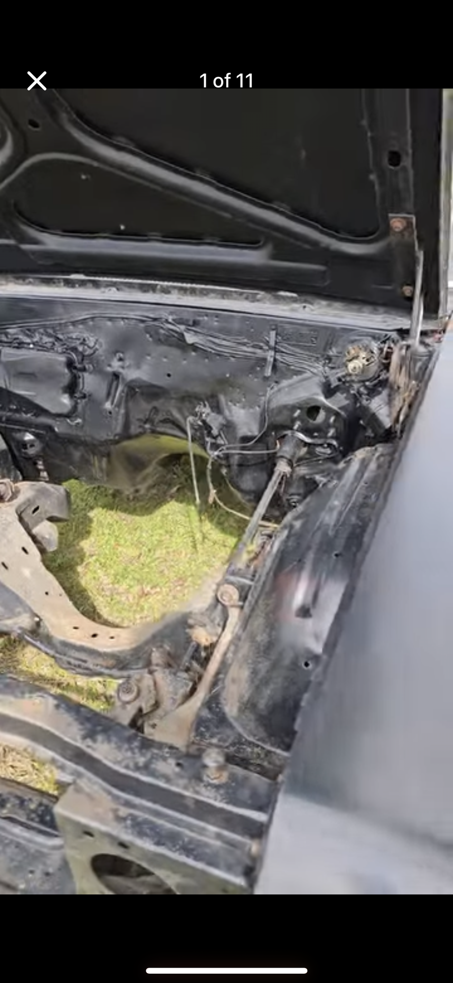

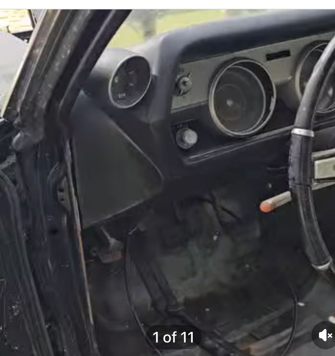

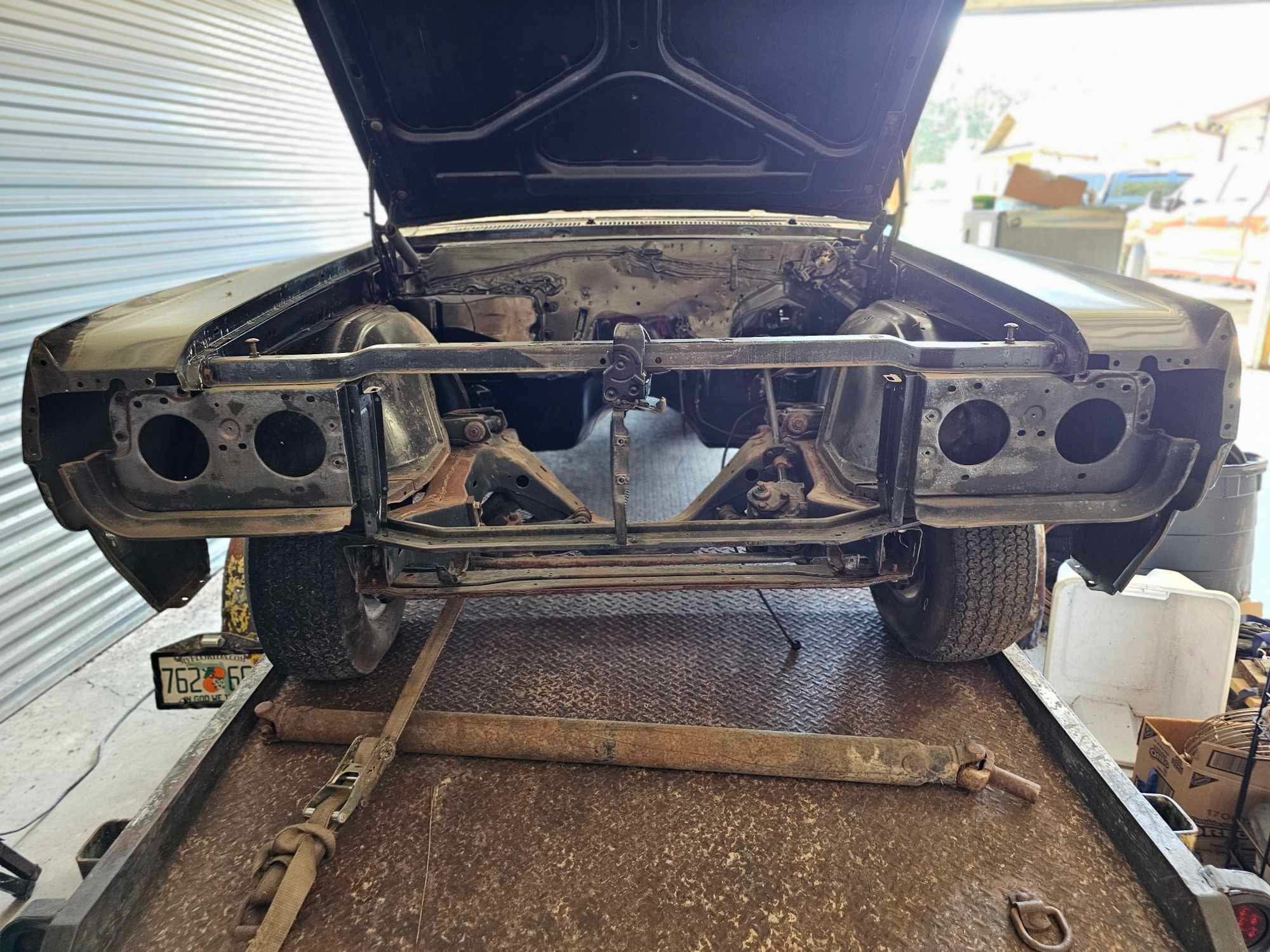

My newest project.. body is 95% rust free, validated through protecto plate to be a true L69, TH 390 posi rear end. Lots of work but I am ready to jump into the eeep end..wish me luck.

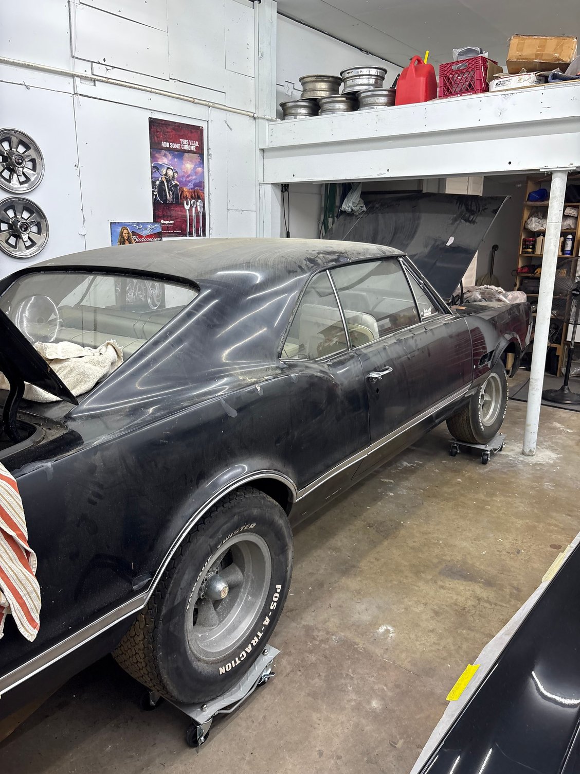

Needs lots of love..but never wrecked, unbelievably solid body

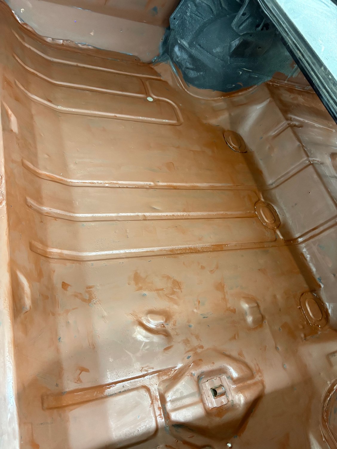

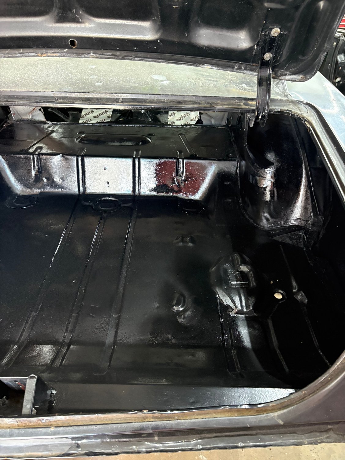

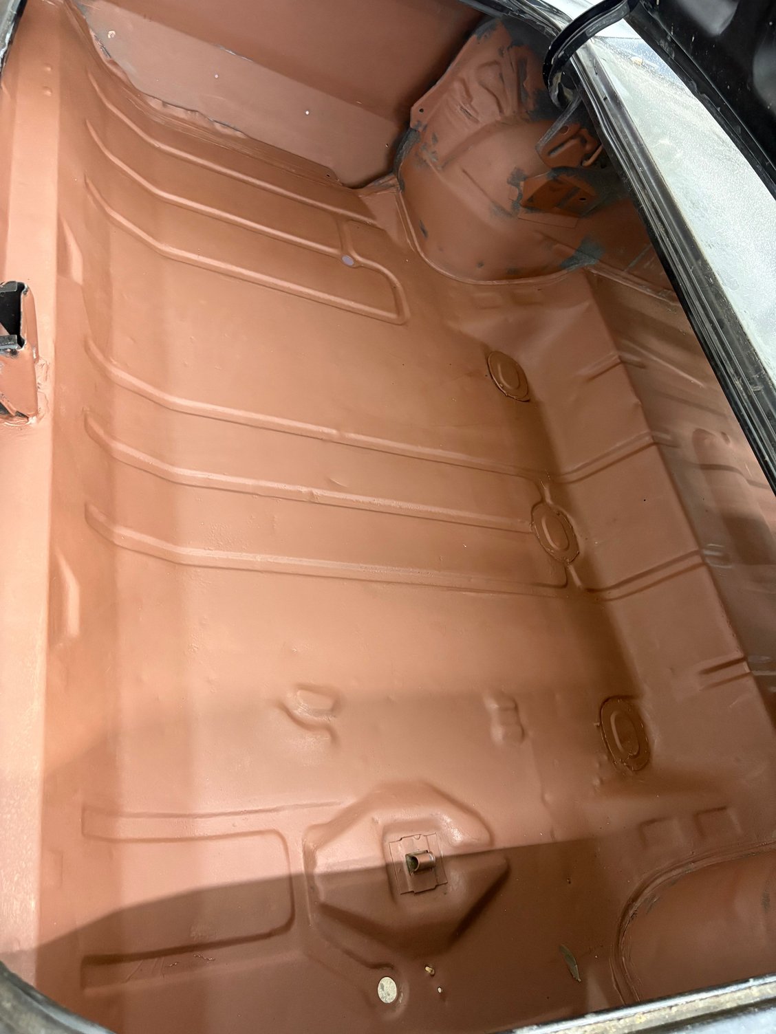

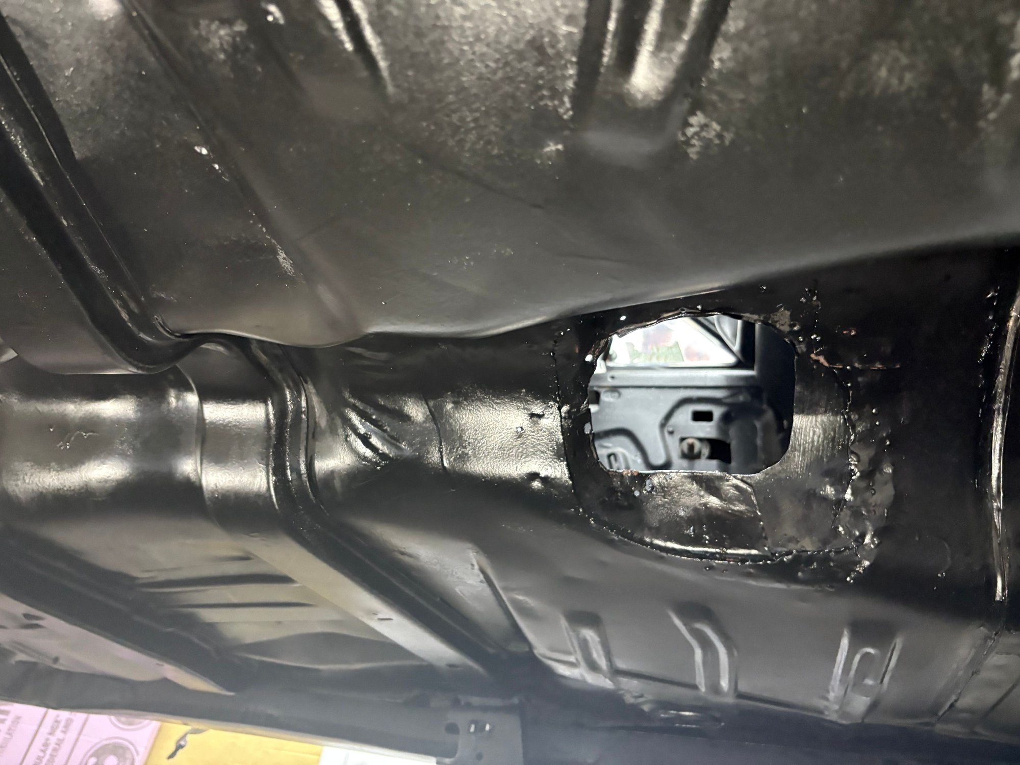

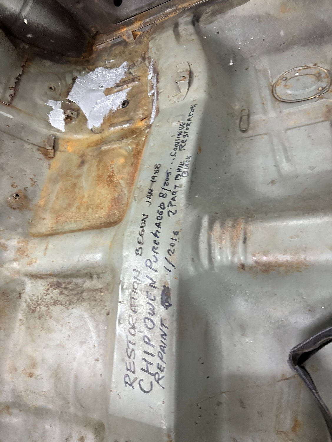

Well some progress, sanded and lightly primered trunk floor. Replaced most drainage plugs and had to fabricate a piece for the shift tunnel where someone hacked the hell out of it. Made the piece, welded it and and grinding the welds down. Boot ring should fit perfectly. Next up is sand and prime interior floor pans, rebuild all brakes, then start underneath cleaning and painting the bottom side..

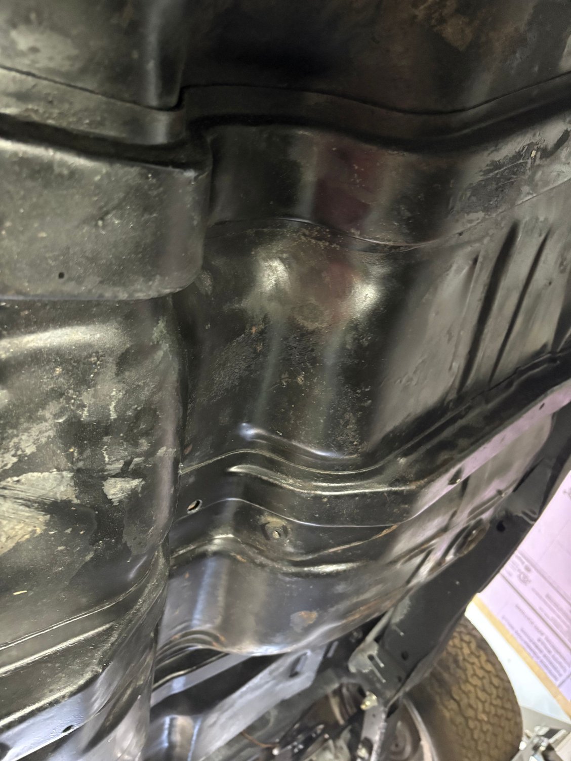

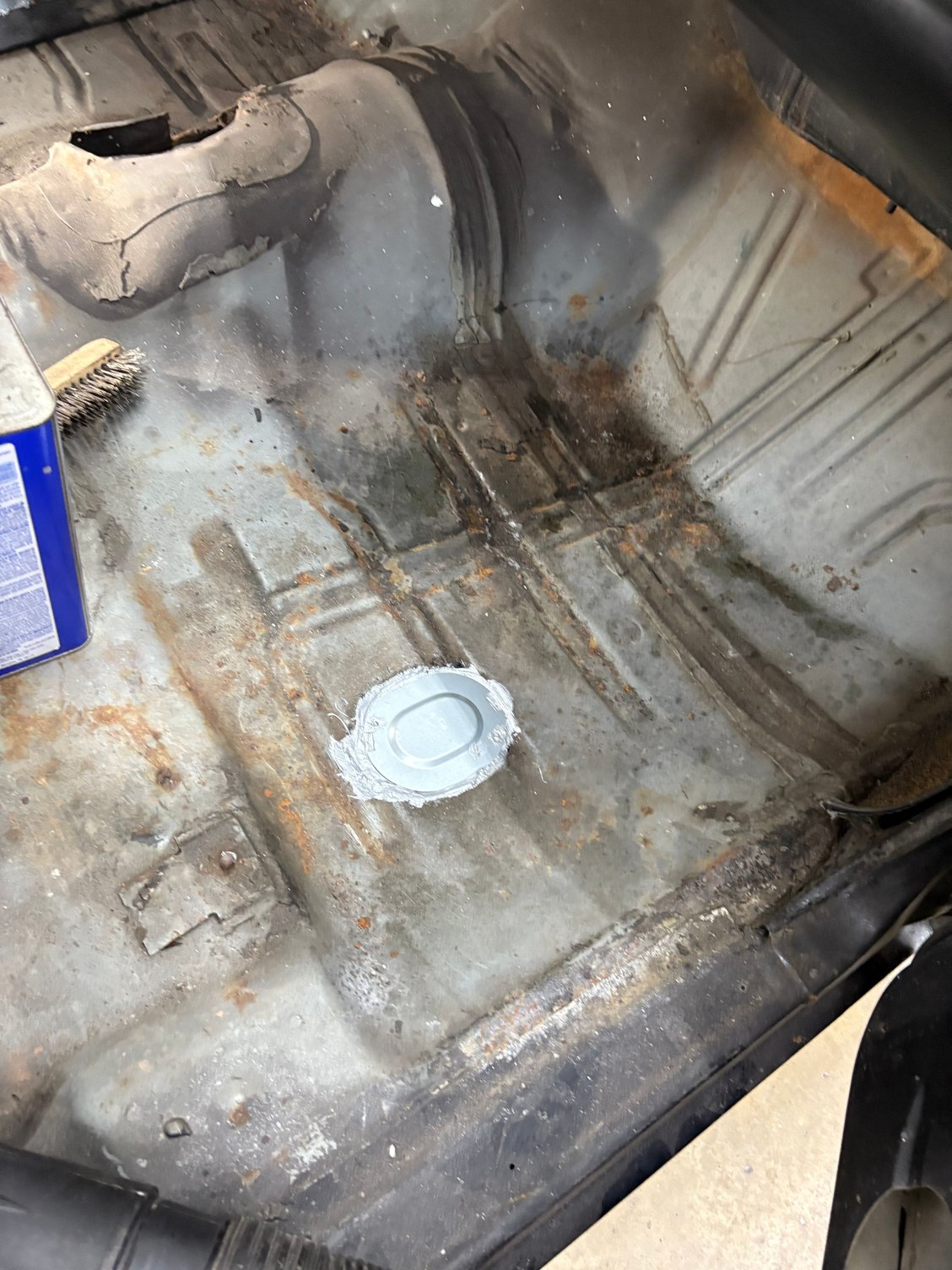

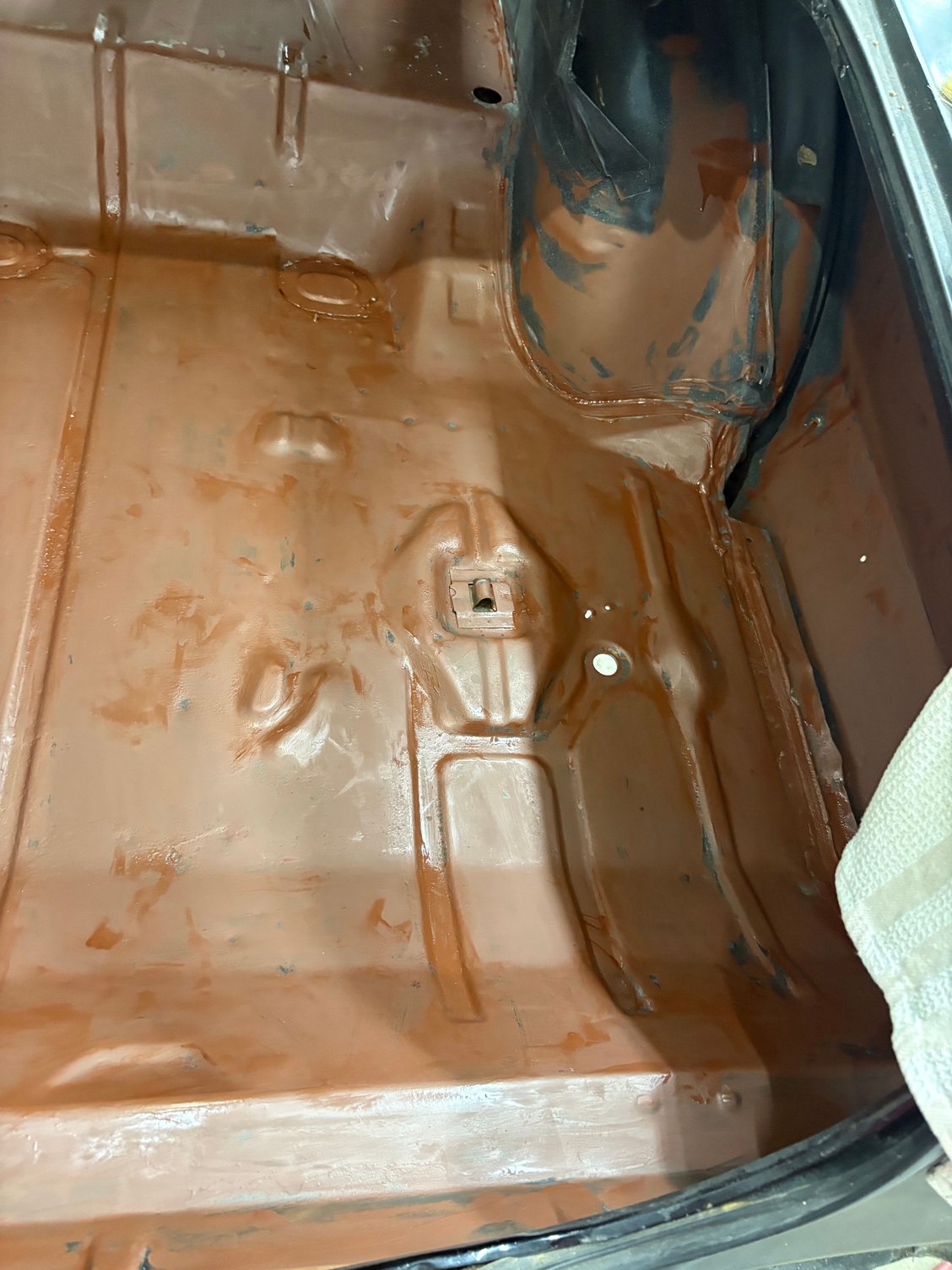

Made some progress, another coat of primer in trunk. Wire wheeled the cabin floors, found a few tiny pin holes otherwise super solid. I used a little all metal on those few tiny pinholes. Reworked the floor boot after welding in the patch on the porch where it was cut out. Reworked that metal so the boot ring will fit nicely now. Will clean prep and paint trunk and floor next..then underside after this complete..

Wow,
"Restoration was begun in Jan 1988." over 37 years ago.
Hope you finally see it through Andy.

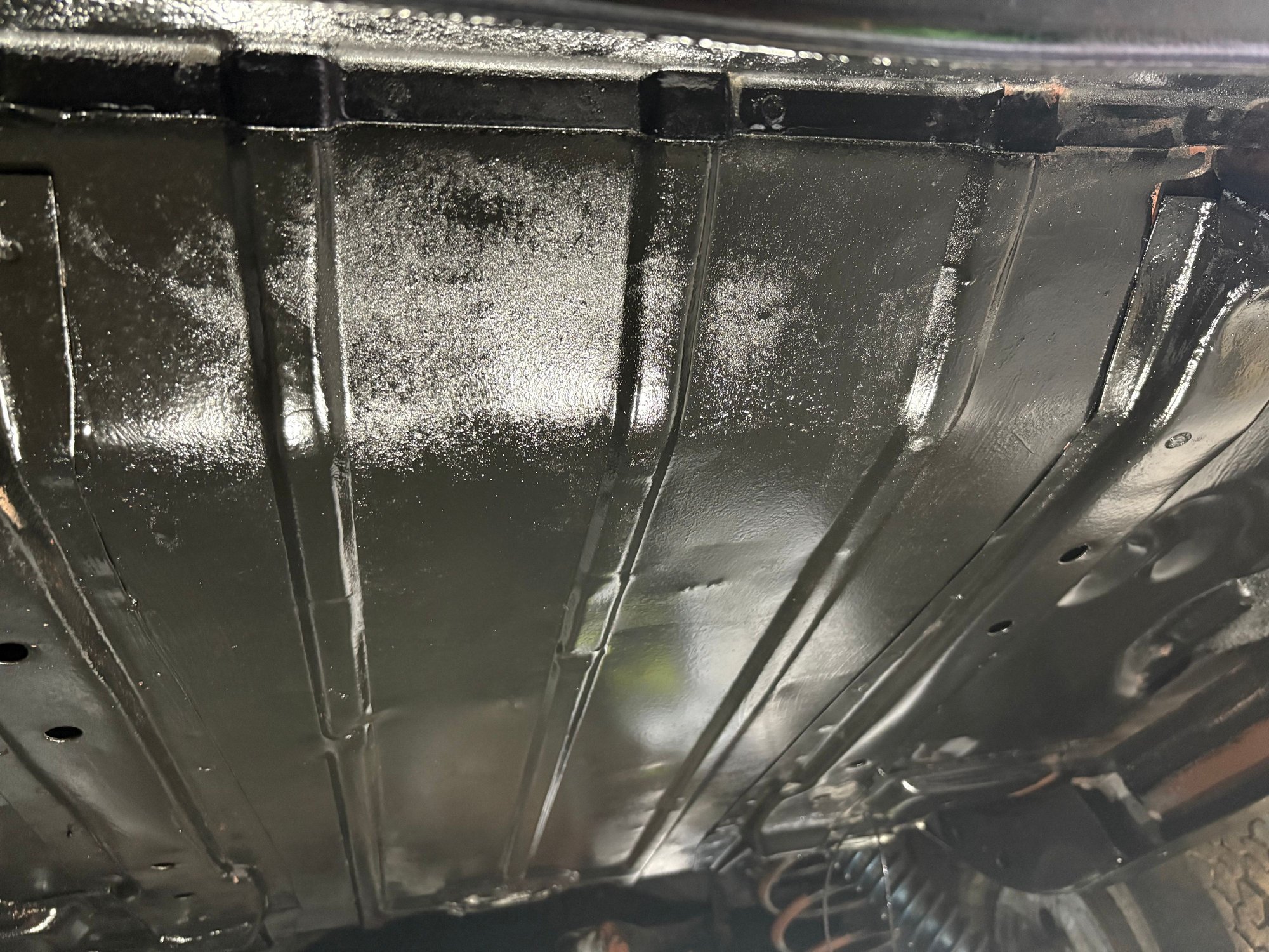

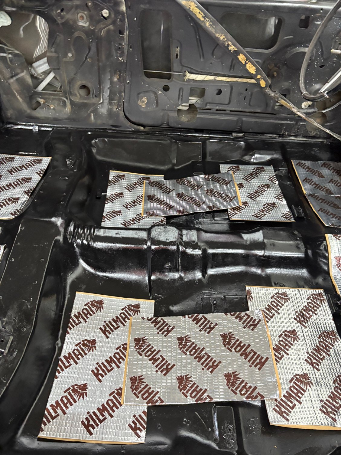

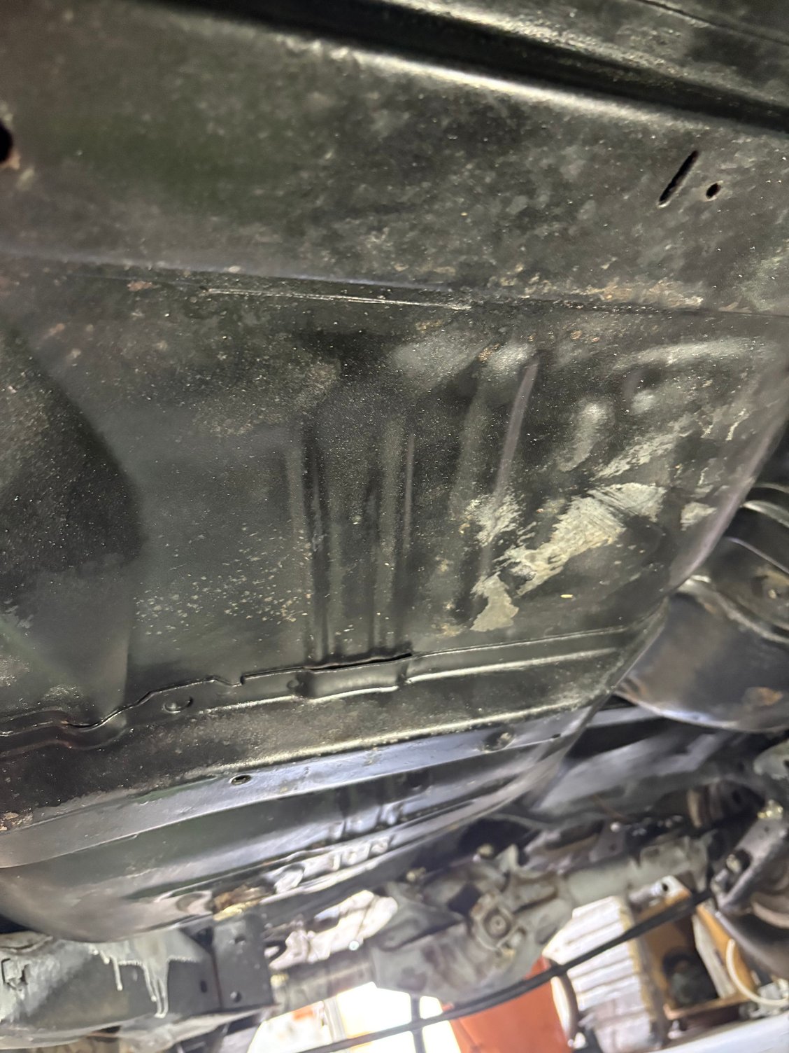

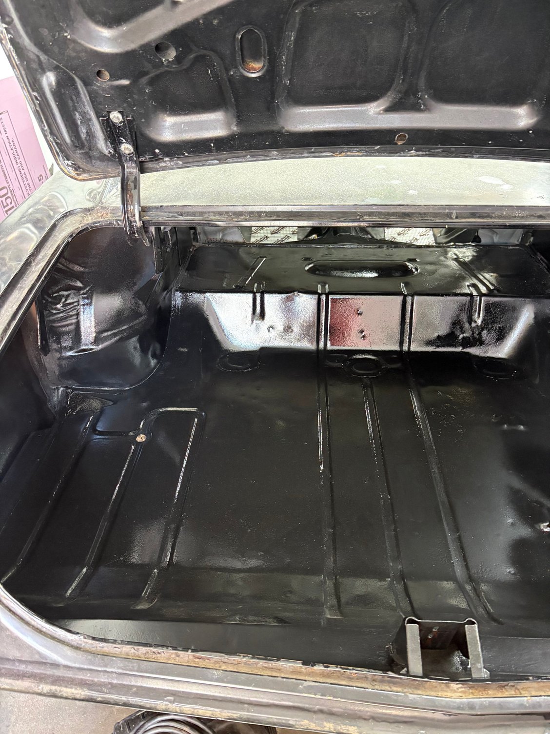

Making progress.. Sanded, primed and painted trunk and cabin floors..new drain plugs. Got some insulation mat just sitting there till I install. Got bottom of car pressure washed, osphoed and surface rust..time to clean and paint underside..Then onto the brakes..

Are you using trunk paint or Zolatone in the trunk?
Or just the black paint?
Looks like a lot of hard and dirty work has already been done for you,
Old Jun 23, 2025 | 03:45 AM
  #35
Andy's Avatar
Joined: Jan 2020
Posts: 2,898
From: Sarasota Florida
I used rustoleum oil based primer, sprayed Rustoleum oil based black over the top of two coats of the primer..wire wheeled it all first, put in new floor plugs, cleaned with degreaser before painting etc. 66 we’re body color paint, not spattered paint. Car will be black so trunk black.

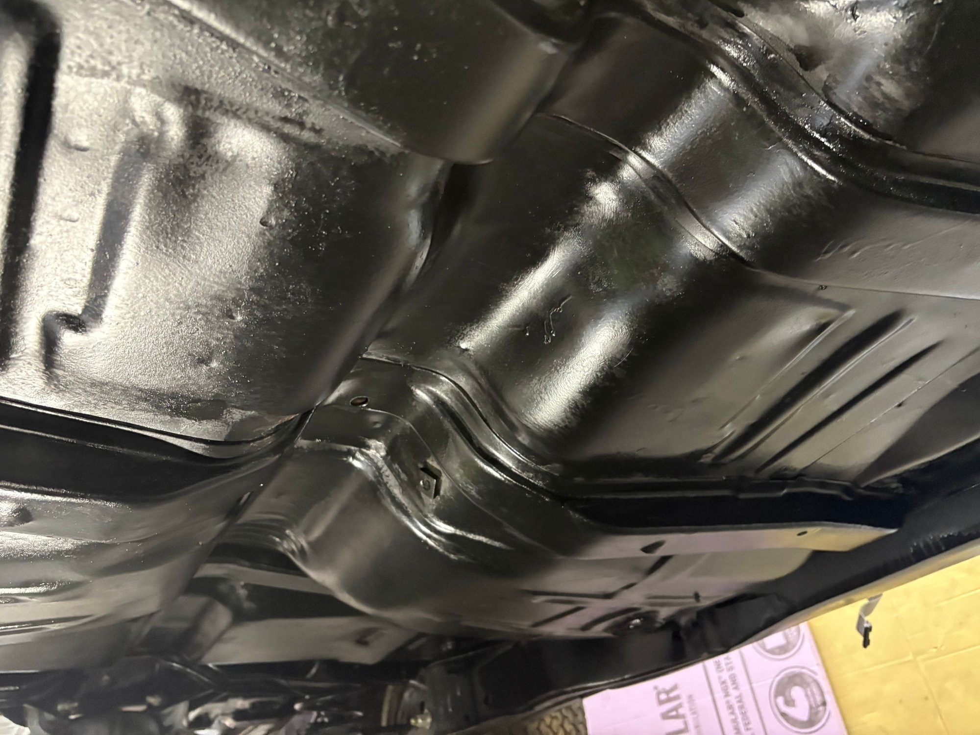

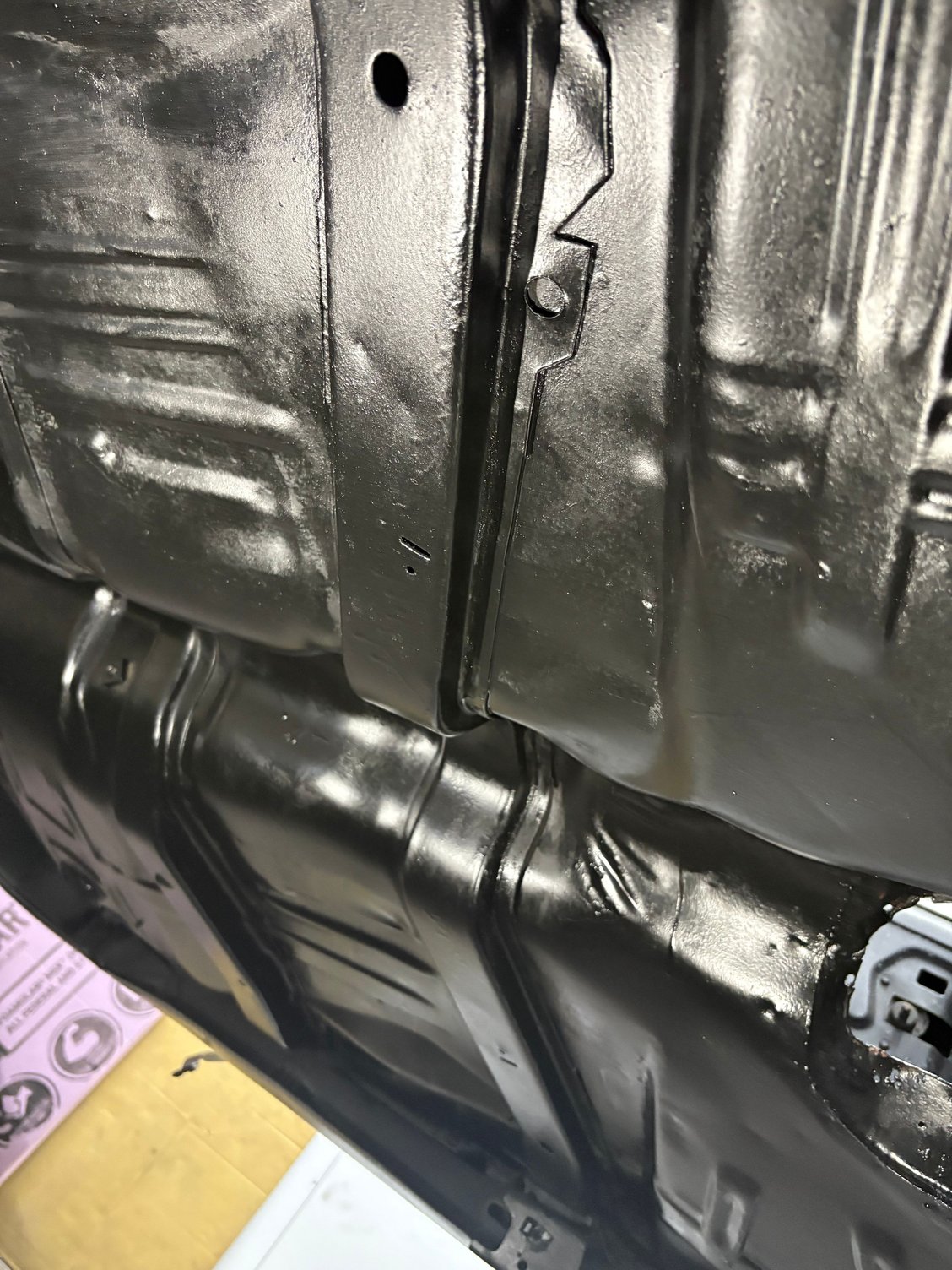

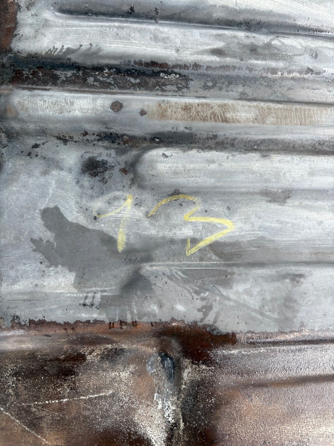

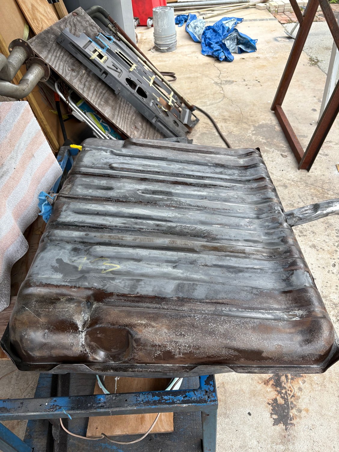

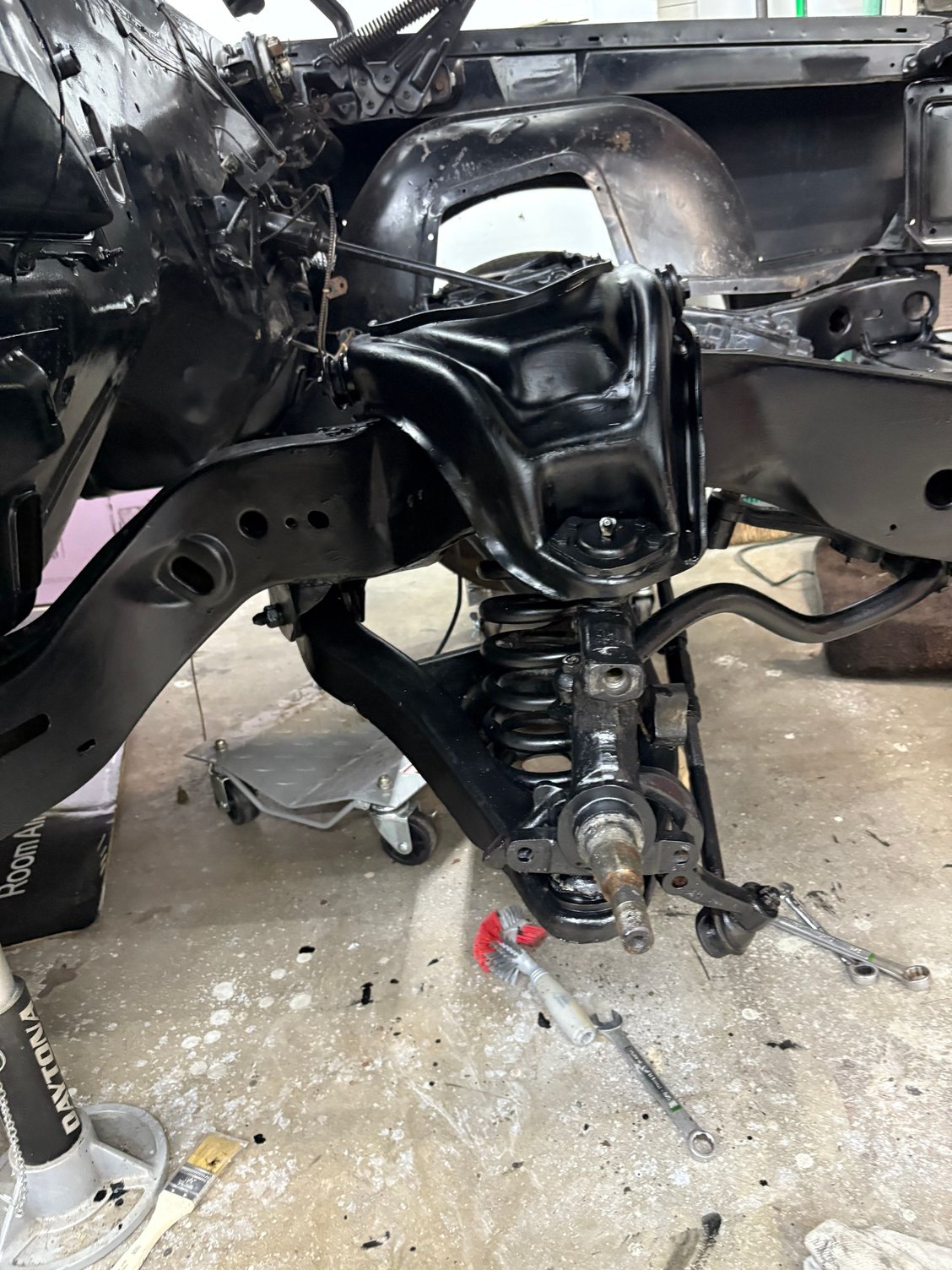

I got the underside wire wheeled. Cleaned and painted. Needs some touch up tomorrow, then the front engine compartment and chassis before starting on brakes. I think I showered 2 pounds of dirt and wire wheel wires stuck in my body tonight..long day

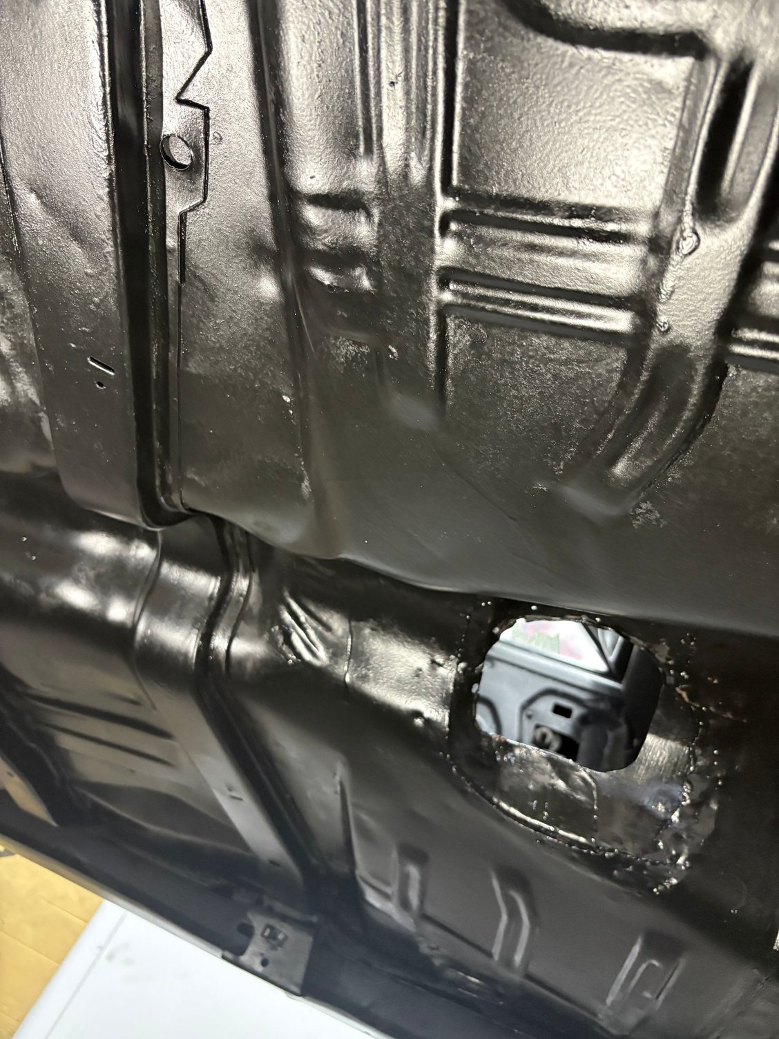

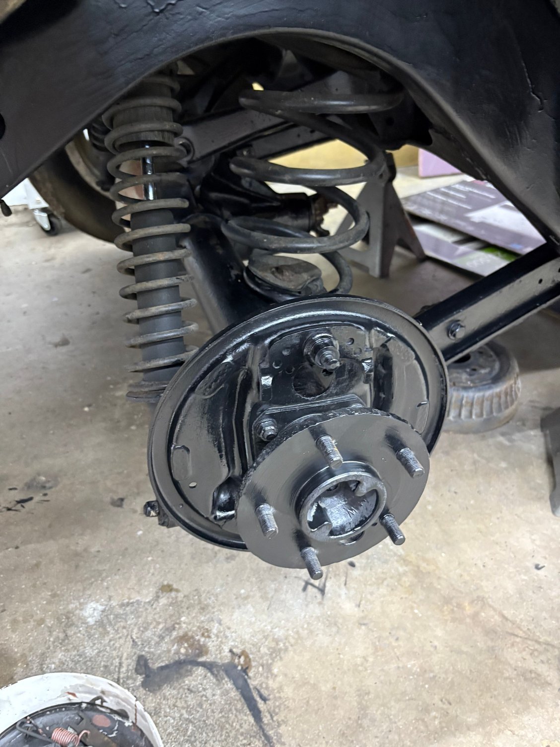

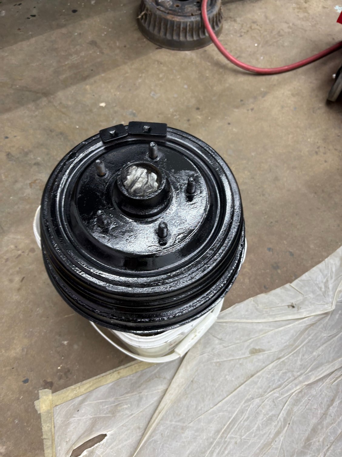

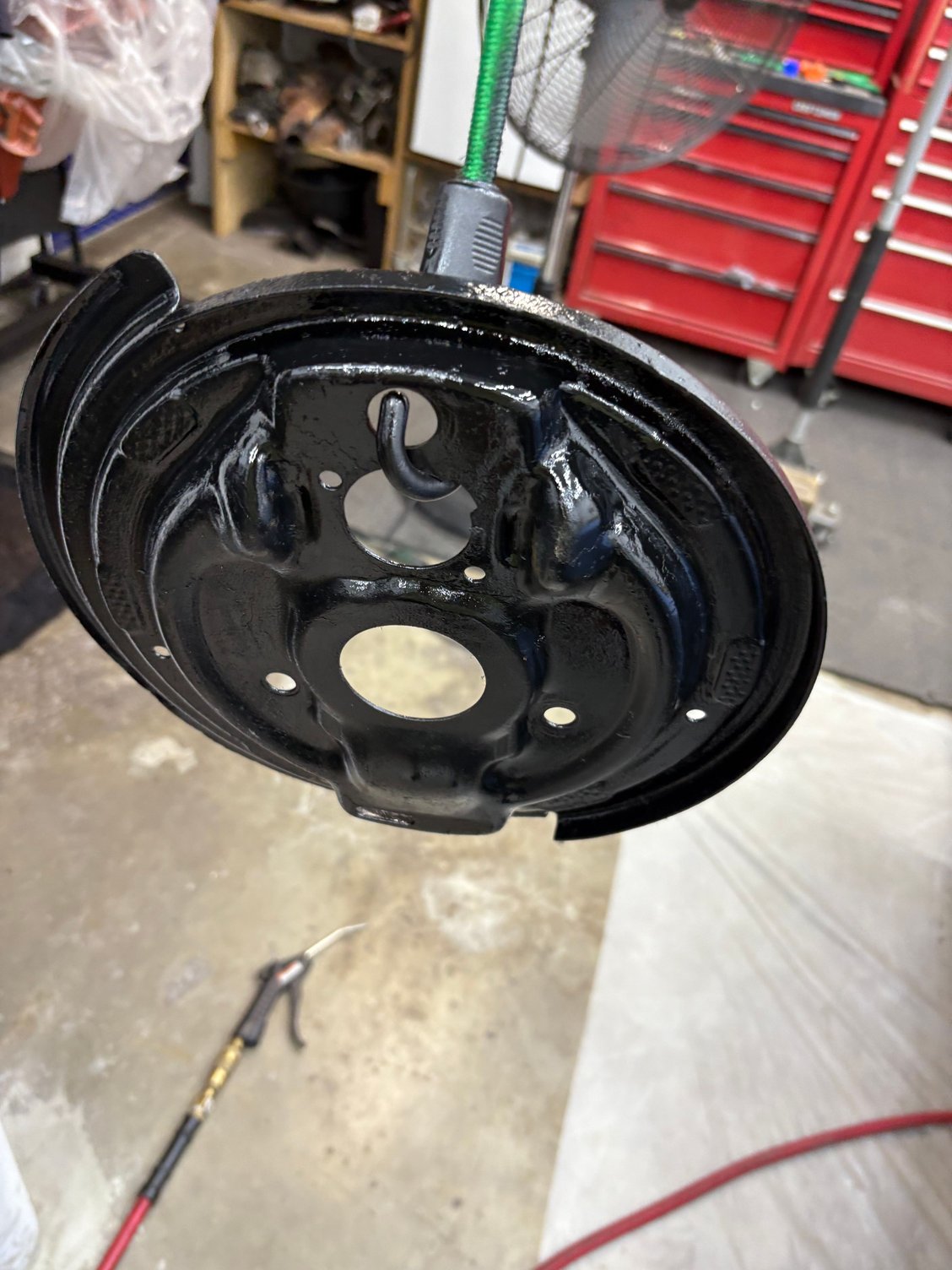

Doing some more detail painting while waiting for new brakes to install all around. Removed the passenger side fender well, much better access..Lot of laying on your back cleaning and painting but hey it gettin done if ya don’t get your **** in motion right? the gas tank looked rough but about an hour plus with a wire wheel and it cleaned up real nice, other side was another hour plus to do. I don’t see any pinholes, but I’ll keep cleaning it and getting it right and then I’ll pressure test it maybe run a little bit evaporust inside as I saw a tiny bit of rust in one corner. Does anybody have any suggestions on what to coat the inside tank with?

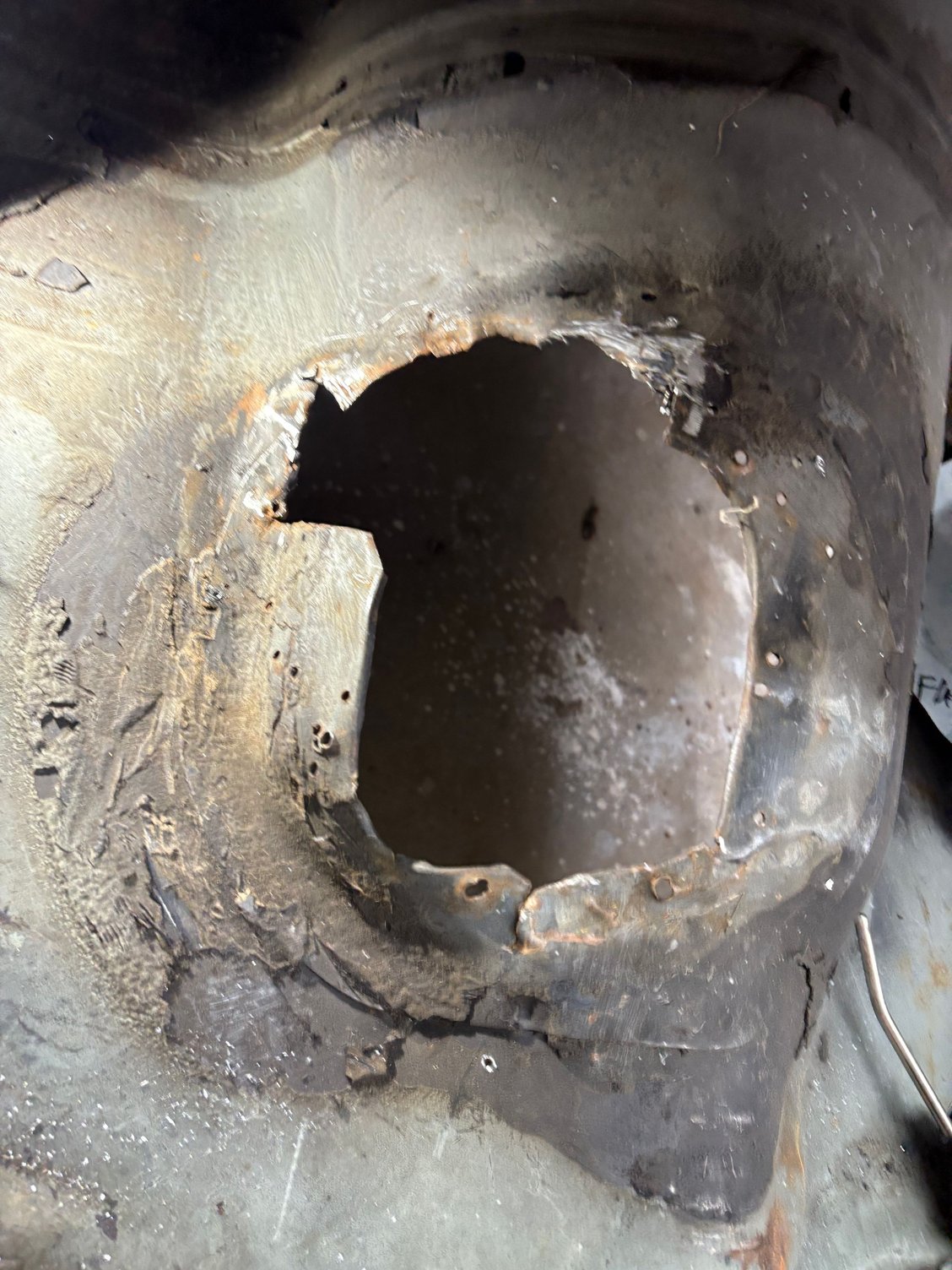

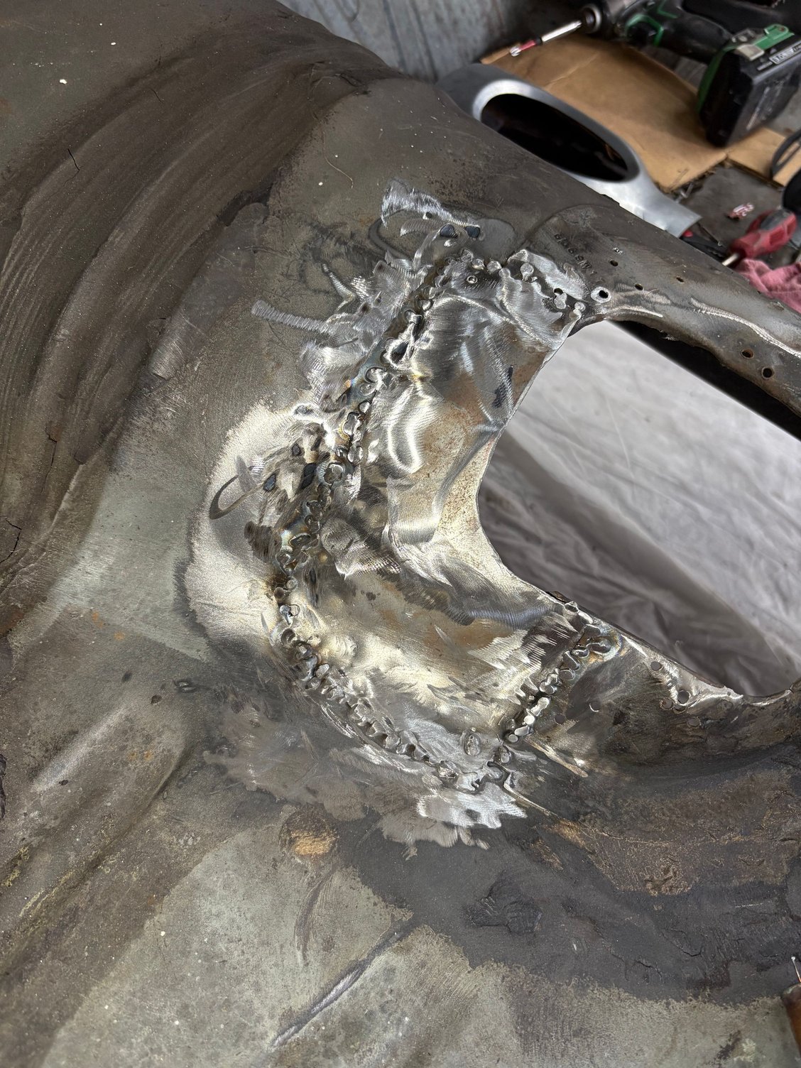

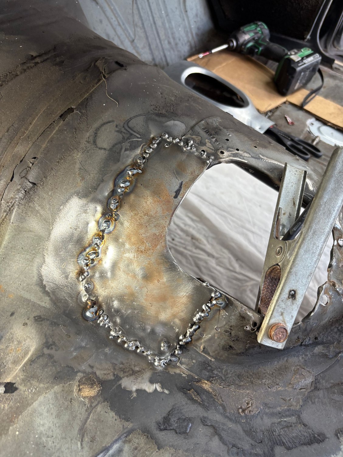

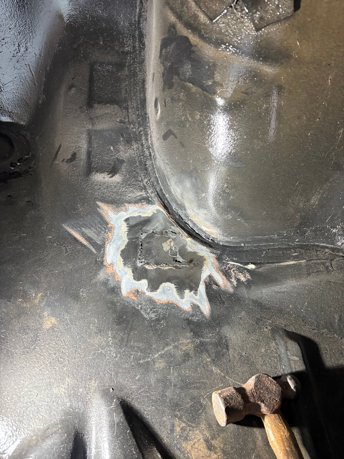

Note to self, before prepping and painting the trunk make sure the body mount caged nuts aren’t broken loose inside.. had to do some surgery to fix that..need to repaint that trunk area. Gas tank cleaned up nice. Shows the original grease writing of 93 on it. Anyone know what that number is? Then I painted top side satin black, bottom side aluminum. No pin holes etc. moving right along on this car. Starting brakes tomorrow..

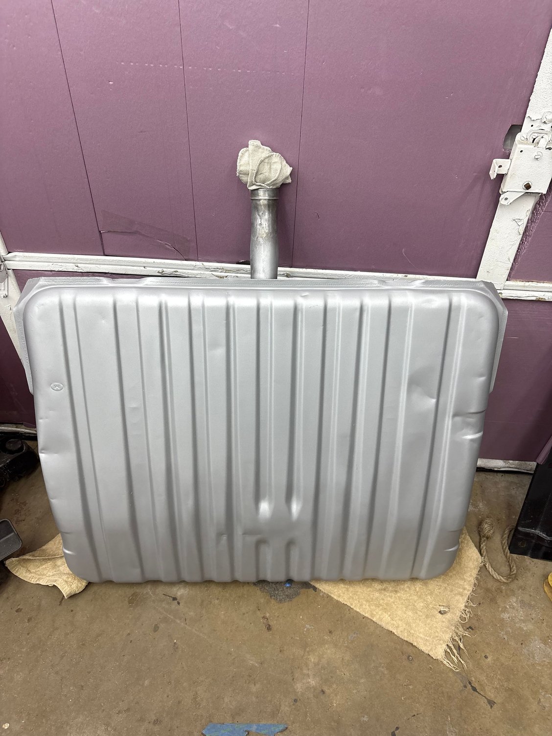

Nice work Andy! And that gas tank looks great for its age. Did you decide on any interior protective coating for it? I dropped mine back in early 1981, had the exterior lightly sand blasted and put a couple hand fulls of large gravel in it giving it the old shake shake shake! Followed that with an interior water wash and after it was dry an interior wash with Ospho. Had some pin holes in the top which I patched with fiberglass. Put it back on and it has been fine.
