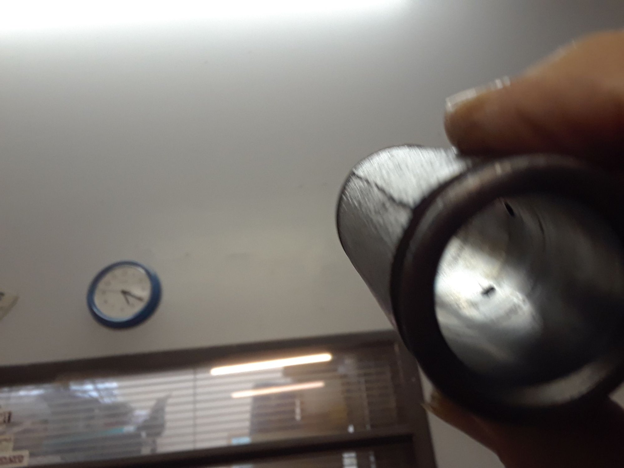

The next day I crawled under the right rear of the car to proceed to bleed the brakes again.
I noticed that he sidewall of my Maypop tire was covered with brake fluid.
It was leaking from the brake drum above it.
It was an AWSH*T moment!

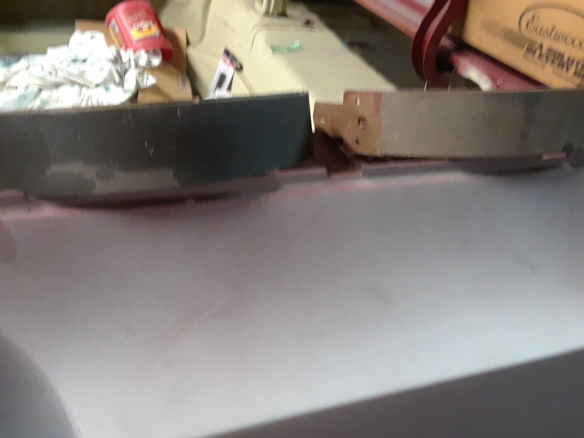

I pulled the wheel and drum to discover that a brand new wheel cylinder was leaking.
Of course, it had to leak on the brake shoes too.
Well, I did an autopsy on the wheel cylinder and discovered it was rusty inside.
Since the wheel cylinder and the brake shoes are readily available and cheap.
I ordered them from Rock Auto.
The failed wheel cylinder was probably NORS from E-Bay 8 or 9 years ago.
Does anyone else have a tale of " New is not always good. " to share?
