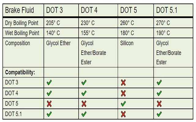

I'm really liking DOT 5.1. It is not silicone and it is backwards compatible with DOT 3 and 4.
Old Aug 2, 2022 | 04:38 PM
Charlie Jones's Avatar
Phantom Phixer
Posts: 5,530
From: Apopka, FL
Is DOT 5.1 hygroscopic, Joe?
Old Aug 2, 2022 | 04:41 PM
Unfortunately since is is glycol-based, yes it is. Frankly I haven't really had a problem with this.

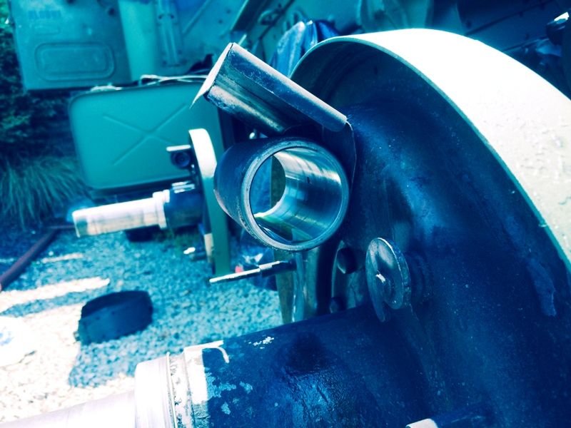

Here is a picture of the wheel cylinder pistons out of my 5 ton, from an unknown duration.
Yes, it holds a lot of fluid...
As for bleeding, gravity works ok.
Vacuum works well to pull it through the wheel cylinder/caliper if you have issues with gravity bleeding.
FYI when it ages, it turns from purple to yellow but still works well.
What are the advantages of 5.1 over silicone?
Old Aug 3, 2022 | 05:48 AM
It is completely compatible with older brake systems and DOT 3 and 4 fluid, but has a higher boiling point than even silicone fluid. You don't have to worry about flushing every last bit of the old fluid out of the system. Pricing of 5 and 5.1 is about the same.
The DOT 5 Composition says silicon. That’s a hard glass-like element that semiconductors are made of. I see lots of breast implants are erroneously claimed to be made of the same substance. That’ll poke your eye out.
Old Aug 4, 2022 | 05:39 AM
Not the first time someone has made that mistake...
