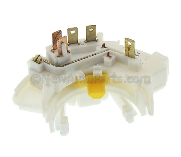

^^^THIS!!! Read the Chassis Service Manual. By the late-1970s GM had replaced the NSS with a mechanical "blocking" feature in the steering column that prevents the actuating rod from the lock cylinder to the switch from moving unless the shifter collar is in PARK or NEUTRAL. There IS a switch on the steering column, but it is used as the backup lamp switch and on cars with a computer it provides the Park/Neutral signal for the purpose of controlling idle speed. It is NOT wired into the starter circuit in any way.

Are you 100% sure that it is just for the reverse lights? If that were the case then it would only need the one connection, not all of this.
I just seems to me like a standard neutral safety switch, but I could be way off base.

I'm 120% sure that if you trace all of those wires, not one of them will be connected to the starter circuit. Again, in addition to the backup lights, this switch provides a PARK/NEUTRAL signal. It also is used in the seatbelt buzzer circuit.
