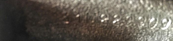

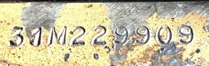

The VIN derivative number is stamped onto an iron pad on the engine block located on front LH side of engine behind the ALT (sometimes makes it difficult to see) & just below cyl. #1. The TH-350 transmission VIN derivative number is stamped onto the LH side of the transmission & the axle number is stamped on the RH side of the rear axle. If others haven't provided images, diagrams by the time I finish typing this, I'll provide you w/ several.

Incoming....
Old Dec 21, 2023 | 03:37 PM
Posts: 26,053
Rear axle stamp location = front-facing passenger side...
