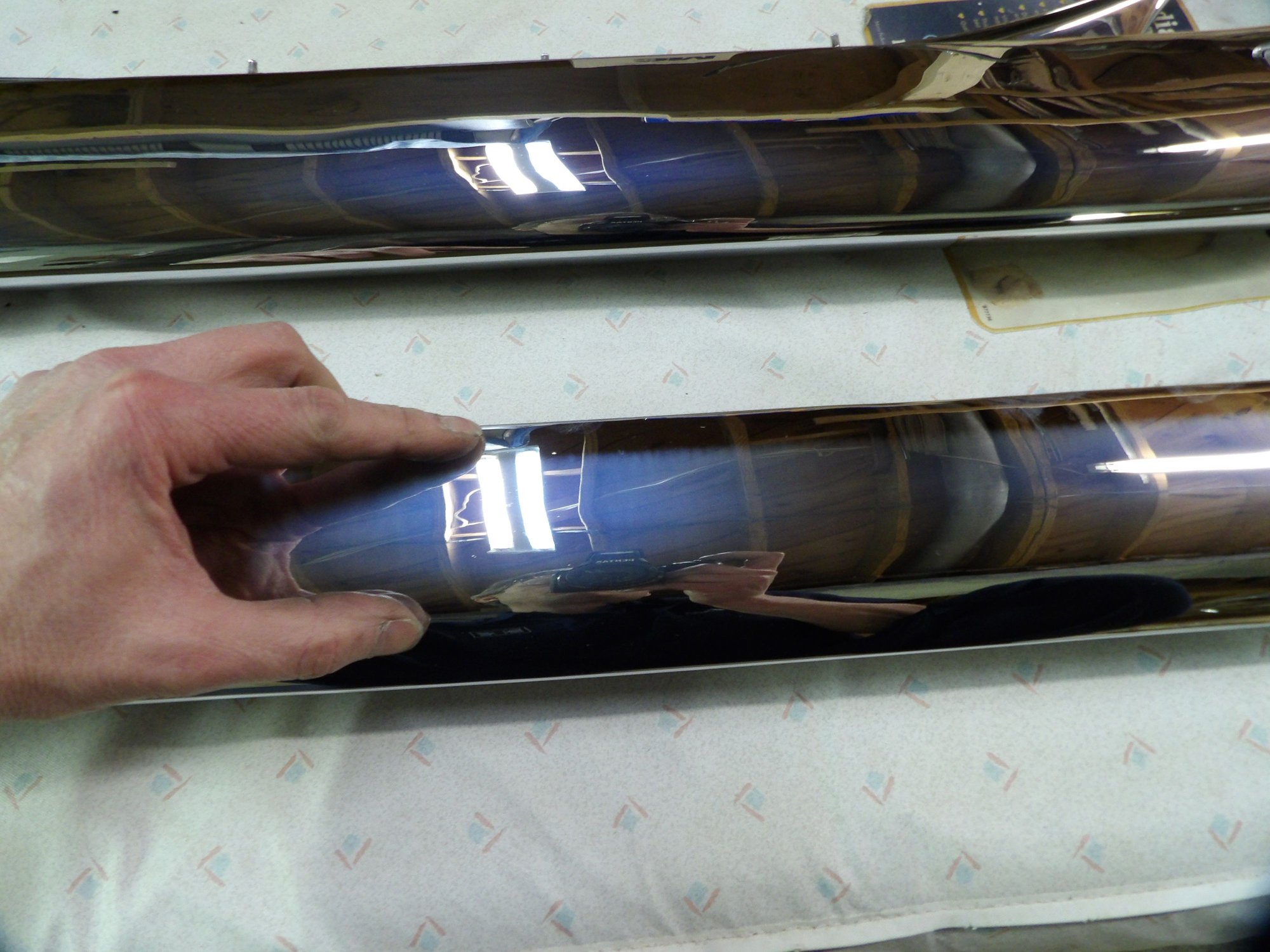

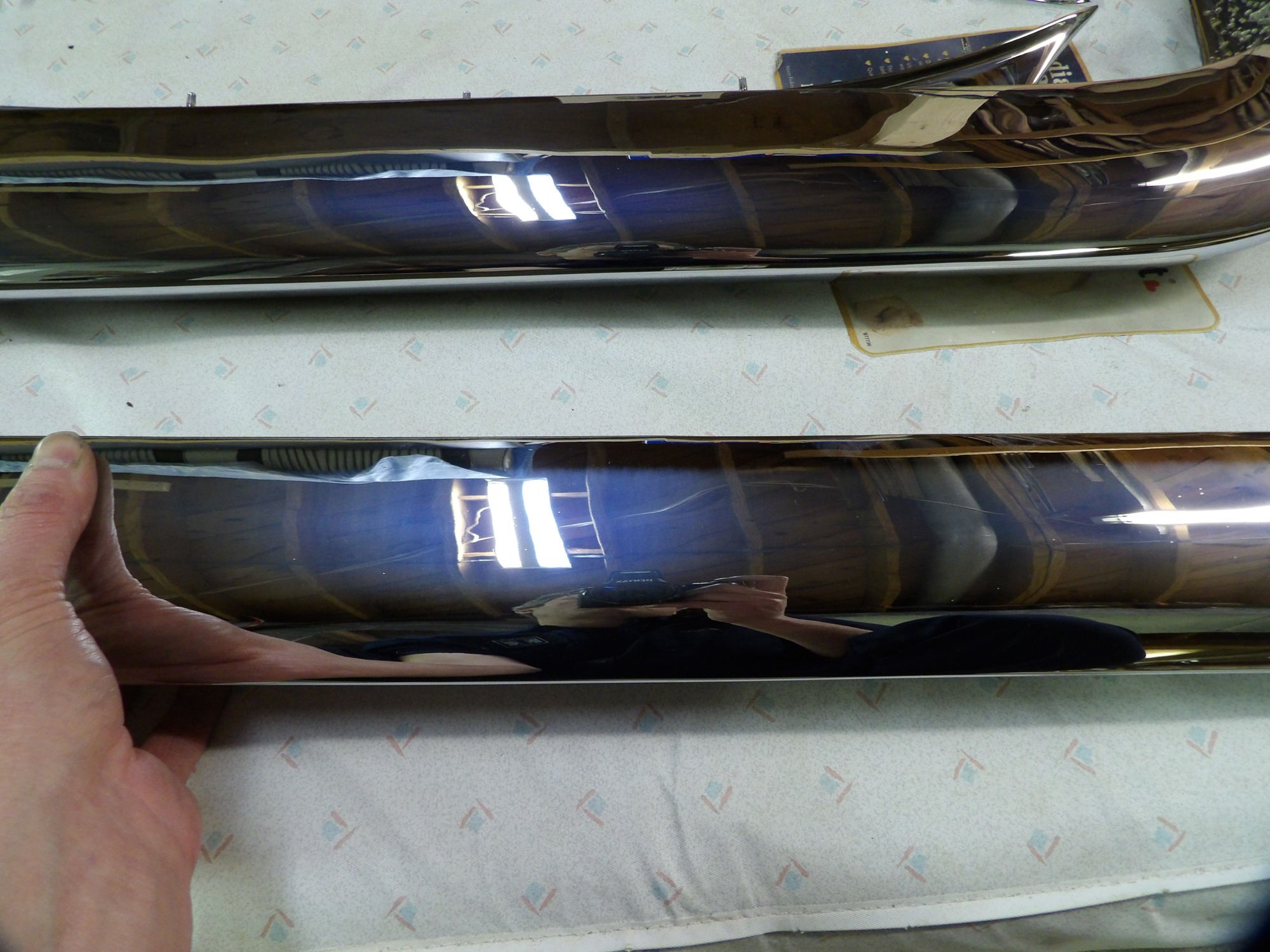

Just got back from the chrome shop with my parts. The bumpers were already wrapped up and I was in a hurry so I did not unwrap them there to look at them. I got home and at first thought they were great but then I noticed the edges are outstanding but between the edges the chrome is very cloudy. I did not know it but he farmed out the bumpers, he originally told me that mine were small enough that he would do them. Well, Now I have to take them back for them to be done again because this is not acceptable. They are very smooth and I would be very please if not for that. I assume this can not be polished out? Sure wish he would have done them. Now it is two more trips to his shop at 1.5 hours away.

I’ve never rechromed anything but that looks **** poor. Did you try to see if it wipes off or buffs out?

In my limited experience with rechroming some items, I had a similar experience. In that case they were able to be buffed out. If the part looks otherwise excellent, hopefully that will be the case for yourself.
Many things can go astray in electroplating--such as bath composition and poor chrome deposition in some areas due to non-uniform current density. If it doesn't buff, maybe they'll electrostrip the chrome, reactivate the nickle, and try again.

This is what I get for going cheaper.... My first quote from a place was $6000 for these bumpers and 6 other pieces. This place done them for $2500 and on top of that I had 5 more things done. 2 of the other parts were trashed but I was warned that would happen before I took them. I guess every chrome shop goofs those two parts up. Everything else I am pleased with. I sure hope it can be buffed out because the good areas look amazing. Chrome polish does not do anything to it

Just talked to him and sent him some pictures. He said that it is for sure not buffed like it was supposed to be and that he will take car of it. He was not even hesitant that it was wrong and he would take car of it. Said he could likely do it while I wait if I have an hour or two when I come. He is telling me that when he farms it out that he gets them back not buffed and that his guys do that themselves. He said it was his fault and not the place that it was farmed out to. I figure if he is taking the blame and not passing the buck then I am not likely to have a problem with it.

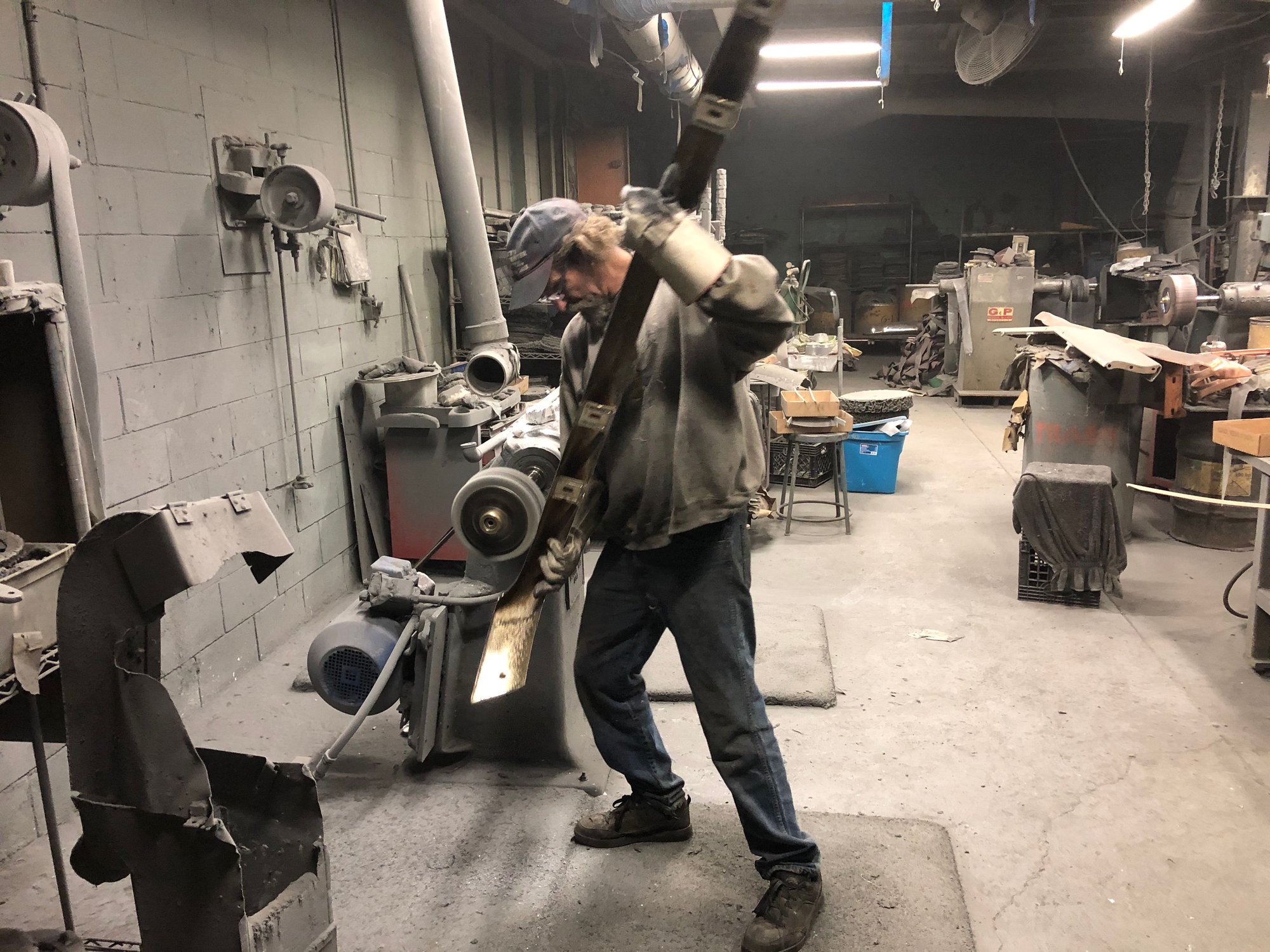

Well, Went back today and he started buffing them. His story has changed about what happened and who done the chrome. He looked up my parts and now says that they done the entire job and they were not farmed out at all. Not sure if he was confused about what parts I had or what, don't really matter because he is making it right. He started buffing the front bumper and ask if I wanted to come back and watch. Not sure if I was supposed to take a picture but he didn't say I couldn't. He got the front bumper done and wrapped it up before I could look at it. I told him I wanted to see it. It was not near as bad but was still not going to work. He was trying to get me to go away I assume. I showed him again and that I didn't like it. He did not get mad in any way and just said the chrome is to thin to buff any more so just leave them and he will strip them and start over. We will see where it goes but at least neither of us was mad about it and I have time before I need them.

My assumption would be that he knew it was still not the standard you wanted and was hoping you wouldn't look until you were home and not wanting to make that drive again. Maybe I'm wrong...but when something I've done isn't to the required standard, I'll make sure I offer it up for inspection before I call it done. He knew it wasn't going to cut it so didn't flinch when he got called on having to redo it. I'm glad to hear that he is stepping up to the plate in that regard.
I'm no expert on chrome, but my first thought when I saw it was that it was too thin. Possibly from over buffing in the first place, trying to clear up some imperfections.
