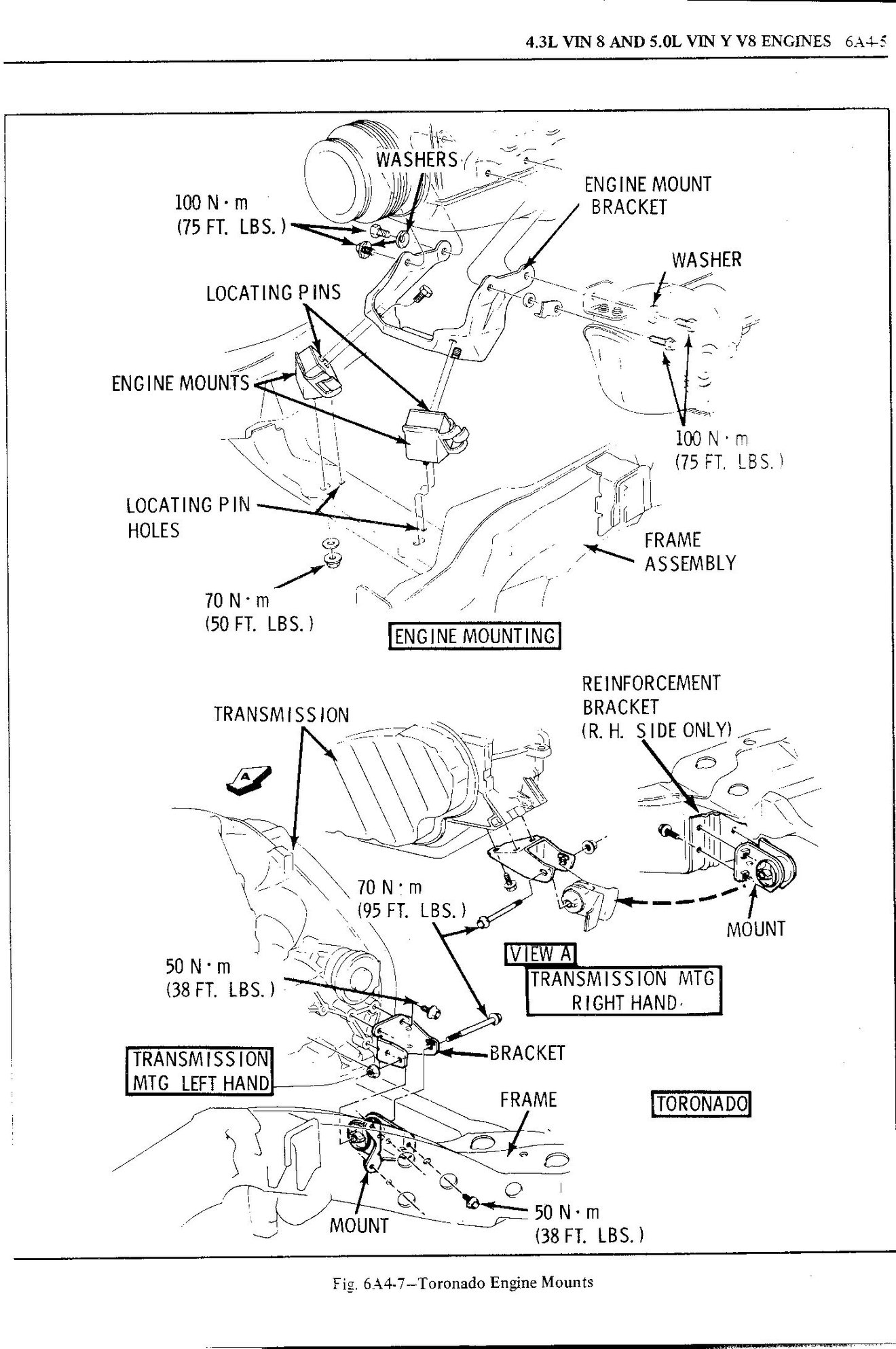

Is there a difference in motor mounts ? I have a 1984 Oldsmobile Toronado with a 350 and a automatic trans. Is there a left and right.
Old Oct 14, 2021 | 02:46 PM
The 1984 Toro uses the same mounts on both sides at the front. Anchor P/N 2629 or equivalent. They are all imported, so quality is about the same unless you can find vintage N.O.S. parts.
