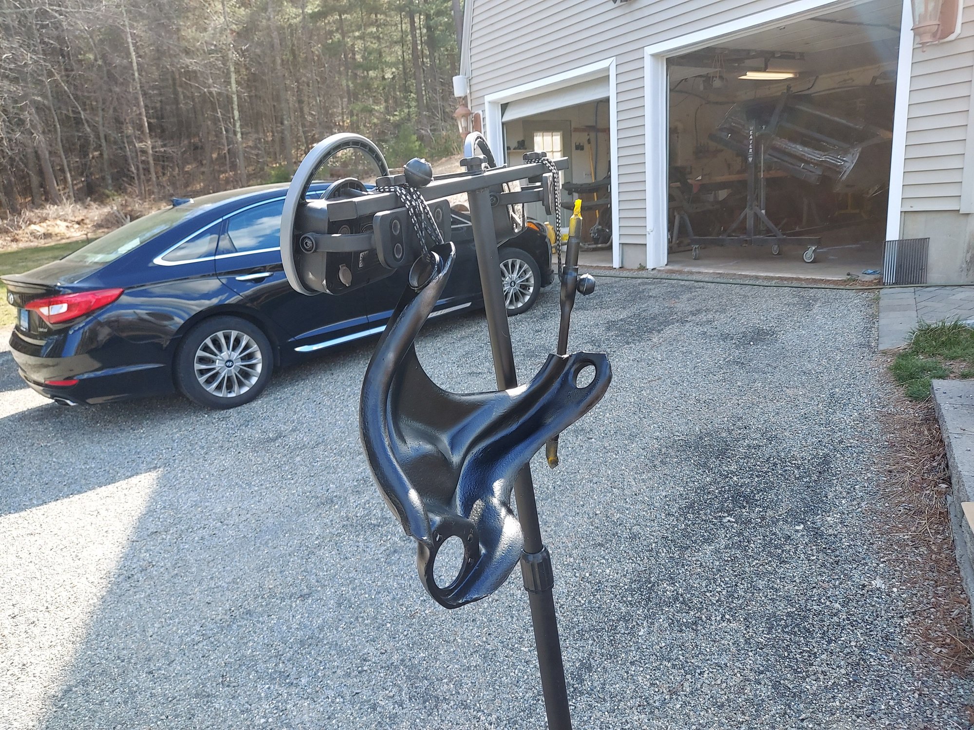

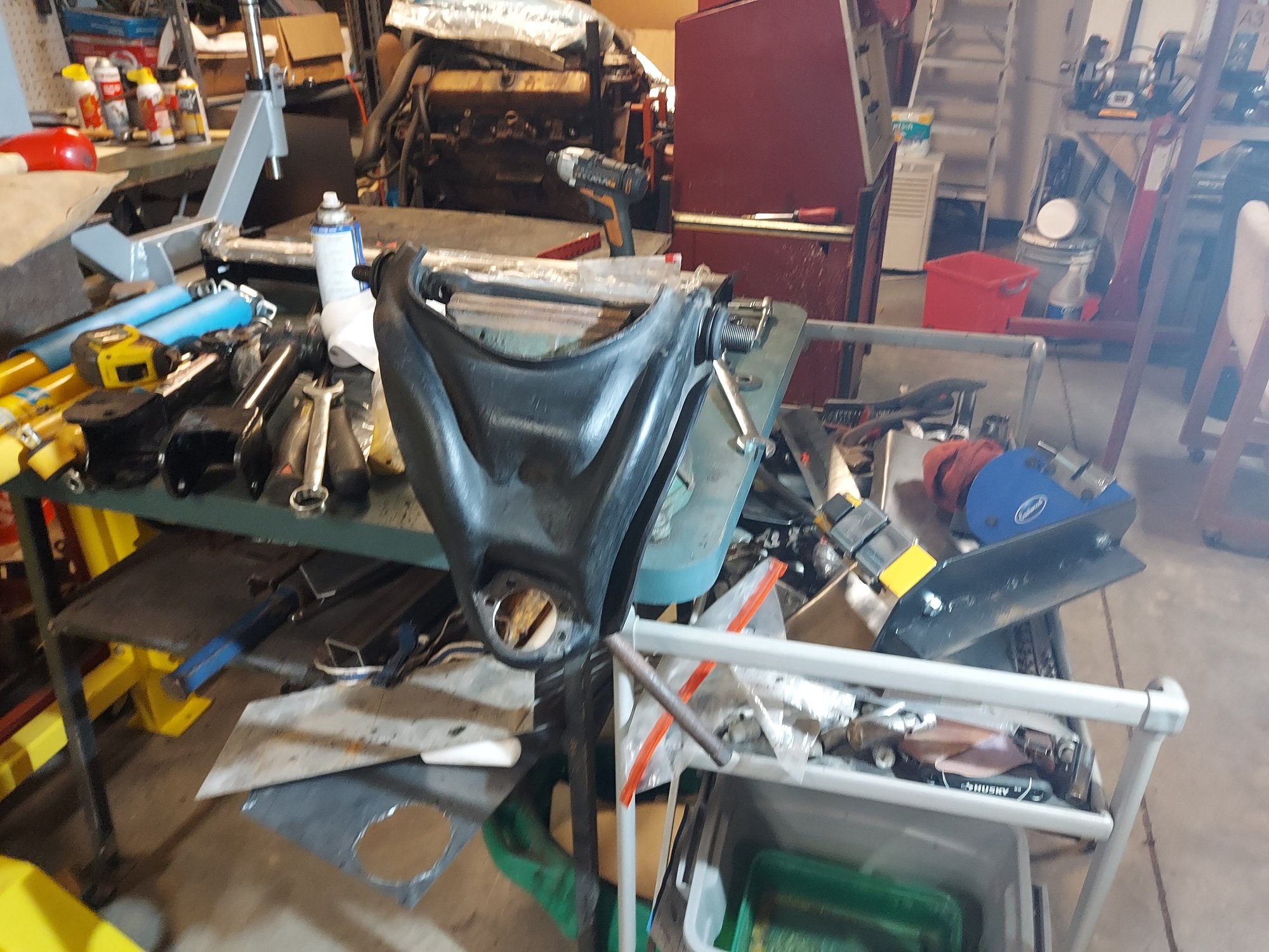

I started taking apart the control arms that I picked up last week, pulled the new ball joint, and proceeded to take the nut off to remove the bushings.
The rubber looks good and is not dry rotted I was planning on blasting and putting new bushings in.
As the title says "Might as well or extra work"? Thoughts?

I'm the poster child for MAWs. Having said that, the photos don't really look bad, and the UCAs are relatively lightly loaded. How do the bushings look at the inboard edges? If you can see cracks in the rubber, replace them now.
Oh, nice engine run stand.

Went with the MAW now getting ready to reassemble.
I tried to mark the original orientation of the shaft, the best I can tell it's symmetrical and it doesn't matter how the shaft is oriented.
CSM and assembly did not seem to indicate either.

The shaft is symmetric. Orientation doesn't matter. When it does, GM either marks the parts (RH/LH) or incorporates a feature so it only goes one way.
