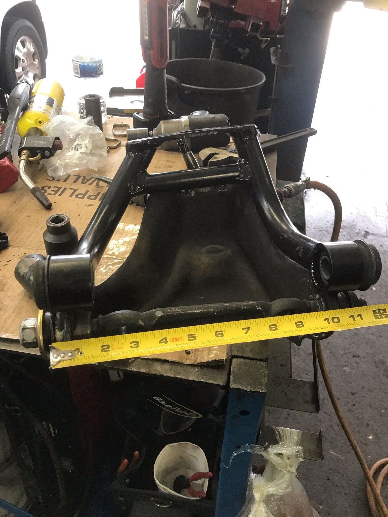

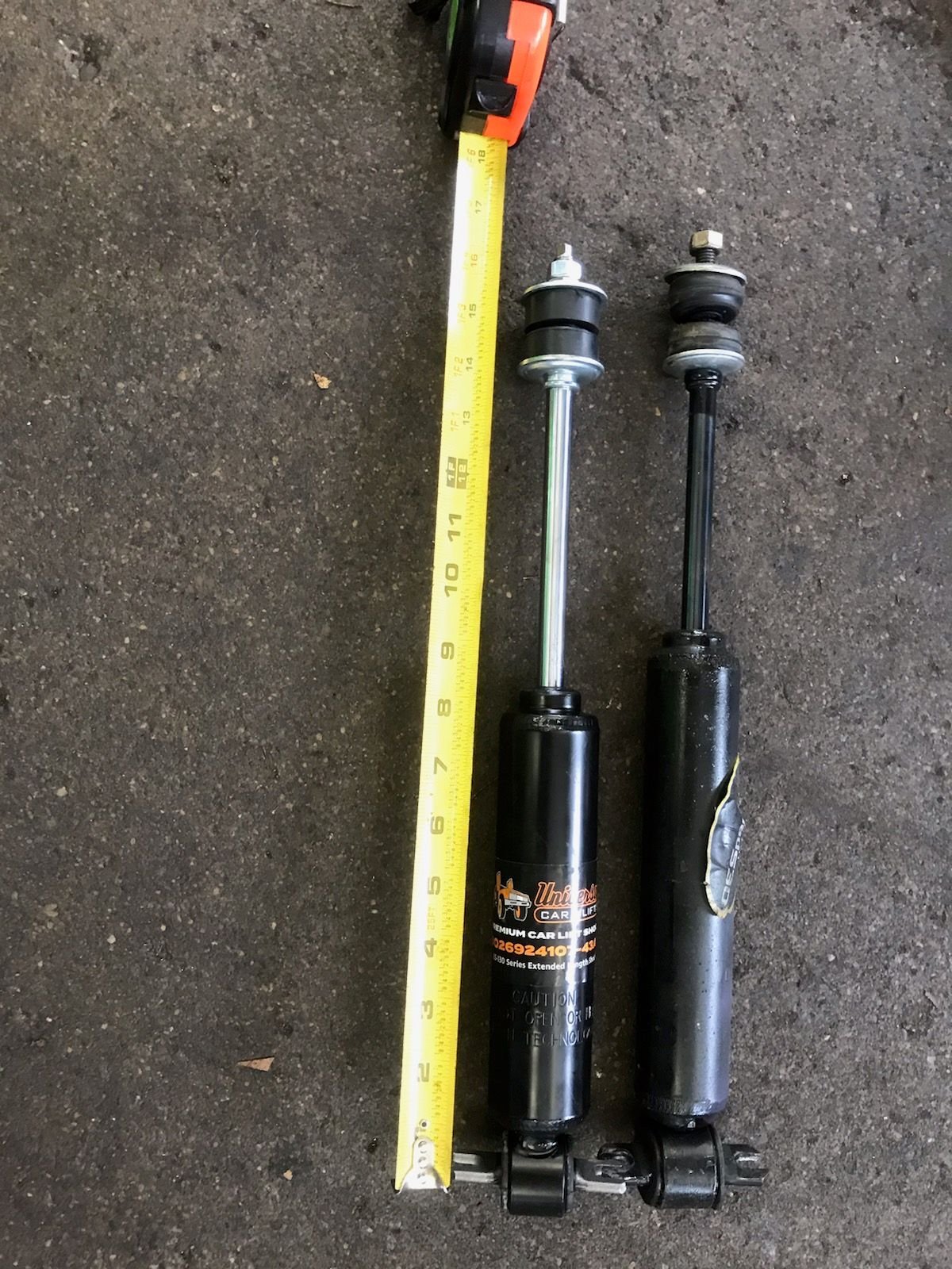

UPDATE: Learn from my mistake; never use UniversalCarLifts.
The A arms are too narrow and wouldn't fit, the "extended shocks" are shorter than OEM (and too fat so they won't go through the lower control arm), and the lift cups that are supposed to achieve 3-5" of lift got me maybe 2". Of course they won't take the control arms back because I had the bushings installed, so im out $400 just for those. They'll take the shocks back, after I pay shipping and a 35% restocking fee. Customer service is absolute ***** and so are their products. Should've just saved my money and gone full straight axle.
