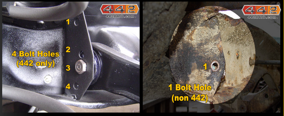

CroixDad this may help.
Comes from a dealer that sold a roller 1965 Fremont 442 that of course has no 4V code. This is how they determined it to be the real deal.
"The 4 mounting holes are present. The frames "ARE" different... A true 442 has 4 holes where the rear-end upper control arm bolts to the frame (note: 10 bolt rears are in the 3rd hole from the top, 12 bolts are in the 2nd), the non 442 has only 1 hole. This can't be counter fitted without cutting and welding connecting points to the frame or trying to accurately drill the other holes."
https://www.classicautomall.com/vehi...bile-442-coupe
Hopefully members here can verify this ...

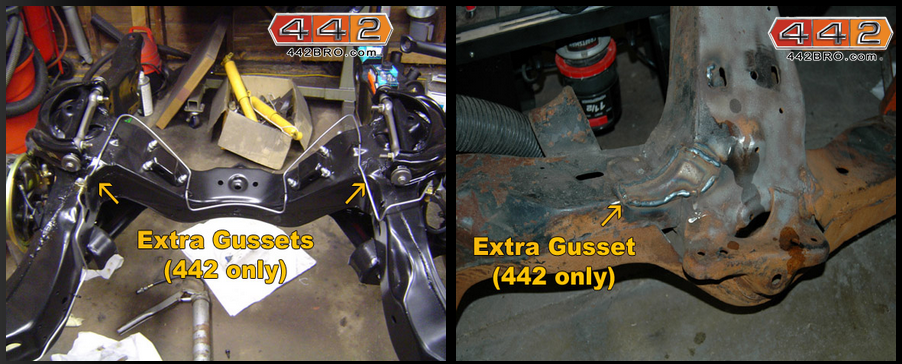

Here is the info directly from Oldsmobile, and as usual it's conflicting. The SPECS booklet says that 3.08 was the base axle ratio with AT in the Cutlass models (it does not break out the 442 option separately).
The special 442 brochure on the other hand shows 3.23 as the lowest numerical ratio with the 442 option and AT.
Of course this is a Fremont car, so the 4V code won't be on the cowl tag. For 1965 cars the frame is probably a more reliable indicator. It's too bad the original trans is missing as the HD Jetaway used in the 442 carried an "MK" code.

65 only frame ?
Hey Joe, this is [only] for the 65 442 as you said correct ? My frame on the 66 442 is not like this where the trailing arm is attached...
Yes, 1965.
My 67 has 2 holes. The FSM says they are chosen by transmission type, auto or manual.
The upper control arm angle affects the instant center and how it reacts from a dig.

Originally Posted by CroixDad
Okay, Joe, another question. I have a 3.08 in my 65 Olds Cutlass/442 and was told it CANNOT be a 442. Can you clarify one way or the other?
That was the whole point of Post #7. Again, check the frame. That will tell you one way or another.

Unless it was re framed. Saying the rear gear or frame proves or disproves it’s a legit 442 is just not true.
Old Dec 14, 2023 | 09:25 AM
And the rear axle could have been swapped also. Things can be restamped. At some point there is no reality.
