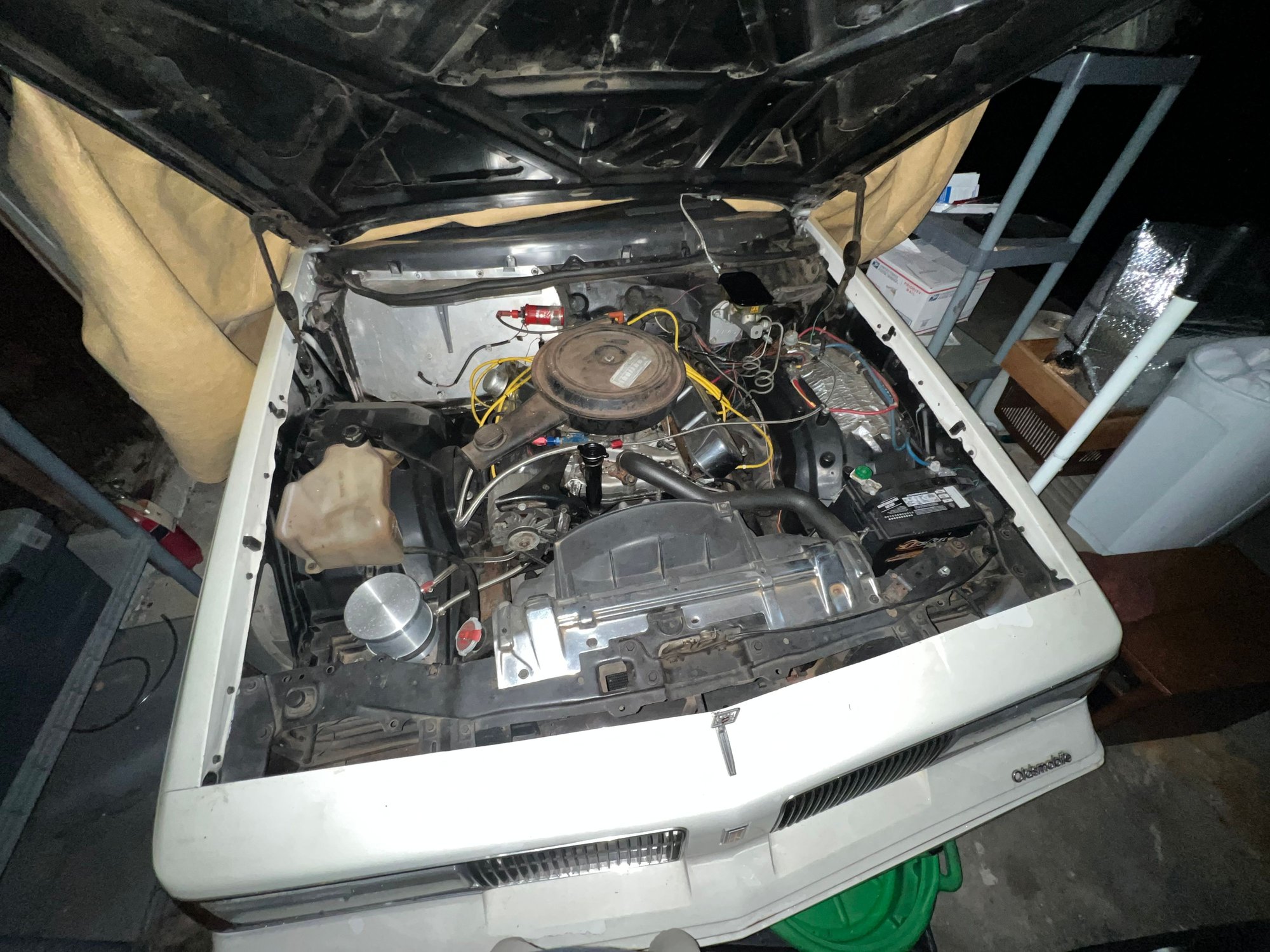

hello all!
im trying to find some information on a vehicle that was given to my uncle. hes trying to sell the car now but we dont know much about it and how much it might be worth. its a 1988 Oldsmobile 442 Factory Drag car. lettered and everything. there is no VIN on the dash and 0 miles on the odo but i was able to find what looks to be its VIN on a label in the trunk.
1G3AR47VXEM330635 is what is on the label but there is no title for the car. it also says on the same label "ENGR. CAR #44327" not sure what that means
any and all help is much appreciated

How about some photographs?
Sticker on the underside of the trunk
these are the only photos i have right now. Just took them quick last night

Sorry, I meant "engineering number". I see that now on the SPID in the trunk. I've never seen that before, but that callout is on the sticker with the 1984 VIN. You wouldn't happen to be in or near Lansing, would you?
The trunk sticker confirms the LT6 V6 diesel engine. I wonder if this is really an 84 diesel car that got converted to a race car and had a later model front end stuck on. Either that or the trunk lid is from a different car. MW9 is the 200-4R trans behind that diesel V6. D55 is console and A51 is bucket seats. That would have definitely been a strangely-optioned car. A/C also (C60). Looks like the trunk lid anyway was on a car intended for CAFE mileage testing.

I think the trunk being swapped with the car from that VIN is more likely. The biggest thing that makes me think this is an original race car is the missing protecto plate (and it looks like one was never installed rather than removed) and the odo not showing any miles.

The odo not showing any miles can also mean the speedo or dash were replaced and/or the cable not hooked up. The trunk lid was apparently metallic grey under the white. Any evidence of that elsewhere on the car?
