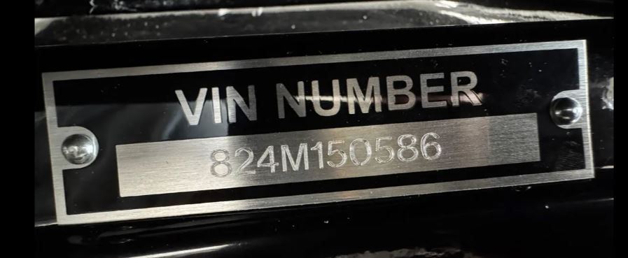

Interesting VIN Tag
Old Mar 18, 2026 | 11:03 AM
F-85 4-4-2's Avatar
Posts: 941
From: Hinckley, Ohio
Interesting VIN Tag
1964 Oldsmobile Cutlass 442 Hardtop Morgantown, Pennsylvania - Hemmings
Old Mar 18, 2026 | 12:05 PM
GN1220's Avatar
Joined: May 2020
Posts: 664
From: Kansas City, MO
Ahh, the infamous Vehicle Identification Number number

Somebody made that tag for sure. It's not a state issued tag without the state identification.
Old Mar 18, 2026 | 05:53 PM
66_Jetstar's Avatar
Joined: Aug 2020
Posts: 824
10 digits, maybe an import or recovered car?
Old Mar 18, 2026 | 06:05 PM
66-3X2 442's Avatar
Posts: 5,193
From: Birmingham,Alabama
That's all GM used in that year, not 13 like the later years.
Old Mar 18, 2026 | 06:08 PM
Posts: 50,802
Ten characters is all GM used on the 1964-earlier cars. In any case, this is not a factory VIN tag.
Old Mar 20, 2026 | 06:56 PM
Bigmikey65's Avatar
Joined: Jan 2020
Posts: 790
Which means it’s been tampered with and therefore illegal. It would be an eventful day if you got pulled over and the police saw that.
I'd be more worried about transferring the title to another state. Any inspector worth his salt would raise a red flag.
FWIW, the selling dealer says "The car is titled in PA and we have a copy of the title and it does show that the car has a reissued VIN."

So, a doctored vin tag and a build date of 02C-3rd Week February ...

It’s a replacement vin. I’m sure there’s paperwork documentation for it.
The state issues these. Car is inspected. Ownership is verified. Title is verified. And a new vin tag applied to the car BY the state inspection agent.

If PA re-issues a vin then it means the car was wrecked or salvaged. The state has a rigorous process to certify the car.
Probably not the end of the world when buying the car, but likely a deal breaker for most potential future buyers when you go to sell it..

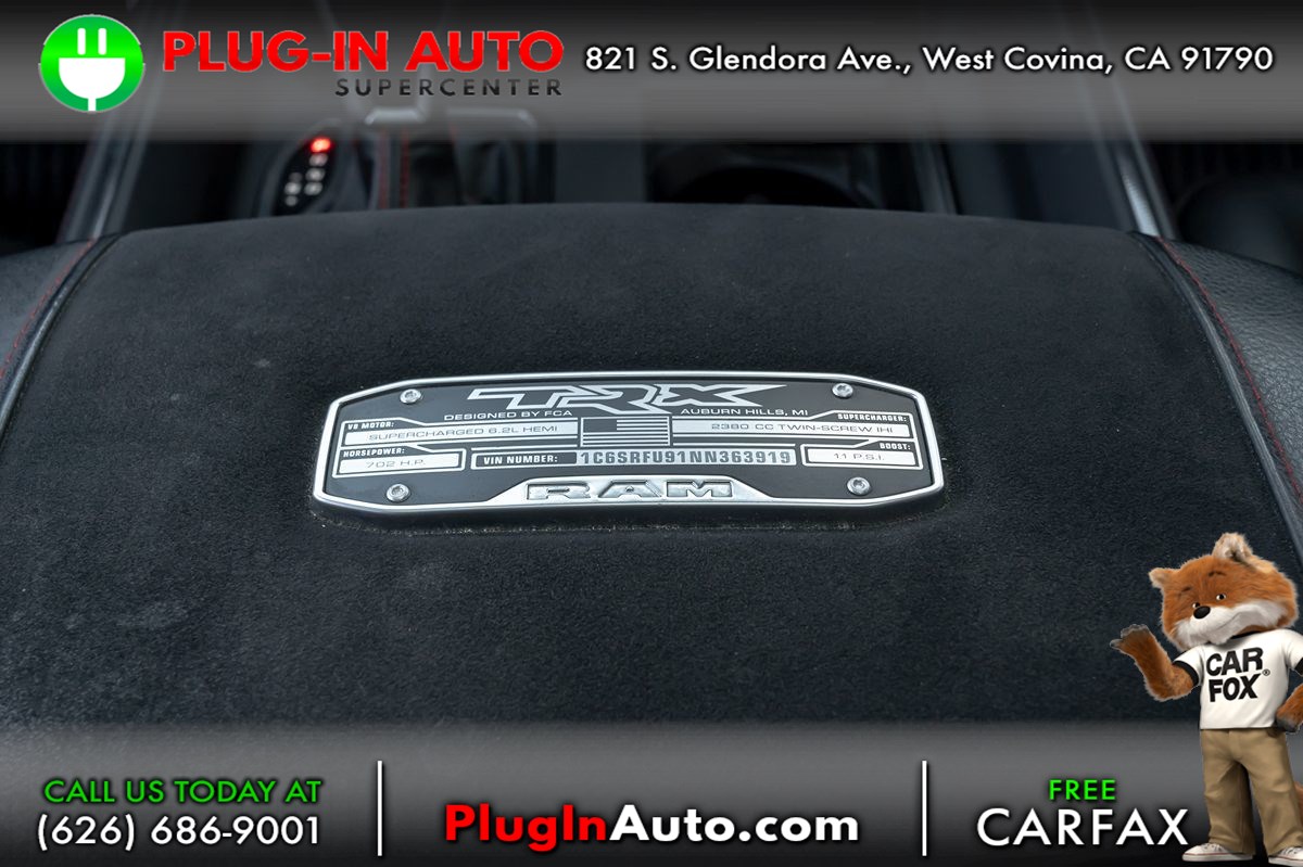

They must have gotten the tag from Dodge: (and yes, that is factory)
Image #19
Even the factory now says Vehicle Identification Number number?

But is it a real 442 ...
This thread has some great production info on the 1964 442s. Note that the earliest documented production date is first week of March 1964 (03A date code on the cowl tag).

No it’s not. The build date predates 442 production.
