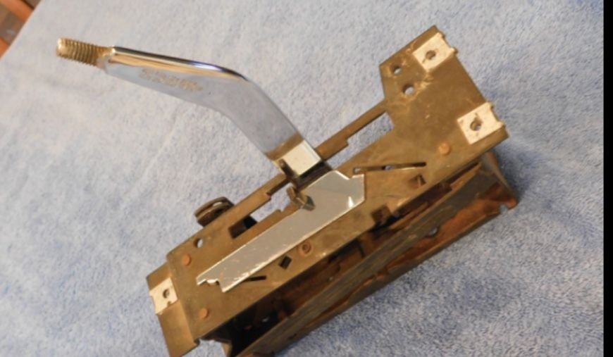

Sheltering in place provides for much garage time, and I have never liked my pitted chrome sliding dual gate shifter ‘cover’. Any ideas as to where to find a replacement - the rest of my set up looks really good. Not sure of the part name but here is a photo, not mine
Thanks in advance to all.

https://www.ebay.com/itm/HURST-Dual-...T/282250557431

That’s it, thanks tru!

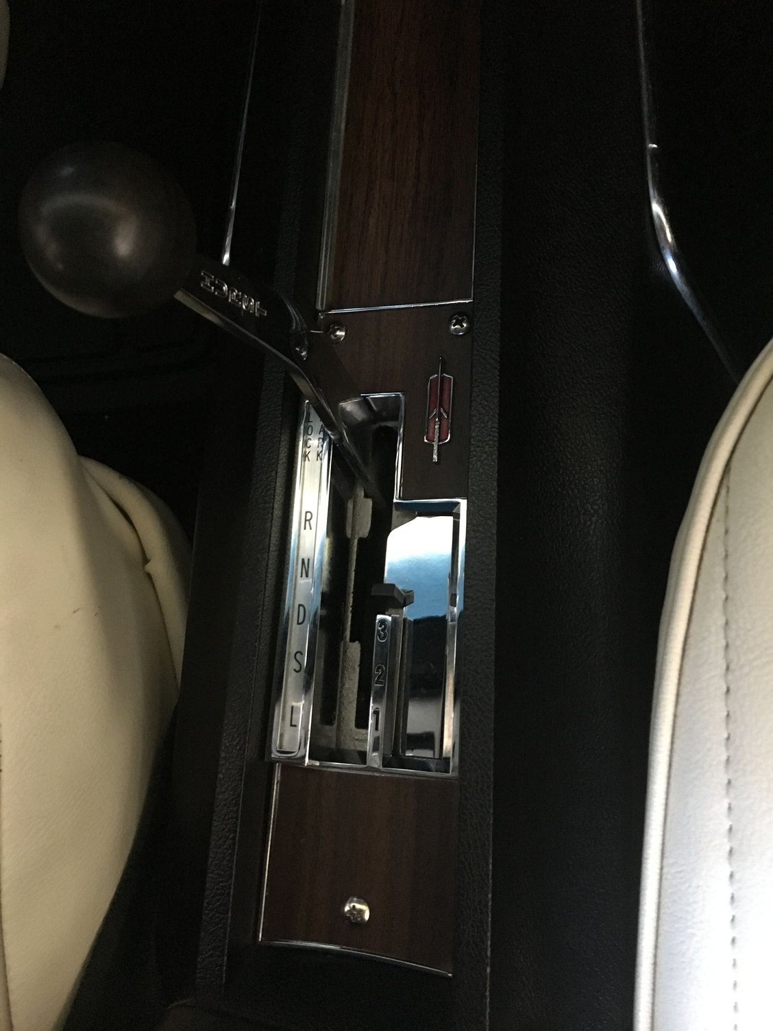

Look forward to seeing yours when it’s done tru. Got my part today and already installed, looking pretty good. Thanks again for the source, Dr. shifter is the man.

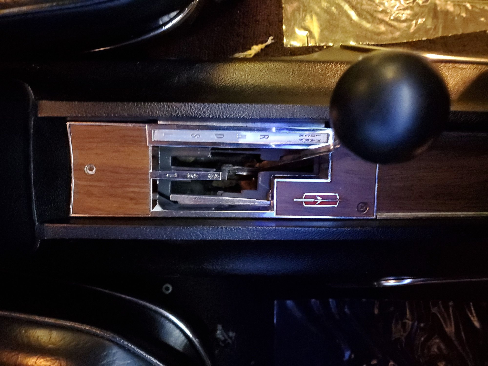

72 V code. here you are. I need to get a new burlwood insert for the top plate and console after I cut it.

Love the T handle tru, looks great. Fun I spent 16 bucks plus 4 shipping on the chrome slider described as having “imperfections” which it really doesn’t. I emailed the seller and he said 15 of the thousand on hand had a small barely visible flaw, which to me was worth half price - and it looks perfect to me.
The best part was installation I didn’t have to take apart the console, maybe you guys know this but I thought I’d have to - I was able to fish out the spring without detaching it from it mount and hook it to the new slider from the top 👍
And Koda, every Hurst dual gate equipped 442 I’ve seen from 1970 to 72 originally had the chrome dust slider.
