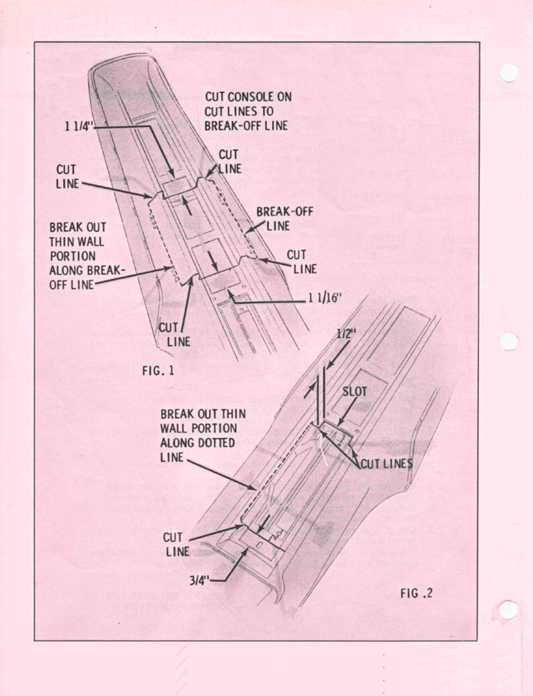

The underside of the console has molded in lines where it is to be cut to open the hole for the shifter. If you use some type of saw or cutoff wheel, use a slow cutting speed as the plastic will melt with a fast blade speed.

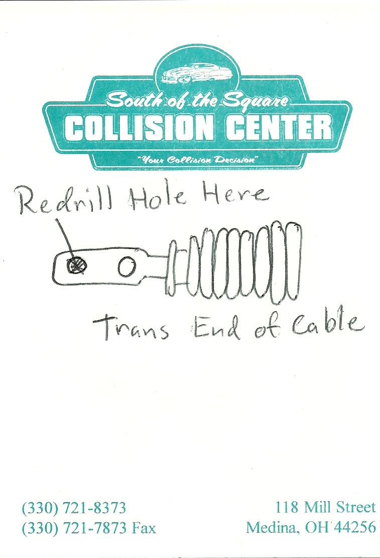

Like 4speed455 said, If your car still has all it's back-drive parts & they work you can leave your your column mounted neutral safety/reverse switch right where it is & it will work just fine. The lever on the trans & the bracket that holds the cable to the trans are the same on either shifter. I did the dual-gate conversion on my buddy's '70 W31 a couple of years ago it works great. We left the factory switch on the steering column. One thing I did find & others have had the same problem, is getting enough adjustment on the shift cable (it'll go into park but it wont go in low or vise-versa) After some trial & error I found that redrilling hole in the repop shift cable closer to the end took care of it. Hope this helps
