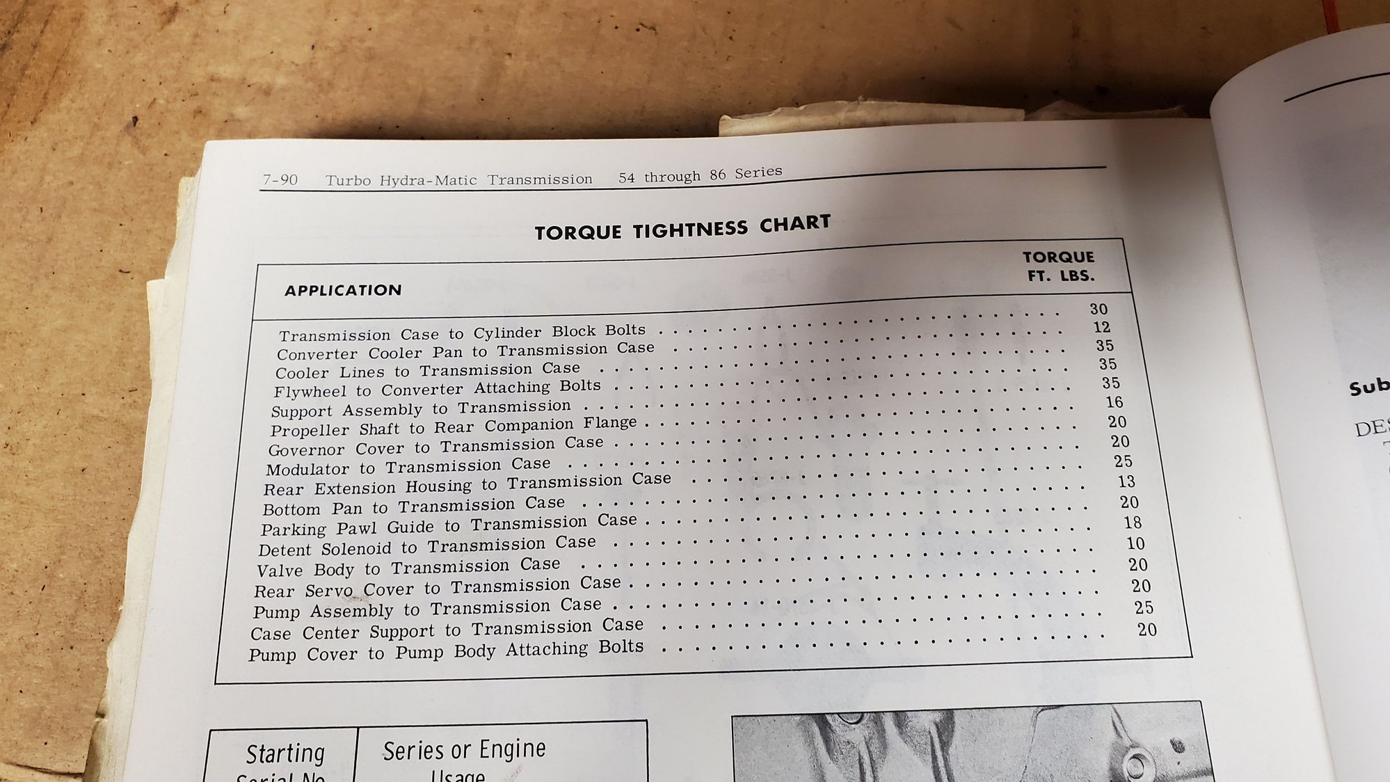

The closest thing I see in the FSM is for the TH: "case center support to transmission case......25"
You're right; it's not listed- very strange

Page 7-78 in the 1968 CSM. Support assembly to transmission - 35 ft lbs.
