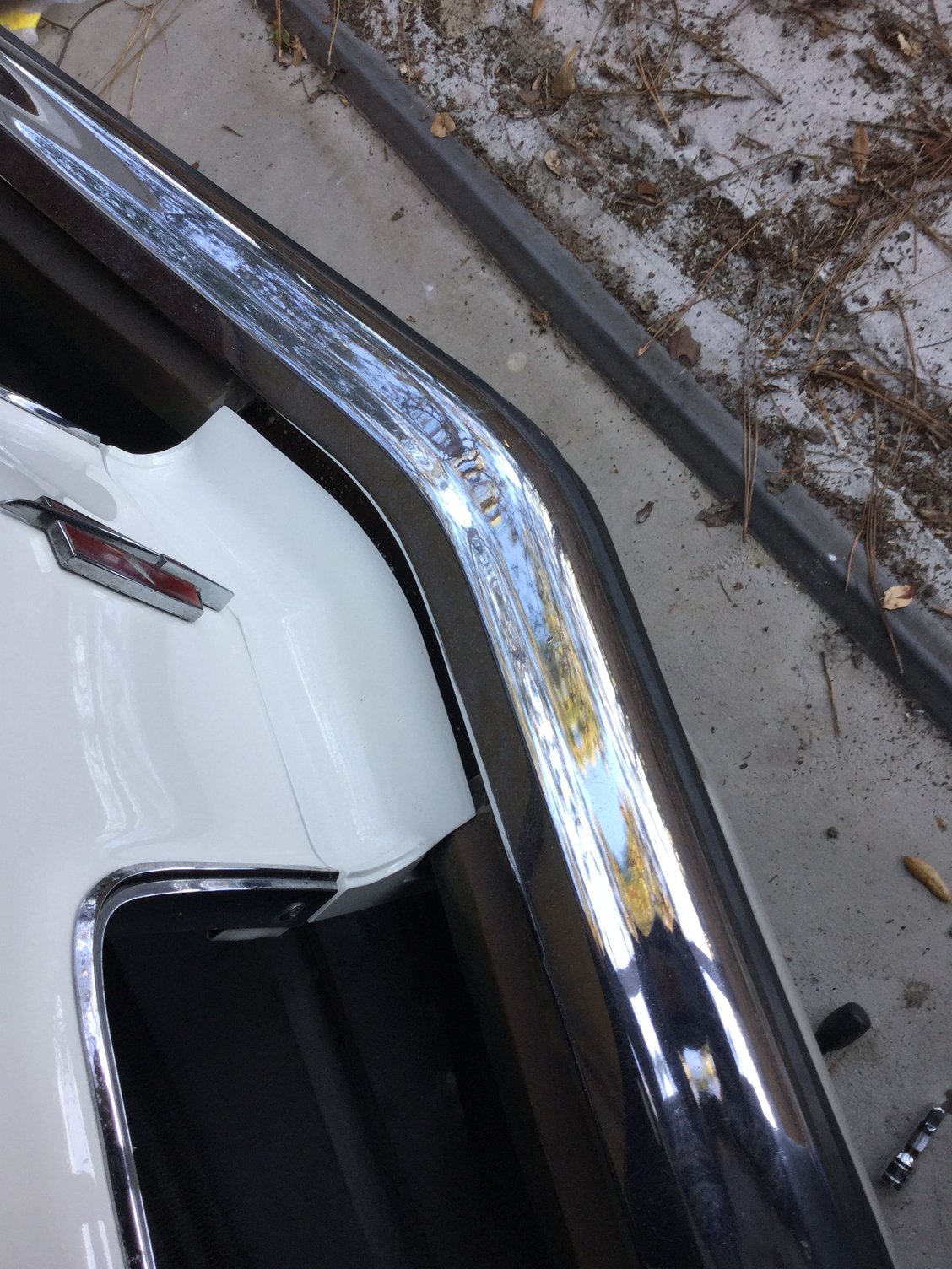

I have installed my front bumper on my 74 but cannot seem to get it to go back far enough for fillers to fit properly , are there adjustments that I might be missing . Thanks

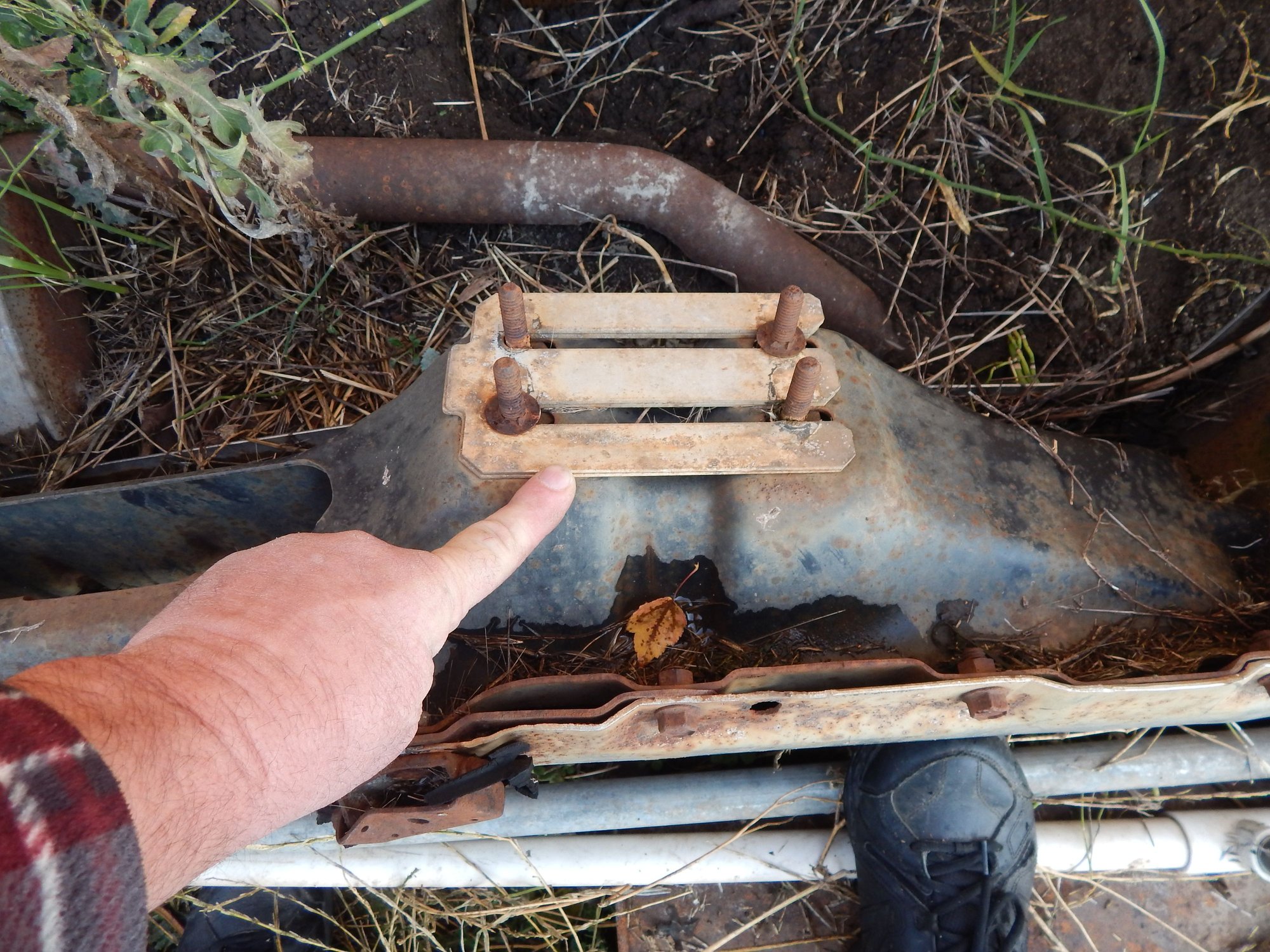

I've seen these spacers on bumpers of that vintage. Are there any on your car you could remove? They fit between the shock and the bumper support.
John
