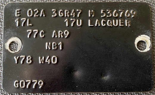

I have enclosed a document outlining all the codes and their related information for my car. I am unsure about one code, NB1. Would anyone have any information on this code's meaning?
Thanks

GM Production Options, Published in 1991 (so its from the era) says NB1 is "Emission System, Closed Loop".
(For reference, NB2 is "Emission System, California, Tier 0")

This being a Canadian car maybe we had stricter emissions... who knows. Thanks for the help

The GR47 on the tag signifies Cutlass Supreme 2-door notchback. I know it sounds counter-intuitive, but hang on...
The Y78 (Calais) RPO option changes a whole lot of things for the car, especially changing the "AR" in the VIN to "AK". This has nothing to do with the body tag.
NA5 is basically North America emissions stuff, with the exception of those quirky folks in California. So the emission equipment used in Canada should be the same as 49 states in the U.S. Note too that 17U and 17L is used, where black was actually the lower color. It's because at the time, the W40 RPO included painting the lower body in gloss black, on top of the all silver car. There is NO documentation calling for lower black paint, even in the trunk SPID RPOs. The wheels/tires, air shocks, reinforced hood, lower black paint and all the decal striping was done at Lansing assembly. C&C (Hurst) just added the shifter, scoop and center hood trim, spoiler, and front air dam. Can't recall exactly if the H/O bullnose emblem and dash emblem was put on at the factory or at C&C. I think it was at C&C. To note, NA5 is usually coupled with NB1, which basically says you're using a closed loop emission control system with an ECM that meets federal standards, which meets Canadian standards as well.

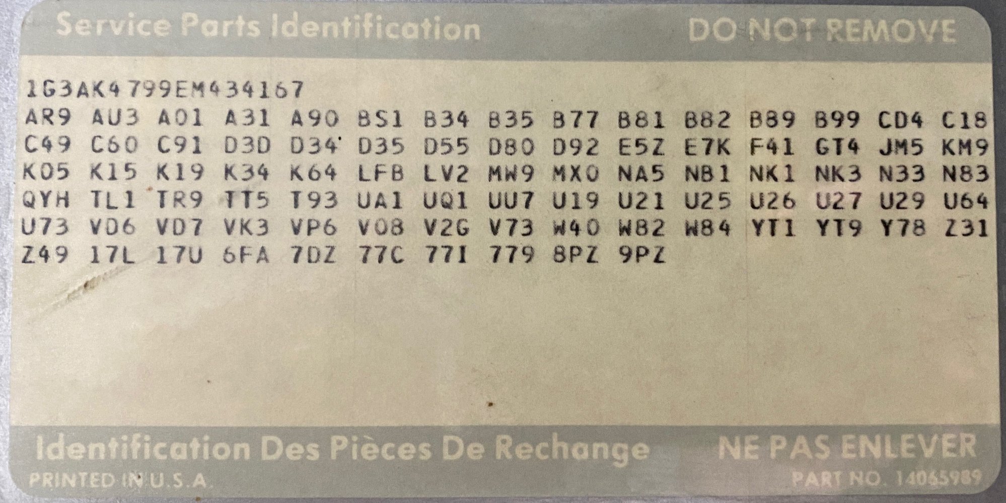

More importantly, the SPID sticker inside the trunklid would have ALL the good RPOs on it. Got a picture of that? That would tell us lots more. Open trunk lid. Look to the left. Should have your VIN and all the pertinent RPOs that were on the car when new.

Thanks for all the helpful information. I’ve spent the last couple of days searching online for all the RPO codes associated with my car, and below is my spreadsheet along with a picture of the RPO sticker. As a side note, GM's "8" and "B" look very similar, so I had to use a magnifying glass to double-check. The X marks on the Excel spreadsheet indicate where I’m not 100% certain I have the correct information, so if anyone can help fill in the blanks, that would be great.

Here are some.
https://decoderpo.com/
AR9 AU3 A01 A31 A90 BS1 B34 B35 B77 B81 B82 B89 B99 CD4 C18 C49 C60 C91 D30 D34 D35 D55 D80 D92 E5Z E7K F41 GT4 JM5 KM9 K05 K15 K19 K34 K64 LFB LV2 MW9 MXO NA5 NB1 NK1 NK3 N33 N83 QYH TL1 TR9 TT5 T93 UAI UQ1 UU7 U19 U21 U25 U26 U27 U29 U64 U73 VD6 VD7 VK3 VP6 V08 V2G V73 W40 W82 W84 YT1 YT9 Y78 Z31 Z49 17L 17U 6FA 7DZ 77C 771 779 8PZ 9PZ

Wow. That decoder is FUBAR. I can tell you right now, one glance at all that and I can say QYH is the tires, 215/65R-15. Goodyear Eagle GTs. 8 and 9PZ are the rear spring codes. PZ is predominately used on the back of H/Os and 442s back in those days, although other codes have been used.
I can break it all down for you. And can even make a window sticker from that SPID.

So, not every option is going to make sense, and it doesn't have to. The main point these are used for today is to show factory provenance of rare options and packages. If you got those, you are good.

Would you have a sample picture of the window sticker as that may be something I am interested in? Thanks

Errrw.....Canadian car. Yikes. A bit more troublesome to decode. I don't have all the codes for those. There's two codes I cannot locate, E7K and VP6. Not for 1984 standards. The RPO codes can and DO change sometimes over the years, so what worked one year, may be something completely different on another year vehicle.
AR9- Front reclining bucket seats
AU3- Power door locks
A01- Tinted windshield and all other windows
A31- Power side windows
A90- Rear trunk lid release, electric
BS1- Build up interior door panels, custom
B34- Front floor mats, carpet
B35- Rear floor mats, carpet
B77- Black lower W/S trim piece
B81- External body ornamentation delete
B82-
Exterior emblem delete
B89- Half black front and rear glass window trim
B99- Wheel opening molding delete
CD4- Delay wiper system
C18- Wipers, black
C49- Rear defogger, electric
C60- Air Conditioning
C91- Lamp, dome courtesy
D3D- Speedo gear, 30 tooth.
D34- Visor vanity mirror, pass.
D35- Outside rearview mirrors, sport, color coordinated
D55- Console, floor shift
D80- W40, Extension, rear panel. (Whatever that is. I've never figured that out)
D92- Door handle decor, W40/W48
E5Z- Speedo adapter delete
E7K- No information found
F41- Sport handling package, front HD sway bar and rear sway bar
GT4- 3.73 rear gear
JM5- Booster, brake. Dual diaphragm
KM9- Aluminum intake manifold
K05- Engine block heater
K15- Return line, fuel vapor
K19- A.I.R. pump system
K34- Electronic Cruise Control
K64- Alternator, 78A
LFB- Lansing Fisher Body- Process Option
LV2- 307 V8, 180 HP
MW9- TH200-4R auto transmission with O/D
MXO- Marketing code for MW9
NA5- Emissions, Federal equipment
NB1- Emissions, closed loop
NK1- 16 gallon fuel tank
NK3- Partial leather-wrapped sport steering wheel
N33- tilt steering wheel
N83- 15x7 chrome SSIII wheels, red perimeter stripe and argent inlay (note, these wheels were clearcoated in 83-84 only)
QYH- (Goodyear Eagle GT 215/65R-15) OWL tires
TL1- Blacked out/chrome grilles (H/O only)
TR9- Lamp package, includes U25/26/27/29, and passenger mirror lamps
TT5- Halogen high beams
T93- Tail light assemblies, black trim
UA1- HD battery
UQ1- Provisions, stereo radio
UU7- AM/FM with Cassette
U19- KM/Hr speedo
U21- Rallye Pack gages.
U25- Lamp package, trunk
U26- Lamp package, engine compt.
U27- Lamp package, glove box
U29- Lamp package, footwells
U64- Speaker system, dual rear
U73- Fixed antenna
VD6- Front bumper reinforcement, aluminum
VD7- Rear bumper reinforcement, aluminum
VK3 - Front License plate holder
VP6- No information found
V08- High capacity cooling
V2G- Credit, Fuel fill
V73- Canada vehicle statement
W40- Hurst/Olds equipment
W82- Extra fuel for delivery (makes sense- had trip to the upfitter, C&C)
W84- Govt. order- export
YT1- Door panel trim and quarter build up
YT9- Fisher installed (whatever this means)
Y78- Calais
Z31- Price sheet- export
Z49- Canada Export base equipment
17L- Silver lower paint
17U- Silver upper paint
6FA- LH front spring
7DZ-RH front spring
77C- Dk. Maple cloth seating
77I- Dk. Maple interior color
779- Dk. Maple Seat Belts
8PZ- LH rear spring
9PZ- RH rear spring
