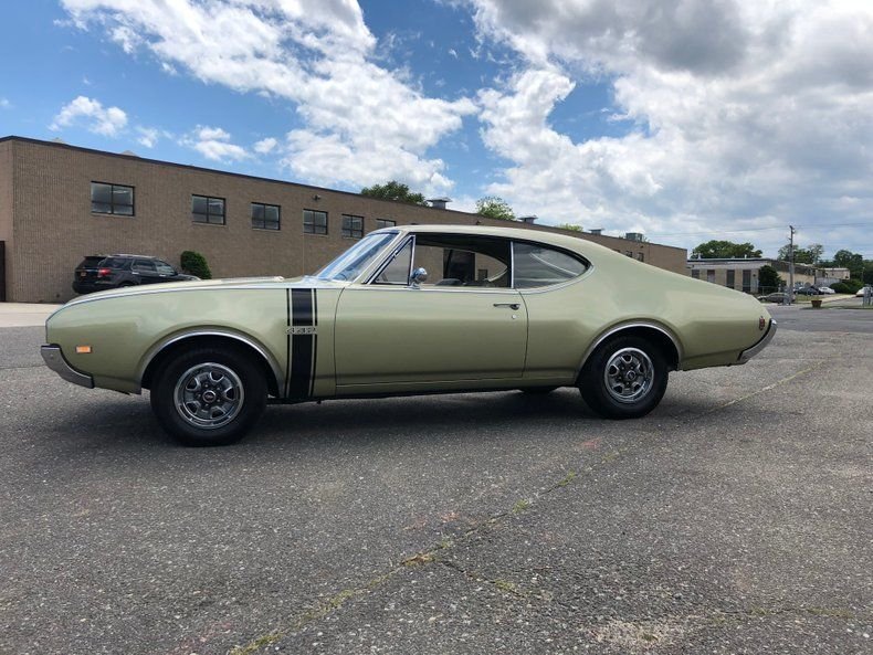

You mean this stripe?
Old Dec 26, 2022 | 01:25 PM
Posts: 50,791
Yeah, I saw that photo. The varying gap between the pinstripe and the chrome suggested to me that is not original. Out of curiosity, how many W36 photos on Google Images did you go through before hitting on that one?

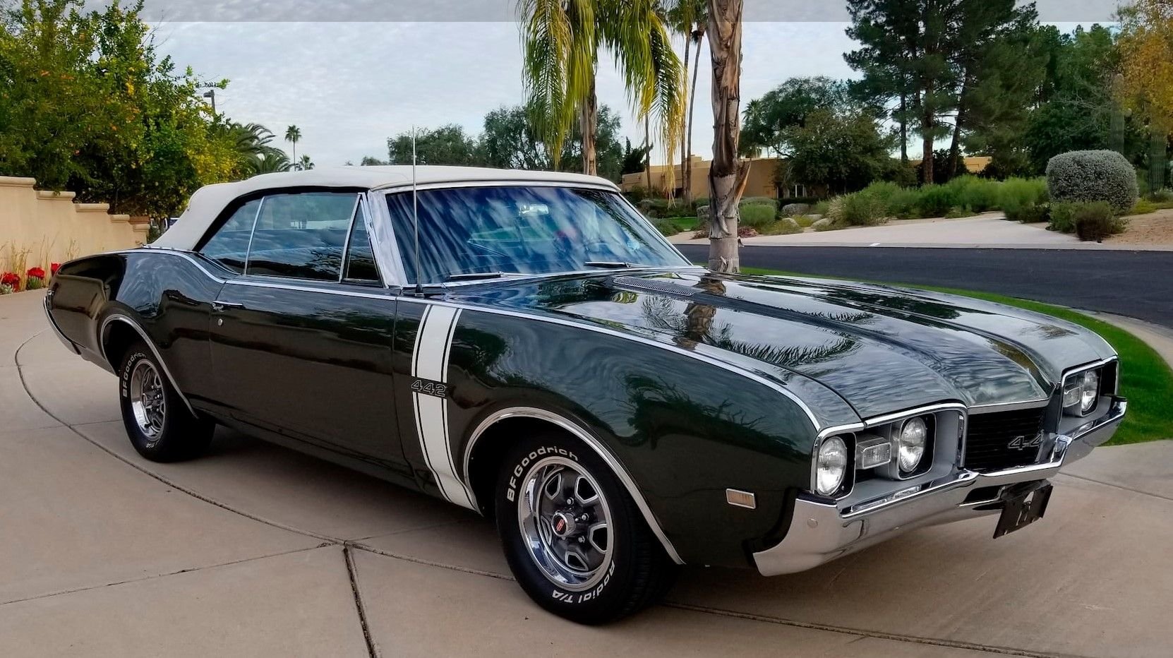

I did an image search on: 1968 442 original paint
And how many faux W36 cars came up in that search?
Like this one:
In any case, the fact that your two photos are very different should tell you something.

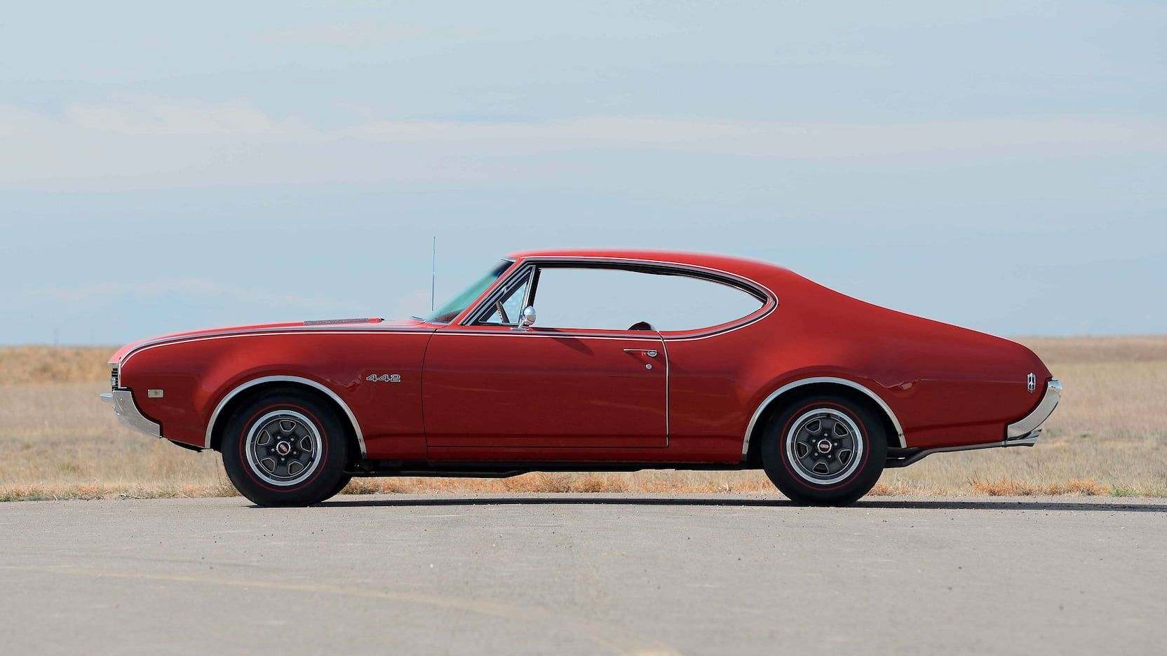

Posts: 50,791
Here's a pretty good application of the Y70 stripe. The car is allegedly unrestored. I have no opinion one way or the other on that, but it does appear to be pretty correct in all aspects.
