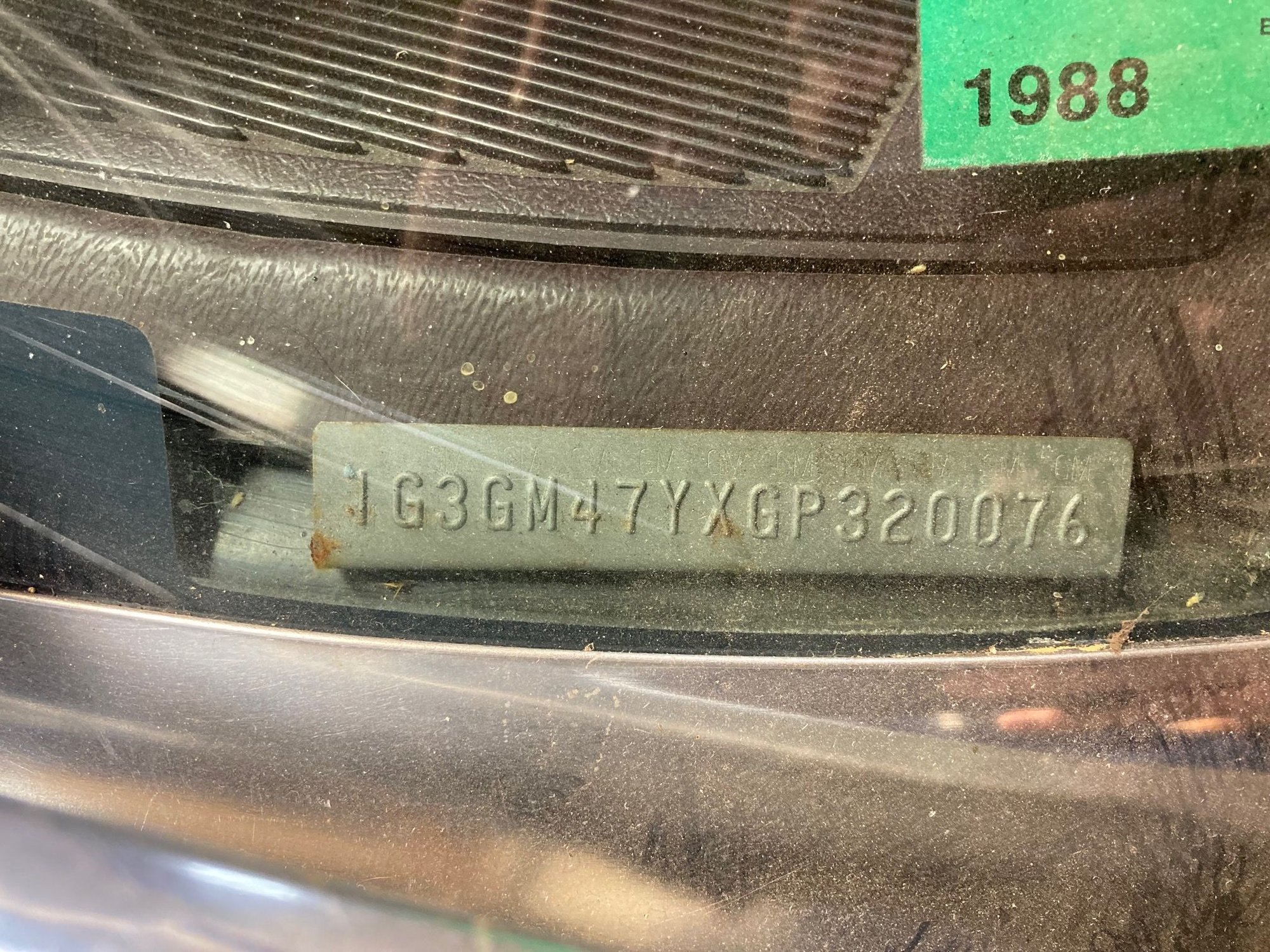

I apologize for the confusion. I understand the cowl tag does not contain the VIN. My main question was concerning the number "42" on the cowl tag, as seen in the picture on the first post.
The question about the Pontiac assembly plant was meant to be a separate question, unrelated to the cowl tag question. I see know how that was confusing for others reading it.
Just for clarity, I have sent a picture of the VIN below. You can see here the 11th character is a "P".

The "P" it is for Pontiac assembly, and the "42" stamp isn't anything associated with the options of the car. In fact, most of the body tags from Pontiac plant on 86 -88 RWD Cutlass I've seen has some sort of rando stamp on them for some reason. Nobody I know of has had a good answer for it.
Appears from your VIN you have a 2-door 86 Cutlass Supreme Brougham with a 307 Y V8 engine.
U.S. 86 Cutlass was built in Arlington, TX, and in Pontiac, MI. Canadian-bult Cutlass cars were built in Ste. Therese.
If this car was built in Canada, it would start with a "2" in the VIN, and the plant code would also be a "2" for Ste. Therese assembly.
G= 1986 model year
10B- target production week (TPW) of 2nd week of October, 1985
3GM47- Olds, Cutlass Supreme Brougham 2-door notchback body style
P- Pontiac, MI assembly plant
030754- Fisher body number. It's on the build sheet somewhere, if you're lucky enough to find one. Seems the Canadians were a lot sloppier not cleaning out the cars than Michigan plants.
15L- Medium Gray Metallic, lacquer
762- Seat material, leather, burgundy
CD4- Pulse (delay) wipers (N33 tilt wheel was mandatory with CD4)
84T- vinyl top color, Medium Gray
The "42"??? Rando stamp, no idea. Jackie Robinson Edition? Nah. Have no idea.
