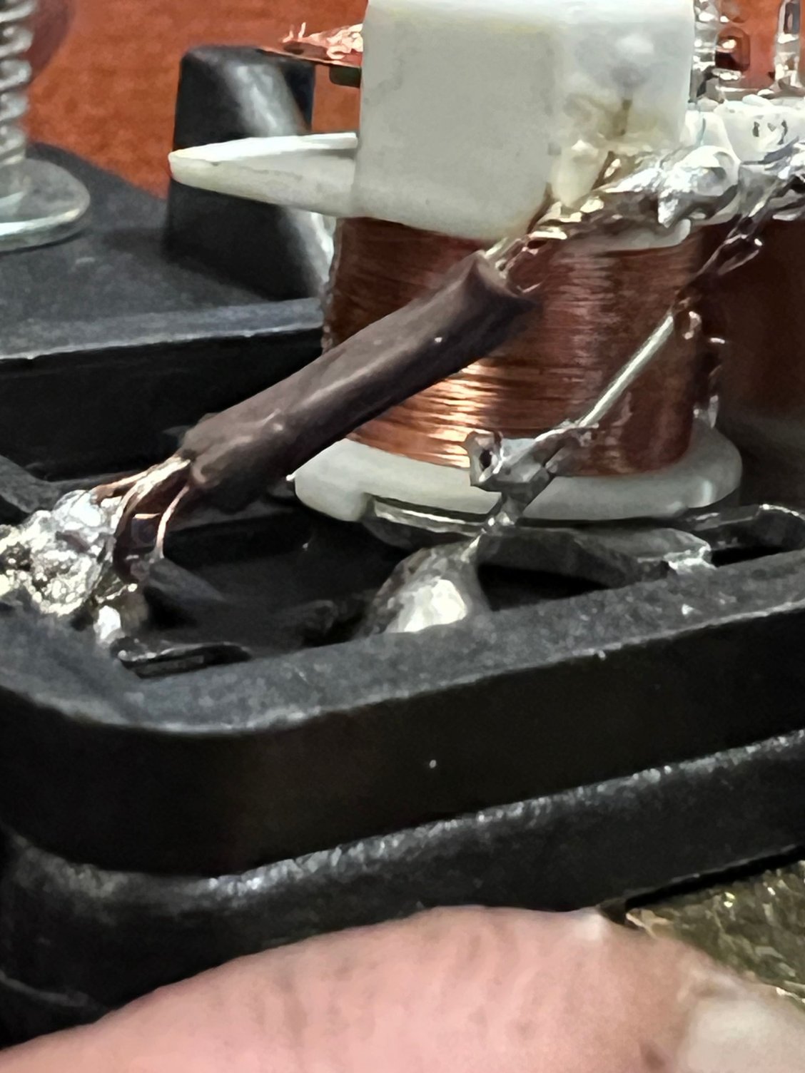

And there you go. Quality parts.
So... question.... I can easily repair this, but with what, exactly? Is there a particular wire I should use? Obviously this one melted as soon as I started honking the horns.
EDIT hahaha - I just can't wait for an answer. I grabbed a 1" piece of copper wire and soldered it in place. Works like a champ.
I definitely got the chinese version of this relay. There are a number of them online that specifically state "Made in USA". This one does not.

Glad I could help. I would probably solder a piece of something like 12 gauge wire across the two ends where it burned into. I just noticed that the solder at the top of the burned section looks to be touching the other connection that did not melt. Make sure that is not because that would be a direct short. This could be the result of Chinese quality.
You would think in my whole house, in which I used tons of 12g and 14g wiring, I would have a scrap somewhere. But no. And the solder you see is a victim of the zoom on the camera lens - there is plenty of room between the posts. I tested over and over with the protective cap off to make sure nothing was overheating or failing before setting the cap back on and connecting the remaining wires. I probably didn't need to replace the horns, but oh, well. They sound great and should for a long time.
