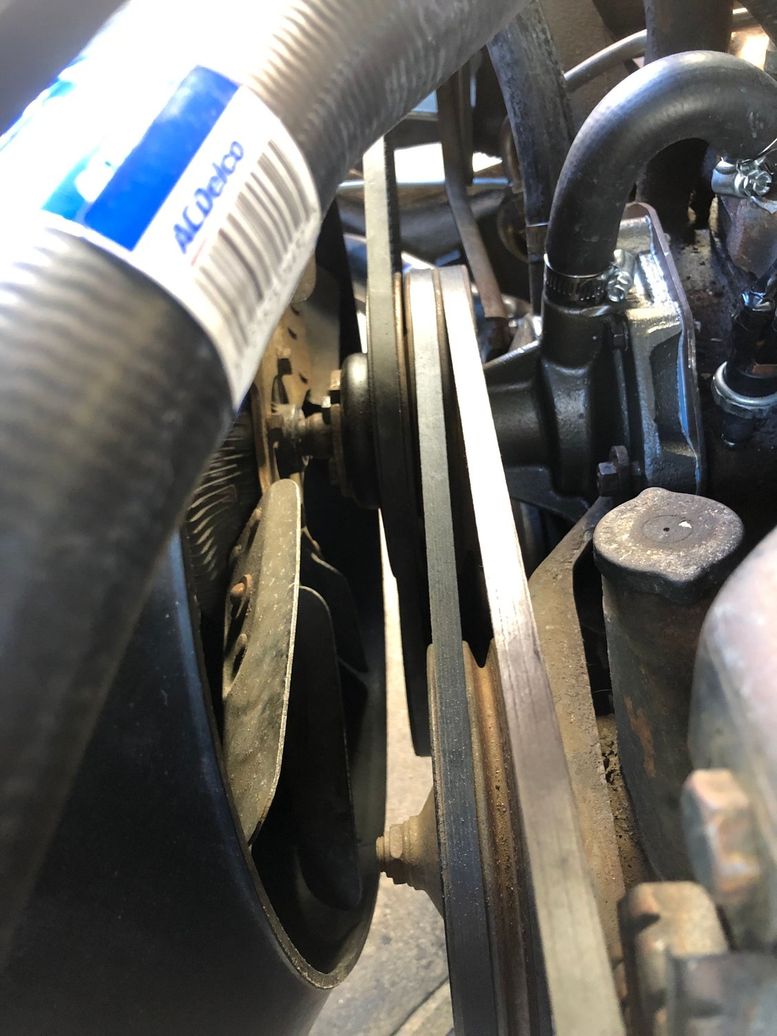

Old Jul 16, 2019 | 08:06 AM
72cutlass408's Avatar
Posts: 456
From: Sunnyvale, Ca

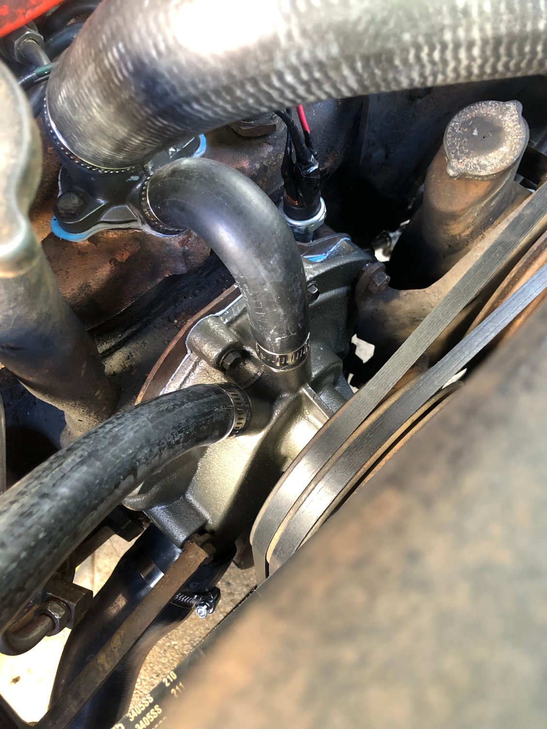

Old Jul 16, 2019 | 08:07 AM
Posts: 456
From: Sunnyvale, Ca
Used the Be Cool #17008 radiator
