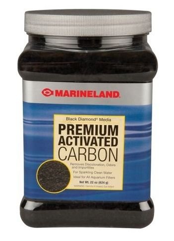

Originally Posted by Gone Johnson
I feel I should just buy more charcoal, fill it, and slap on a new filter. Is this silly thinking?
It is not silly thinking at all. It is exactly what you should do.
What you need is activated carbon. You can get it at a pet store as it is used to absorb odors as well. I'd just buy something like this from Petsmart for $12. I don't know how many of these it would take to fill your canister, but I would be surprised if it's more than two.
https://www.petsmart.com/fish/filter...utm_medium=cpc

Ok. Thanks. Im gonna do this. Makes sense!
