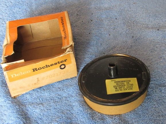

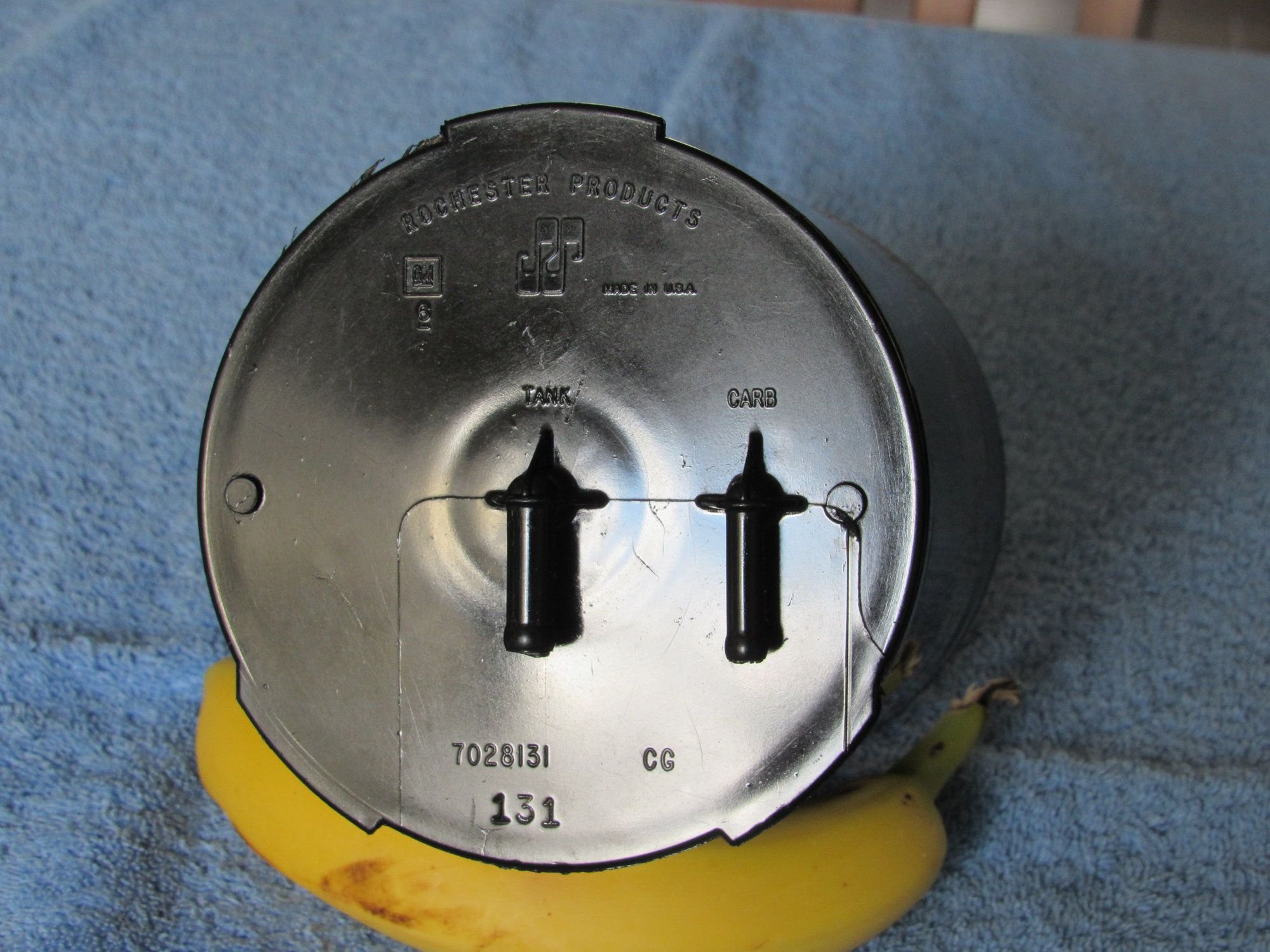

How does one replace the filter in the evap canister on a '72 Supreme? The CSM and the ASM don't go into detail about the procedure. Here are pics of my canister and the replacement filter. From what I can tell, the canister doesn't come apart.
Also, what's the port on the filter used for? That's not shown in the CSM or the ASM either.

First filter like that I've seen. The ones I've used came as filter element only.
The opening in the new piece is the canister's outside air intake. You notice the original's filter is pretty much open to atmosphere.
Pry the fiberglass elements out of both pieces, then work the new filter into the original canister thru the bottom opening. Problem solved.

A quick search online shows the applications for the part you have. A 1972 Supreme is not among them.

So it's the wrong filter?

Does the cap assembly fit into the bottom of the canister? It should just snap in. If that’s the case, just pull the yellow filter out of the canister. Easier than replacing the canister… it should look like this on the bottom:
and from underneath the car, the cone should line up with the hole in the inner fender liner.

Hi Dave - The bottom of my '71 CS canister looks same as your 1st image. I simply remove the canister, turn it upside down (charcoal settles to top), remove the filter from the bottom of canister by pulling out, it's about 1/2" thick (the filter is more or less like a 3M abrasive scratch pad), then insert a new filter. You can buy absorbent pads at any of the big box stores - most are a square shape. Just cut a circle and insert the new absorbent pad in the bottom, turn canister right-side up and done. You could change charcoal as well if you want.
Old Mar 10, 2023 | 06:10 AM
Posts: 25,793
Part # (7028131) of your canister is same as mine ('71 CS). In case yours is noodled up, there's a used one available on eBay.

Thanks Norm. My canister is in decent shape, but I got a better one from Bill (BeenThere). I just needed clarification about changing the filter.

So I just did some checking and it seems the new one is a bit smaller in diameter than the one that's in the car, because when I put the new one in, I tightened the clamp as far as it would go, and the canister was still a little loose. Could it be that the filter cap adds some height and thus not allowing the canister to fully seat and that's why it's not fully tight?

Yes.

I was able to snap the housing onto the canister with no issues. I'm just not sure why the new canister doesn't fit as tigjt as the old one.

The bottom of YOUR canister is the 1st image in this post - correct? Why are you attempting to install part #7021739 into your canister? It is not the correct filter.

I suspect your canister bracket (408174) should look like this:

I remain suspicious the only filter for your canister is a ten cents sponge or a $4.00 element
NOS GM General Motors Chevrolet 7026014 Delco Canister Element

Appears that filter (7021739)was used (as previously identified in Post #3) on the 1973 Oldsmobile 6 cyl. engine.
Norm, I wasn't trying to put that filter onto my canister. I bought another canister that came with that filter under the assumption that all canisters were created equal, but apparently that's not the case. And yes, the first pic above showing the bottom of the canister is actually mine. RocketRaider's response in #2 above pretty much sums it up in my caae..."the bottom of the filter is open to the atmosphere." This tells me that mine is correct, so I'm leaving it alone, besides, as you can see, my filter is still in pretty decent shape.

Whoops...my bad Norm. Here ya go.
Old Mar 10, 2023 | 08:12 PM
Posts: 25,793
I'm assuming you purchased these items?
https://classicoldsmobile.com/forums...-442-a-170268/
The canister is the correct Part #.

The canister (7028131) is the correct canister. The filter (7021739) is NOT the correct filter for that canister. It is correct for select Chevrolets and a 1973 Oldsmobile 6 cyl. engine. Part #7026014 (called an element pkg) is the correct filter for the (7028131) canister. The correct bracket for the canister is listed in Post #17 - part #408174.
Canister: 7028131
Filter (Element Pkg): 7026014
Bracket: 408174
