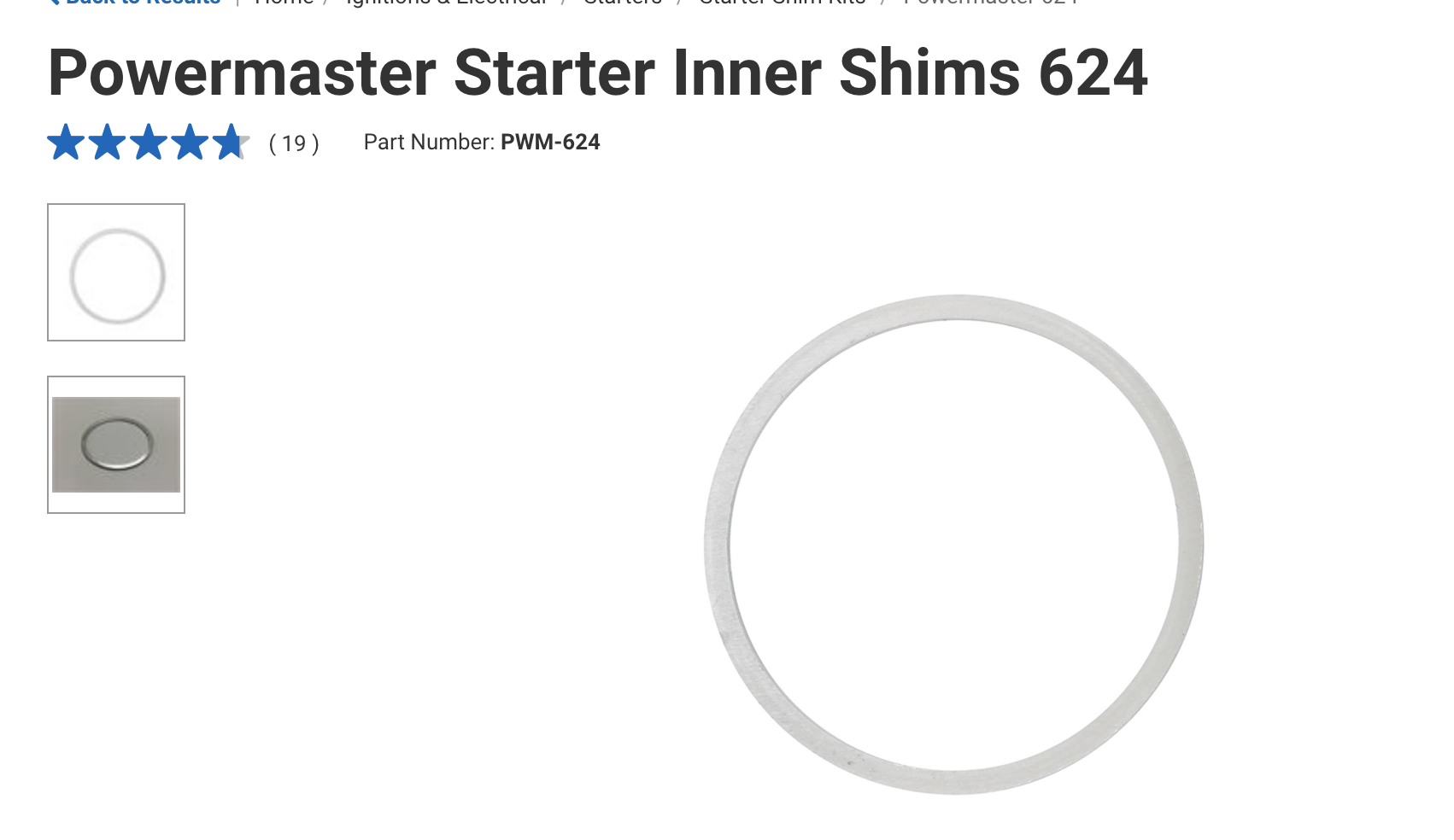

Old Nov 15, 2023 | 07:31 PM
tkcutlass's Avatar
Joined: Jan 2020
Posts: 1,277
From: CT
Looks like this is what I need,

Glad you got it figured out, should be a easy fix.
Old Nov 16, 2023 | 03:51 AM
That big round shim is usually included with the starter.

The shim arrived today so I dropped the starter and hmm it already had a shim installed.
It says not to use more than 1 shim.
I did notice 1 of the hex screws was loose since it did not squeal for the first 2 dozen starts I am thinking that's the problem.
I guess if the loose screw allows the starter to pivot it won't take much to hit the flywheel.
I think they have a .08 shim vs standard .062.

Spoke with Powermaster support and they said I could use two shims if need be.
Figured I'd try with one shim properly tightened, inch lb torque wrench showed up today so I gave it a shot, and ng it still squealed.
Installed the second shim and seems to be good now. Only started it once or twice. since the second Shim went in.
