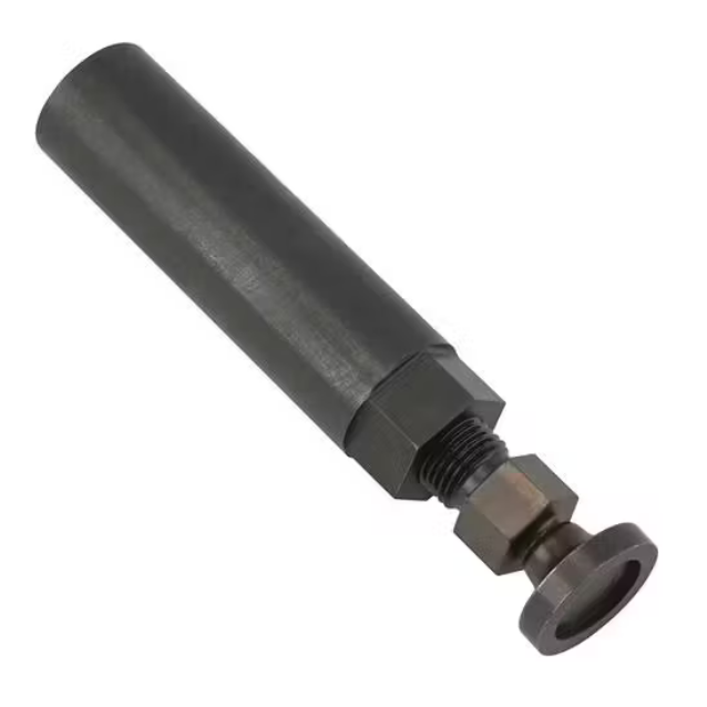

I've never understood the "wail on it with a BFH" redneck approach to repairing cars. Obviously a pickle fork will separate the ball joints, but it will damage the grease boots in the process. If you plan to reuse those parts that "look new" then I'd suggest a ball joint separator the way the factory recommends. Kent-Moore J-8806 is the correct jackscrew-type tool that easily separates the ball joints without trauma or damage. These are available used on ebay, but not all the time. You can also get aftermarket clones of this tool for about $30.

I've never had a ball joint, tie rod end, etc not come out when I would wack the spindle/ball joint mount with a hammer.
If you use the tool Joe referenced above, some bangs on the spindle where the ball joint goes into the spindle will help out also.
