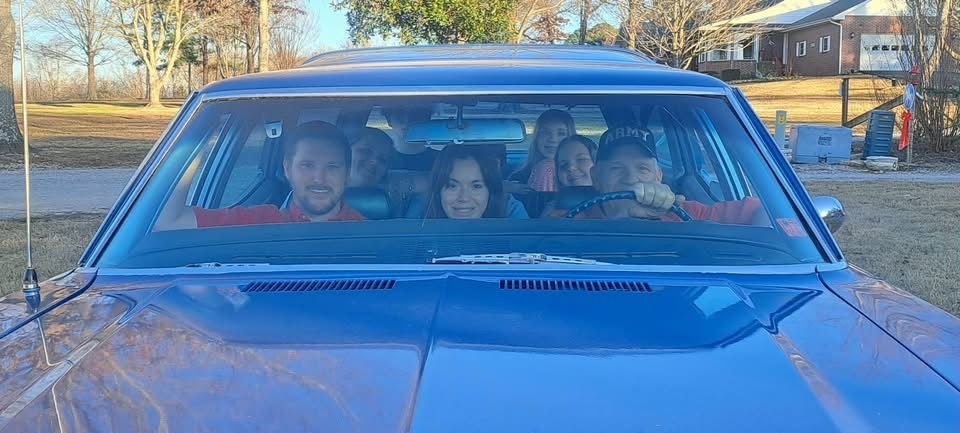

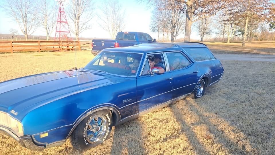

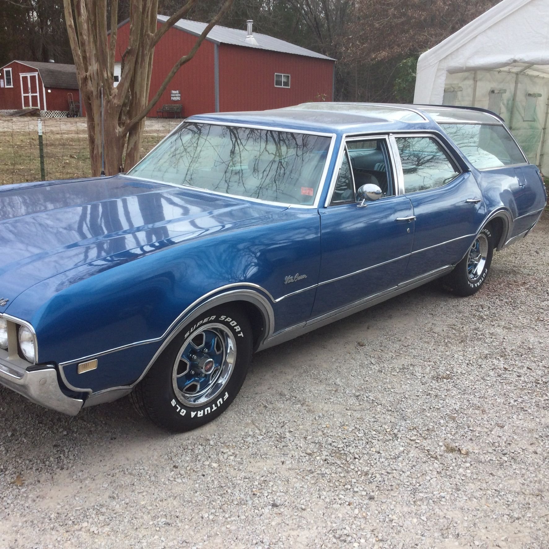

The cruiser.
A little update on my 69 vista cruiser, I’ve replaced all brake lines,wheel and master cylinders, all rubber hoses, fan belts, fuel pump, radiator. Rear coil springs and shocks, and have the front springs and all ball joints,tie rod ends bushings. Etc.etc. Waiting to be put on.
Rebuilt the carb, 2 barrel Rochester car runs great but has a rough idle. Trying to dial it in.
Here’s a a couple pics.
