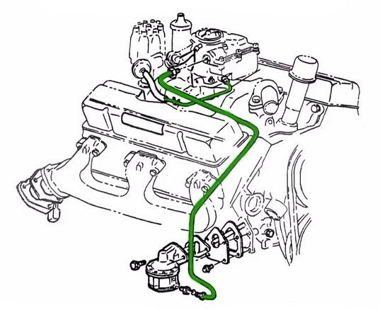

Are you referring to this vacuum line?
https://www.inlinetube.com/products/...gn=sag_organic
