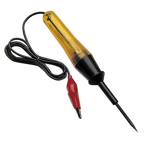

Best method to troubleshoot. Test each wire independently w/ a circuit light tester. Determine whether each lamp on that circuit is/is not OPEN/CLOSED or should be OPEN/CLOSED. This should lead you to determine which of the wires is incorrectly connected. Since all lamps illuminate when the LH driver's door opens (normal behavior), but only the RH front courtesy lamp illuminates when the RH passenger door opens, the most likely candidate is an incorrect connection of the RH door jamb switch.

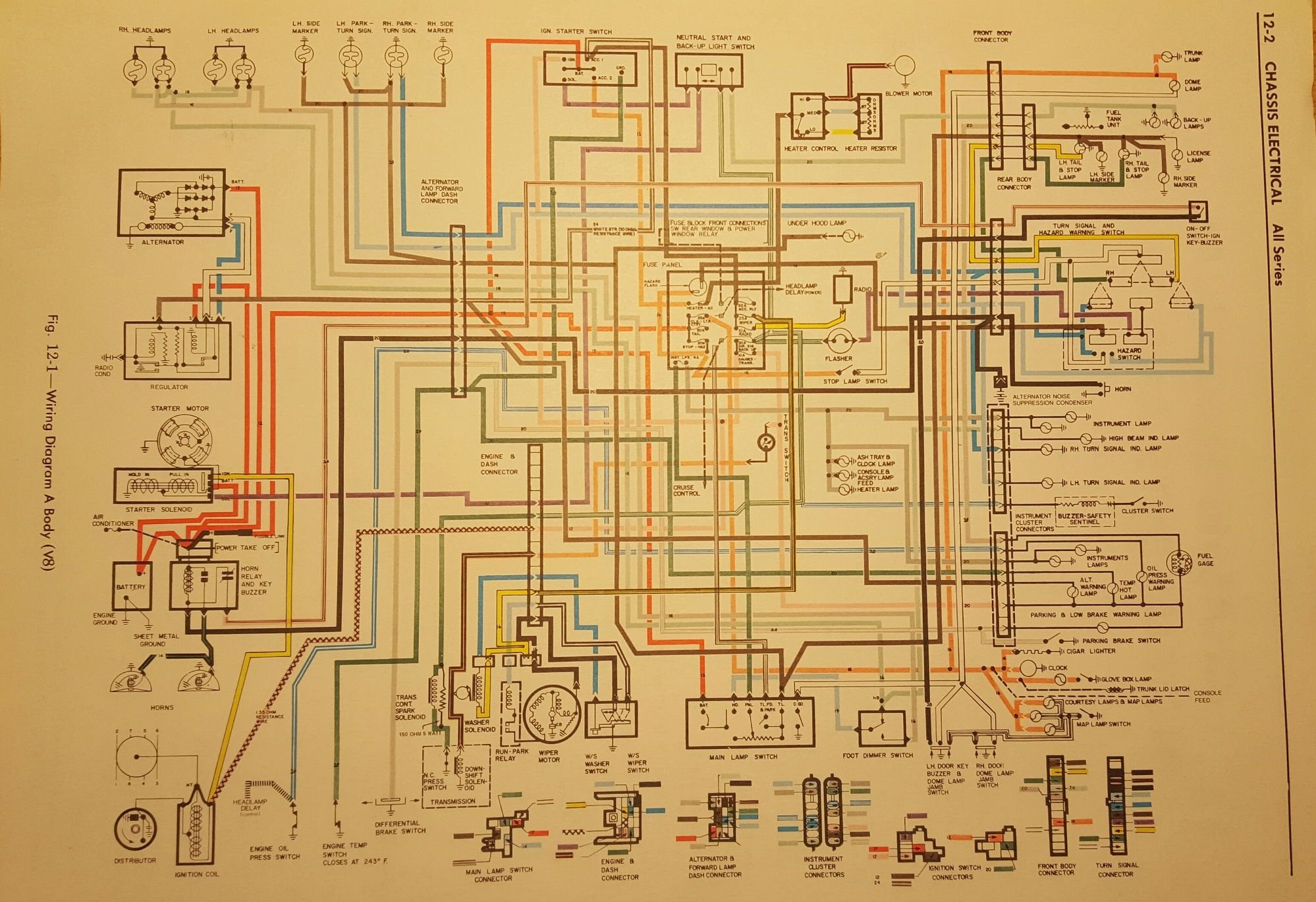

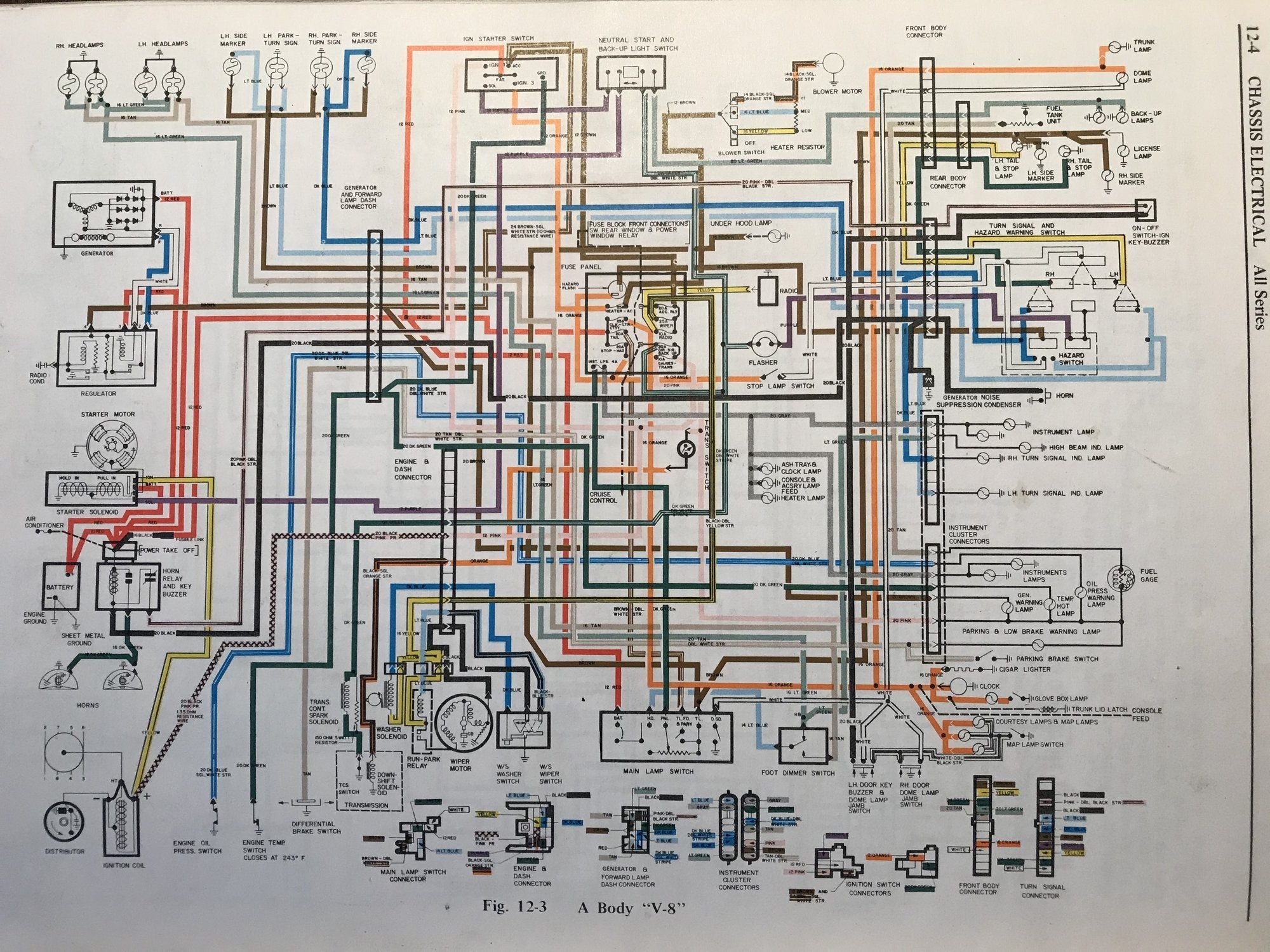

I don't believe the wiring diagram(s) changed between 1970 & 1971. True, 442 wiring diagram is black & white; however, I believe the wiring pursuant to your issue is not different between the 4-4-2 and other A-Bodies. I'll provide you with a couple wiring diagrams of each.
Old Apr 1, 2024 | 09:09 AM
Posts: 26,014
1971 Wiring Diagram
1970 Wiring Diagram
1970 Wiring Diagram

THANKS, Norm! This helps a lot. Still have to use a magnifying glass...
