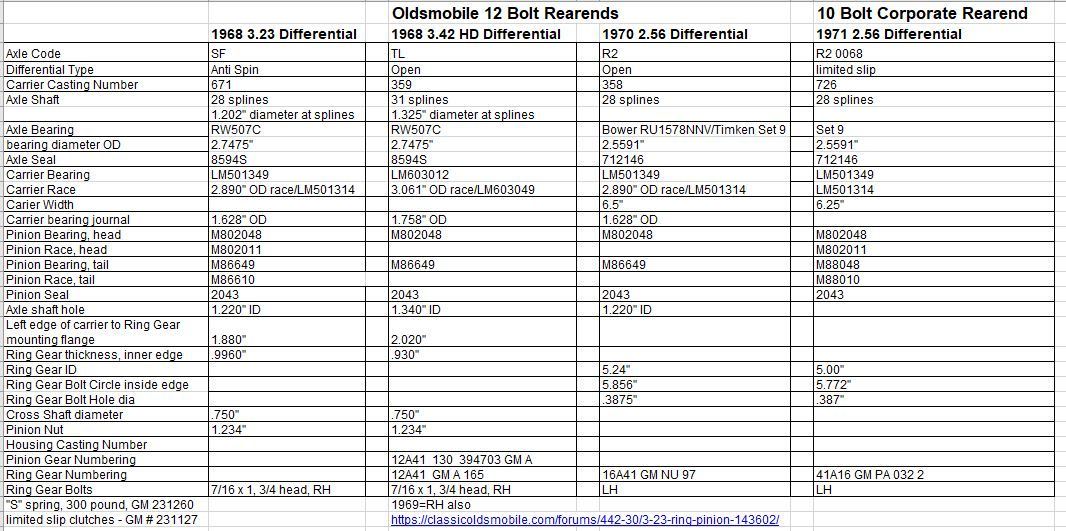

Back when I worked at an auto parts store with a machine shop, we would grind a slot in the retainer then use a chisel to crack it. Just be sure not to nick the shaft. Use a sledge to crack the the bearing outer race, then remove the inner race the same way as the retainer. Press the bearing on, then press the bearing retainer on. Don't forget the axle retainer flange.
Below is a screen shot of my differential Excel database with part numbers:
