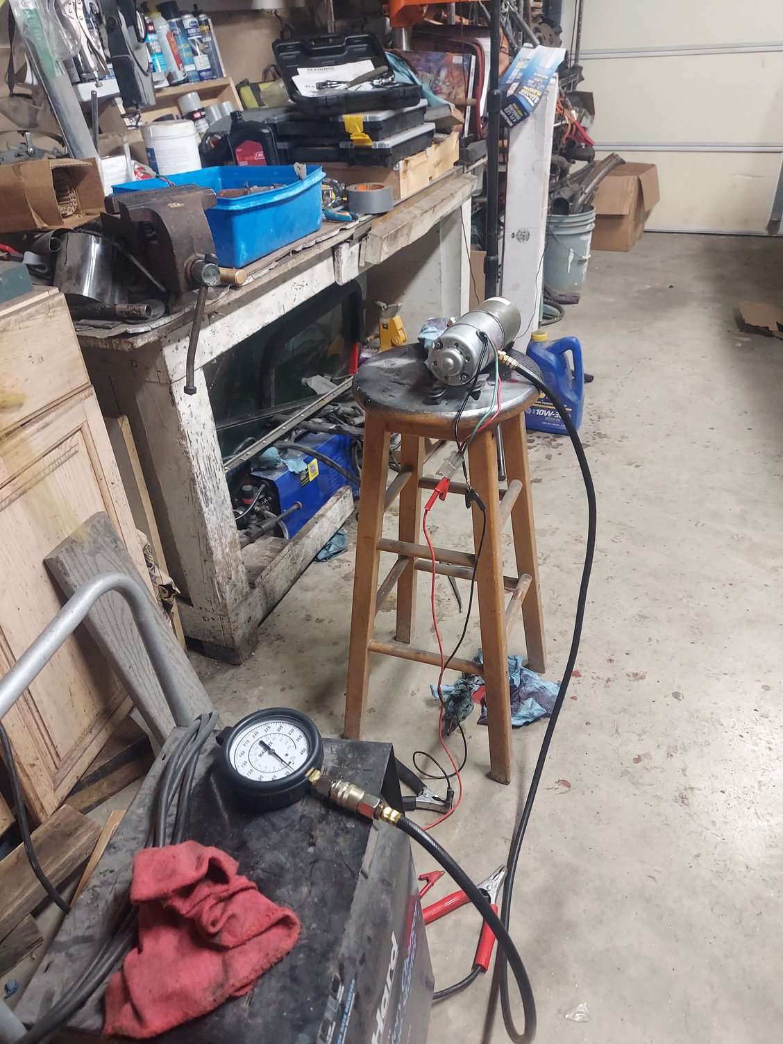

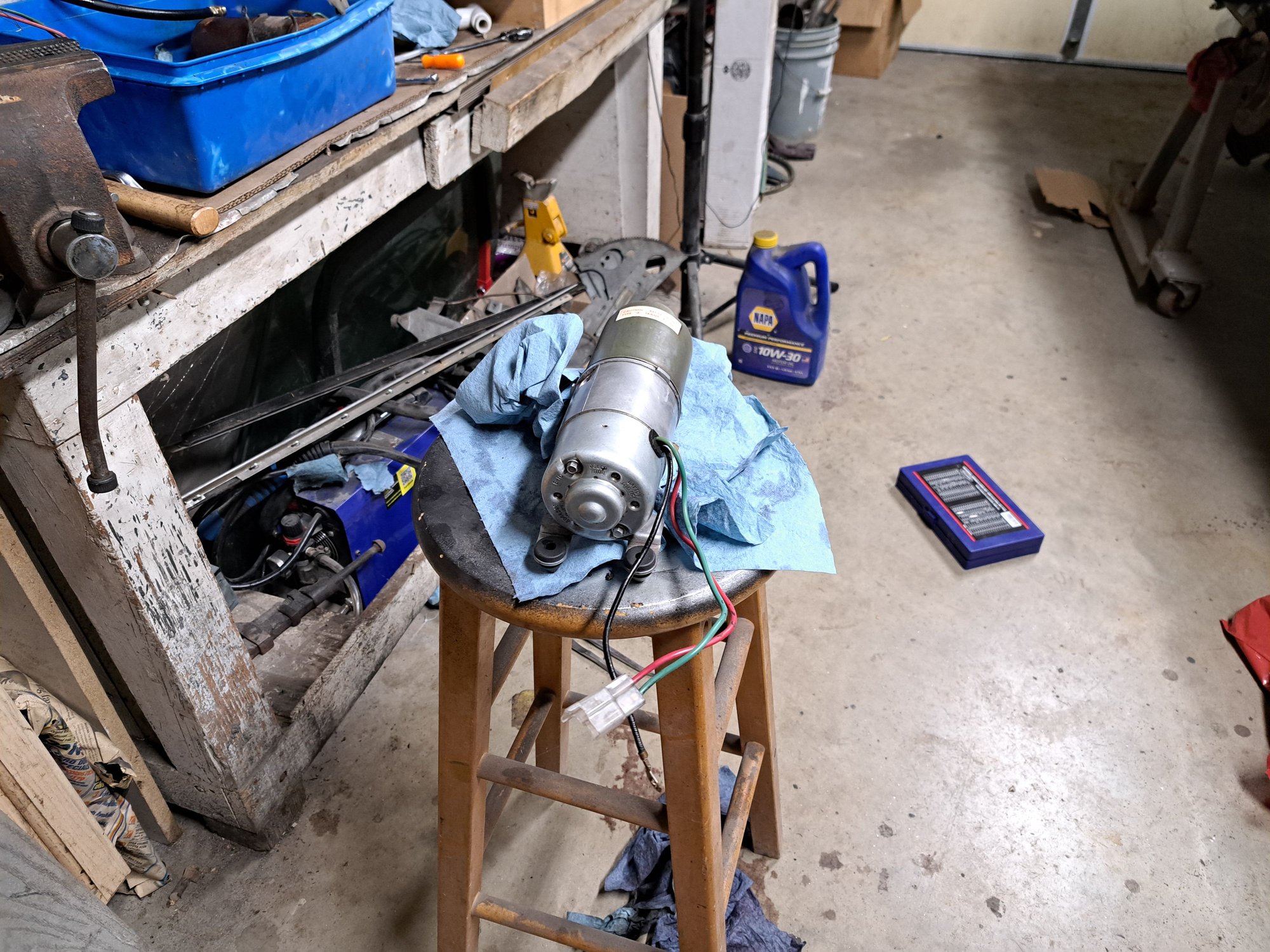

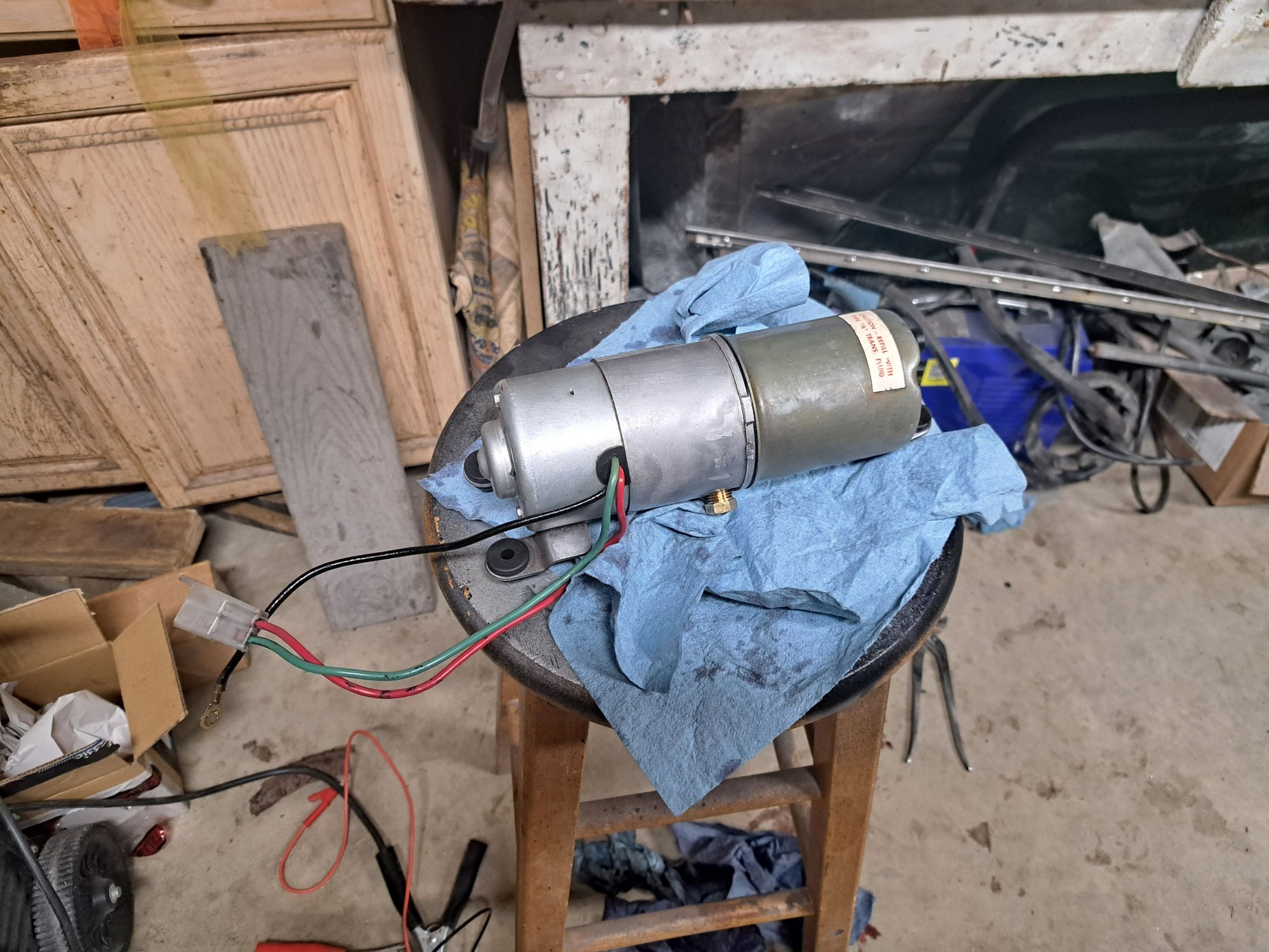

Has anyone tested the pressure output on their convertible pump?
one tested at 240-270 after rebuild, need to check the other port.
I only gave it 2 Amps from my battery charger, do I need more to get the recommended 340-380?
maybe more fluid is needed? It did come up quite a bit when I added more.

Tested the pump with the battery charger set to quick charge (40 amps)
Both outputs quickly maxed out the gauge at 400.
