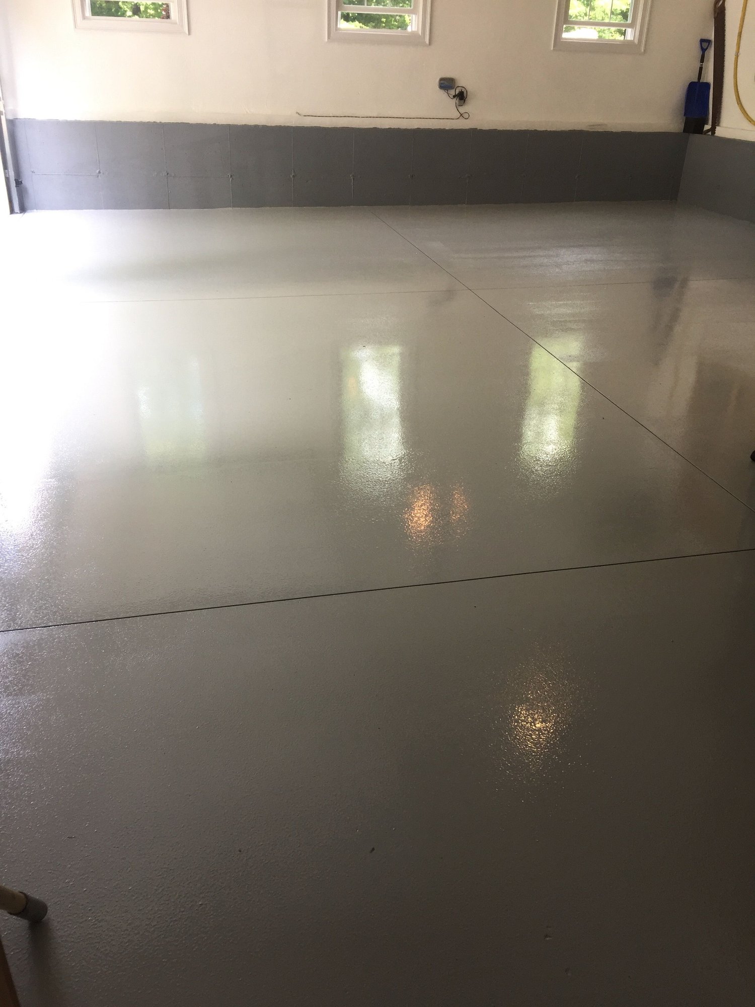

https://northerncoatings.com
This is a commercial brand I used in my garage. I put some silica sand on top for anti skid. Preparation is key but once on it is like steel.

I did use the hydro seal after prepping the concrete with a floor sander I rented with a 36 grit. I then applied epoxy in sections with 18' roller and broadcasted the silica by hand and rolled it in. It's a two part mix and if it's too hot out, it will dry quicker so plan ahead. I used a solid light grey to keep it as simple as possible.
