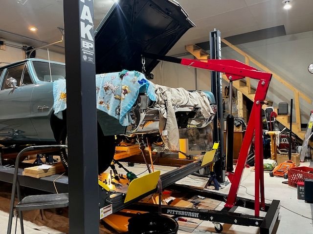

Car is on Lift, about 2 feet above floor. Loosened / removed the long mount bolt. Used the engine hoist to raise engine/ trans..
Here the Engine is supported and mount is removed

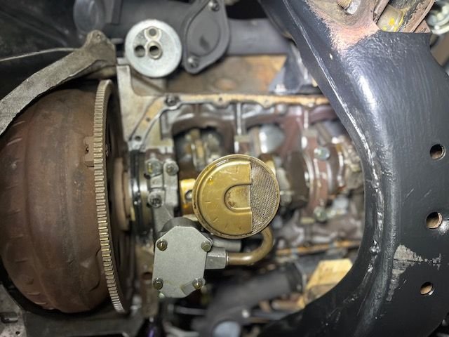

Since the engine was supported already, 'Might As Well' drop the pan and replace the gaskets.
I had to raise it almost to where the transmission touched the floor pan to get the oil pan out.. Exhaust, shift linkage were removed, I loosened trans mount bolts to allow some flex.

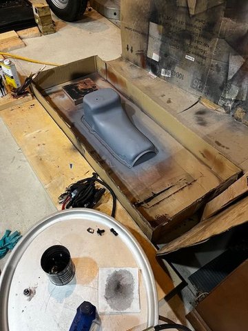

Cleaned, primed and painted the pan
[img alt="Cured the paint on my custom parts oven
(My wife was not thrilled)."]https://cimg2.ibsrv.net/gimg/classicoldsmobile.com-vbulletin/640x480/img_1485_b5d530ed61b5415e4a99936a1cd97205a24f41e7. jpg[/img]
