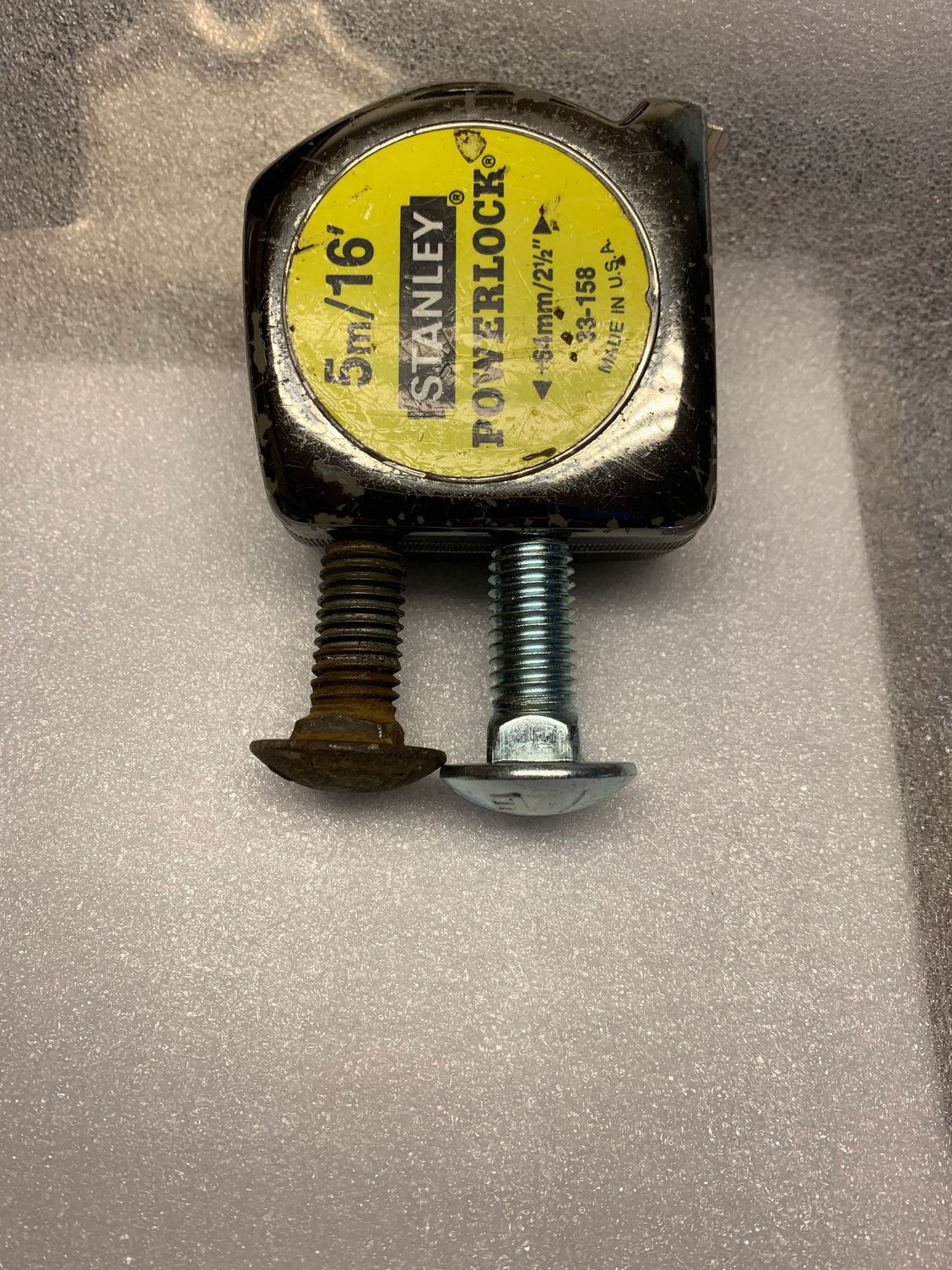

Bob I made a post on the correct frame carriage head bolts. There is important information there. You should check it out. If your originals frame to bracket bolts are good have them phosphate plated and use originals. The problem is new ones don’t have the correct small square under the head and don’t allow you to adjust the bumper. This is an original next to a regular carriage head bolt. Look at the square under the head. That is the issue.

This is in lines offering. The squares under the head require grinding to work properly.
