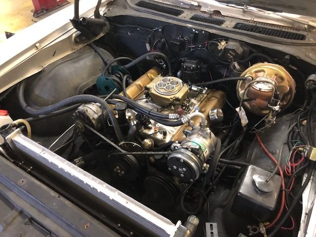

Here's what it looks like now.

Originally Posted by rhett838
Thanks!
What does it do?
Supports the pulley, I had a center brake out before I realized that it needed some support with the fan clutch removed.
Johnny
