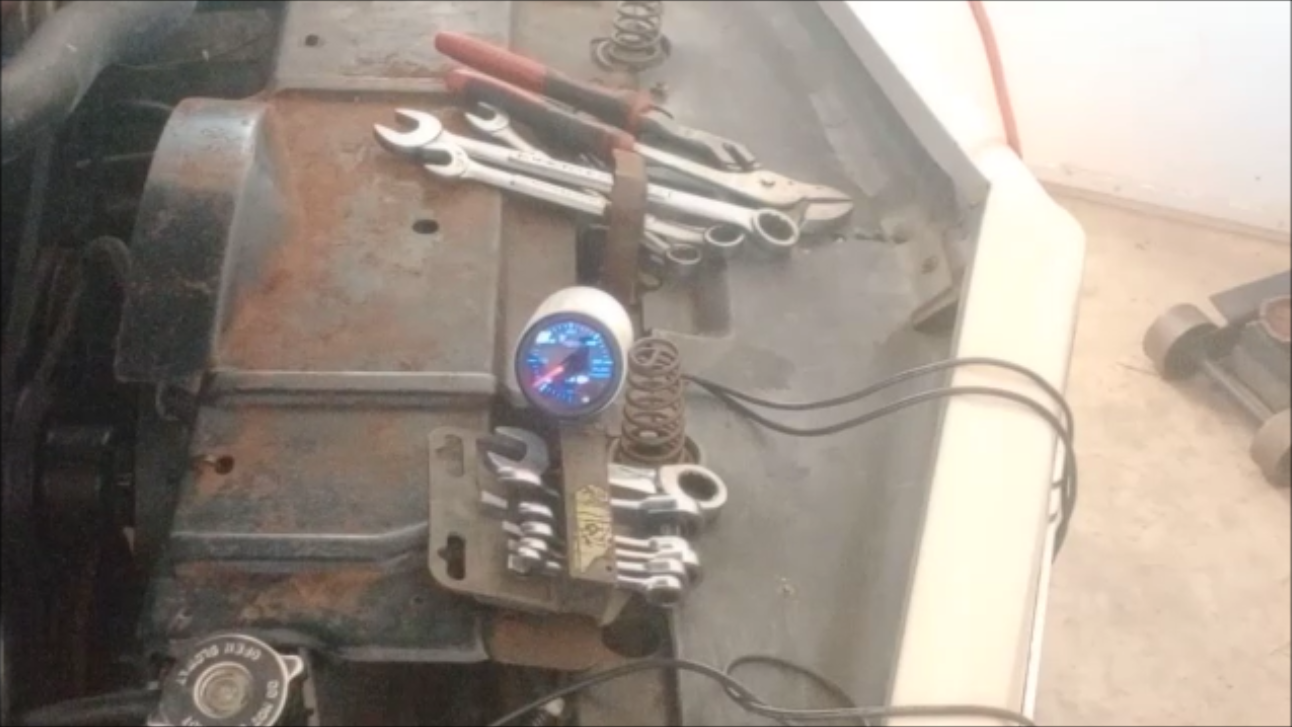

Here are the fuel pressure numbers.
Analog gauge:
cranking: 7.5 psi
idling: 8 psi
Electric gauge:
cranking: 7 psi
idling: 7.5 psi
Old Nov 15, 2025 | 10:57 AM
Posts: 16,698
That's plenty, even a lttle high ... I don't know if 8 PSI is enough to cause a problem, though.
