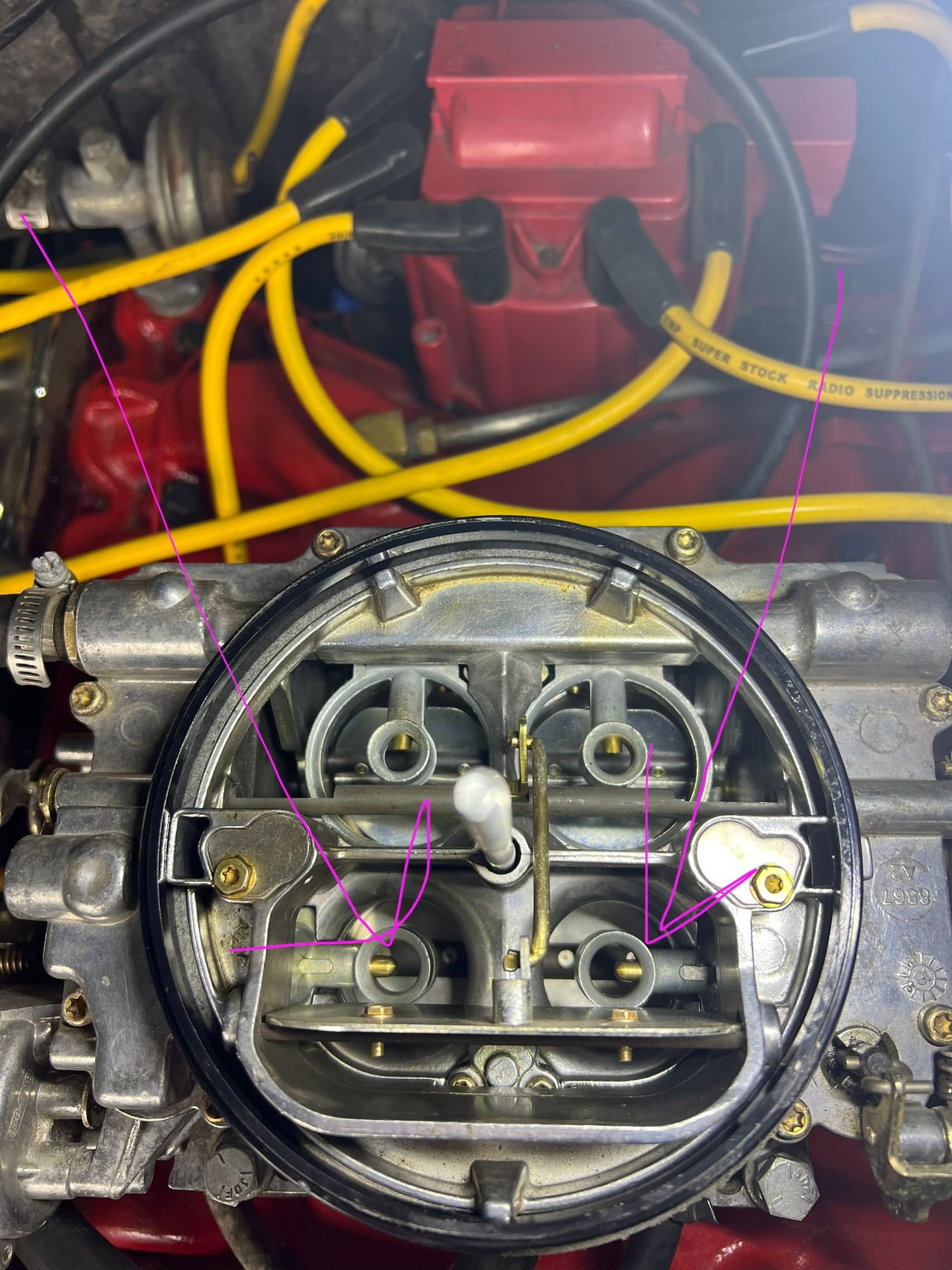

Ok so here’s the update after trying some of the above suggestions . I took the car for a 1hr plus drive . Got home and parked it . Engine off.
-Strong raw fuel smell from the top of the carb when I took the air cleaner off when hot .
-I did see fuel squirting into the two bowls closest to the nose of the car on the carb when I worked the linkage( see pic with arrows )
-Car starts right up after sitting hot for 5+ minutes with the air filter off. Very interesting.

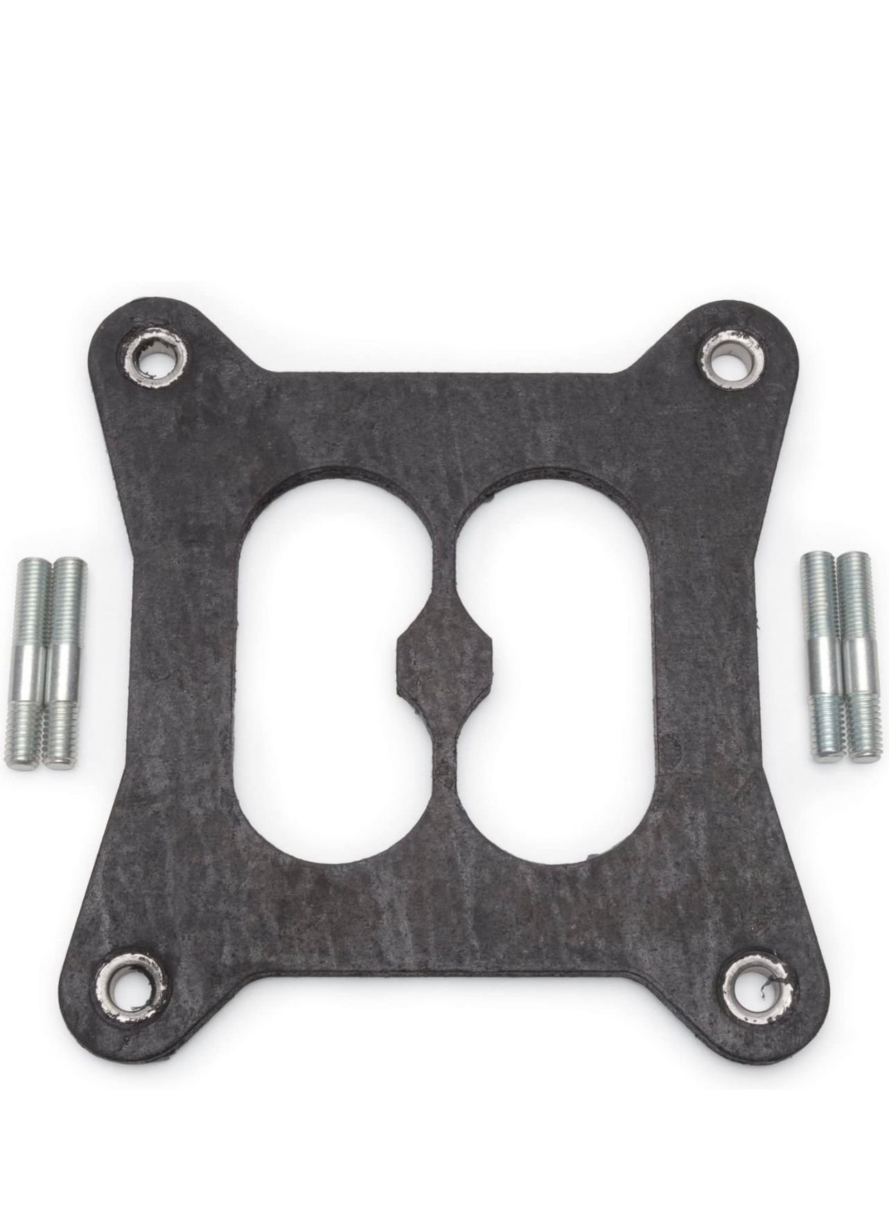

I did buy some insulation for the fuel line since it’s sitting on top of the manifold and I did buy the edlebrock 9266 heat insulator gasket I was gunna try (see picture). The car also has an edlebrock performer intake .

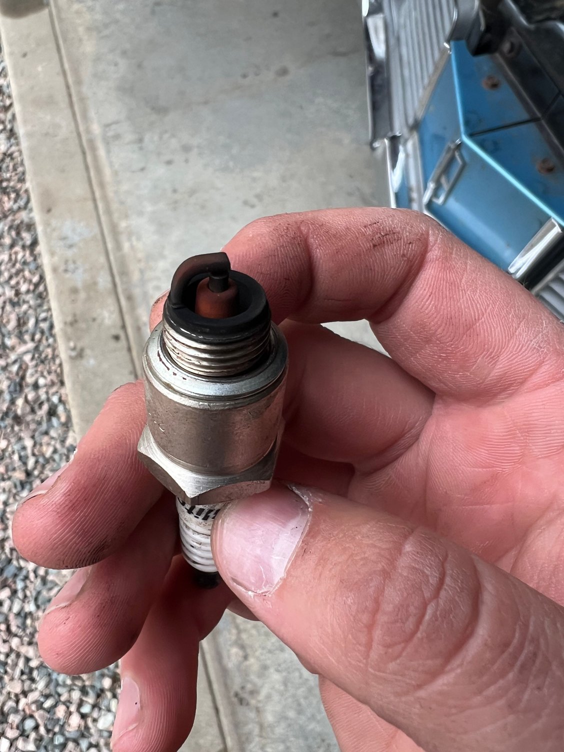

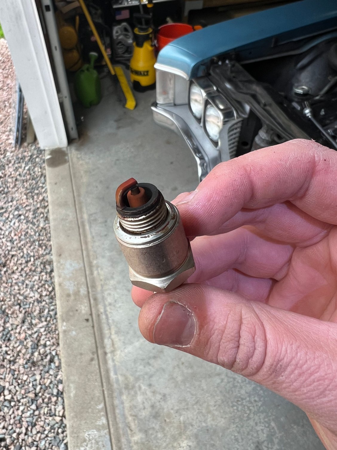

i Also included a picture of two spark plugs from the drives side .

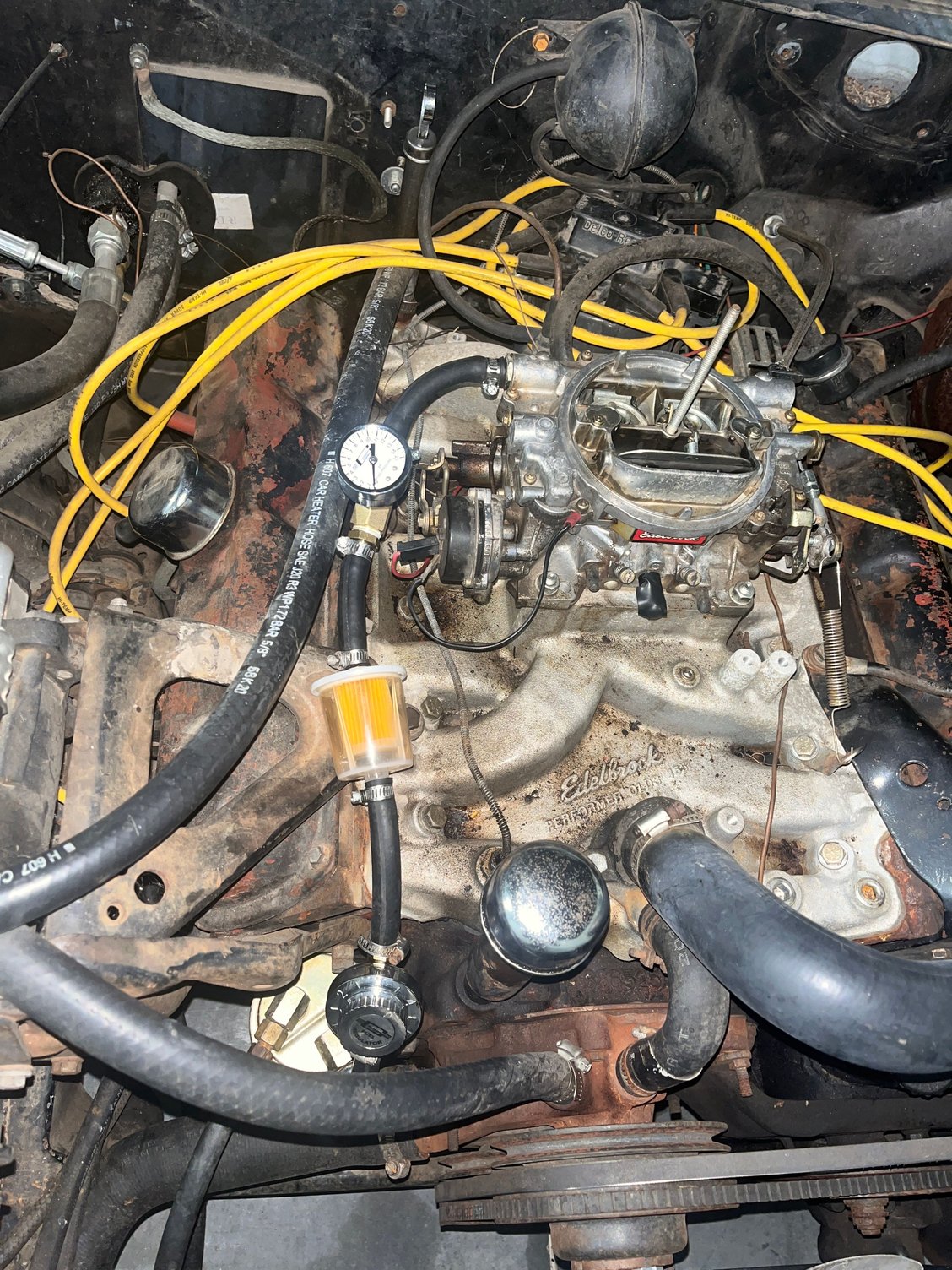

Hello gentlemen. As the title states, I have some questions about my fuel system. I still have a mechanical fuel pump and I have installed a fuel pressure regulator and pressure gauge, all in line to the carb. My fuel filter doesn’t fill completely with gas. However, my gauge is reading 4psi. Should the filter be filling up with gas?
