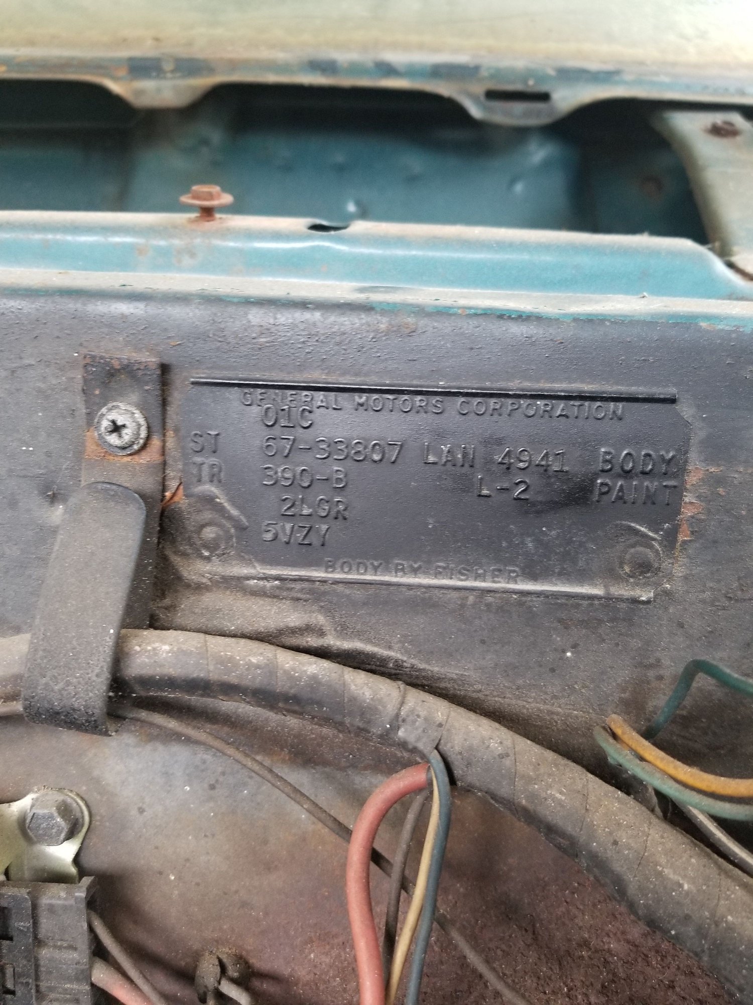

Without at least the POP or the broadcast card or whatever it's called, no way to verify factory W30. It could however be one of the 4 January builds without the "E" as mine is; pic of my car's body tag attached.
I assume your car is a documented 67 W30,right?

If the last 4 pictures are of the car in question it is NOT a W30. That is for sure!
how so?

Well the biggest reason is very early car (only a handful made) no paperwork and before the E was stamped on them. Possible but not probable. Would make it the #4 of #4 ever known.

IMHO I think it's the real deal. I have a friend who is very interested in the car providing the drive line is correct.
the “E” is on most but not all. So being I have a one owner car with an “ S”, I don’t buy the “ E” theory at all
This could be true. A POP and correct heads would go a long way.
