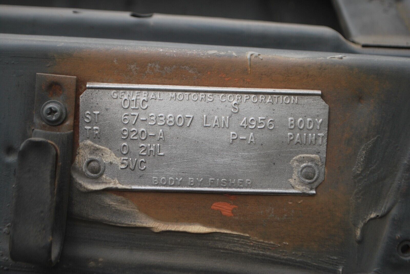

Old Nov 11, 2024 | 04:57 PM

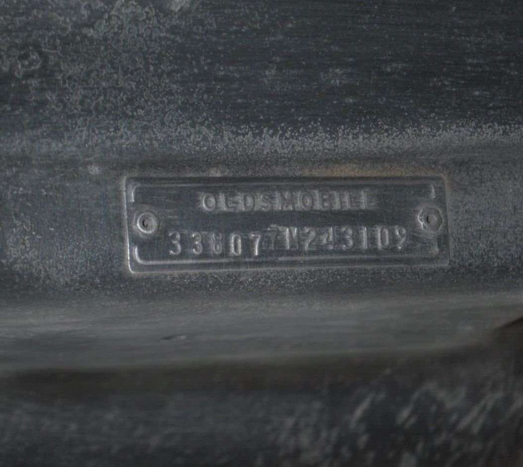

If the last 4 pictures are of the car in question it is NOT a W30. That is for sure!

There is a very easy way to tell a real 1967 W30 from those pictures.

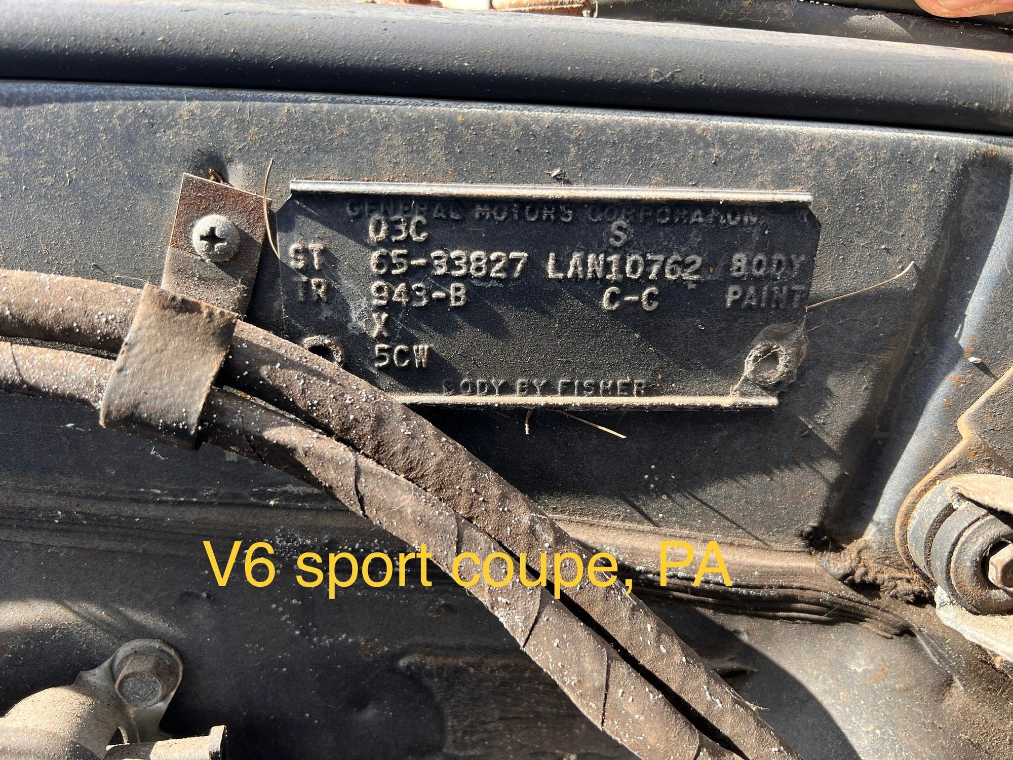

Also, I have never seen 5C before, and nowhere else I can find does. I'll update my cowl tag sheet if someone knows it.
That's why I posted the money shot. ;-)

Yes the money shot is the data plate! It proves that this car is NOT a 1967 W30. I will go out and tell it now. A real W30 in 1967 would carry an E above LAN and sequence number. THAT is the definitive item on the data plate that denotes a real factory W30! Period!!!!!!!

Guy got duped it sounds like if the cowl tag info is 100% correct. I know little of 67 w cars.

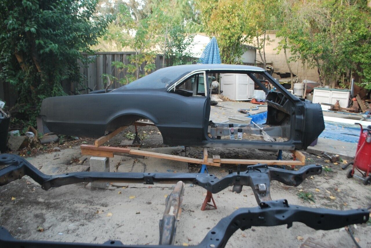

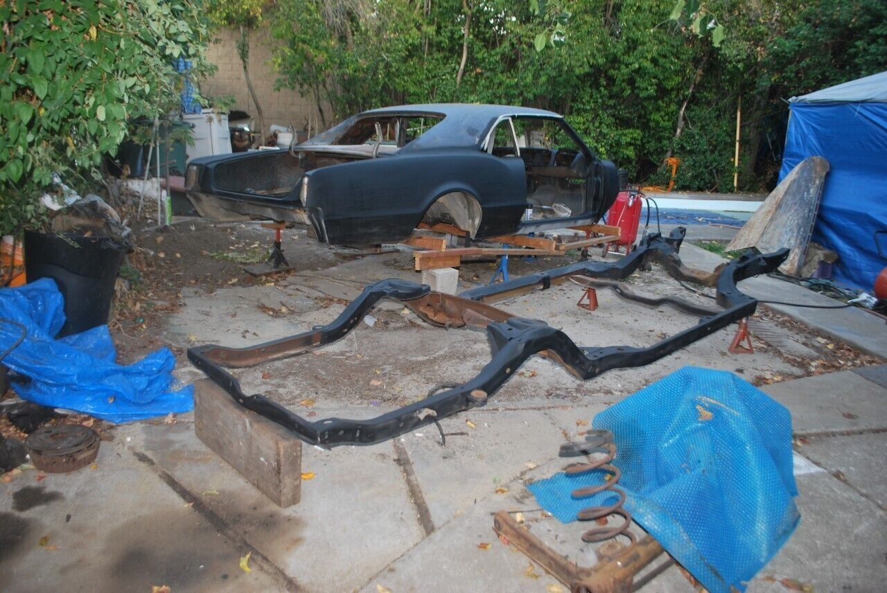

I think it has a lot of W parts, but the body is not one of them. Frame might be. There's no picture of the engine, for instance.

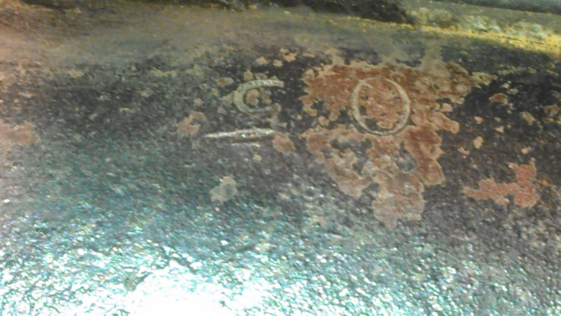

I'll add one other little note about frames of 66 and 67 W30 cars. There is a specific way to tell if those are real also. Markings in 4 places will tell you if the frame is a real W30.

As said not a W30 IMO but could be a era converted Track Pack car, wonder what rear is out back. Core support looks to be factory punched or corners smoothed nicely. So much time has passed and cars change hands and stories grow like the children's game...whisper down the lane... The line about 5 cars with a bench seat I would call BS. Would be an awesome car when done though.

So Mike, is it possible this car is one of the 4 and does not have the E on the tag? The core support-sure looks correct.
It's a January build, so if it's a real car and the other January builds not having the "E", yes.
I have seen 2 reported factory W cars with no letter at all where this car has the S. Dont know build dates of those. So would those January build cars have a letter there or nothing at all? Most 442s have letters in that spot. S is a popular one.
Koda, I've found 2 "C"'s on 65 in the 5th row position. No idea what it means.

Pewter car with black painted roof and Heater delete it would seem.

Peter, it's a code for a very low option car. I also don't have W on my group 5 codes. So I need both C and W, hah.
Any guess's what the 2H means?
Old Nov 12, 2024 | 01:42 PM
  #33
Posts: 12,810
Heater delete.
Old Nov 12, 2024 | 02:10 PM
  #34
Rallye469's Avatar
Joined: Feb 2008
Posts: 2,665
From: Jacksonville, FL
I'snt 5W deluxe seat belt retractors?

Since this car has an S where an E or no letter would be it is doubtful it is a Factory W car. Since the "kit" was available sans red wells, chrome oil fill cap and chrome valve covers it could be a converted car. Heater delete is a cool option as well as tu-tone paint. Perhaps a wrecked W car was sourced for the red wells, core support, and other parts.
