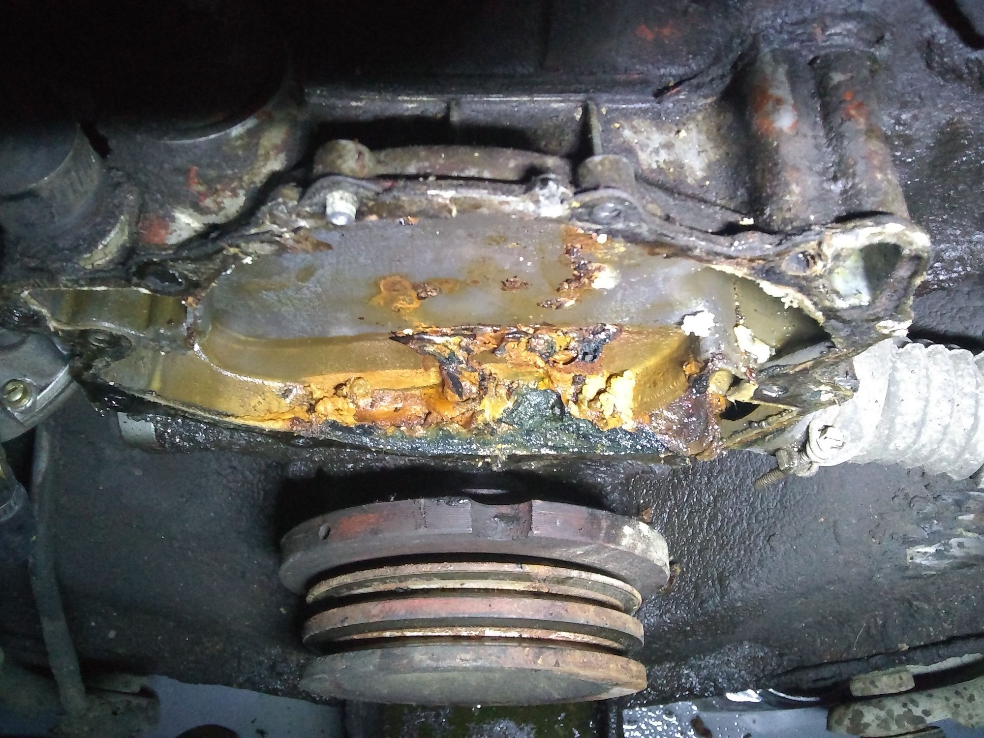

OK guys ran into a problem.... pulling the water pump off I snapped 3 of the small 1/4" bolts off in the timing cover. I got the pump off, but it's rather ugly.
Does anyone have one I can buy, or am I relegated to drilling them out and retapping them? How does the timing cover come off? Here's a pic of what I was greeted with....

Old Nov 23, 2021 | 07:05 PM
My advice, since you're almost there, remove the timing cover and replace the timing set. Then extract the broken bolts if the timing cover isn't all corroded.

Old Nov 24, 2021 | 02:35 AM
kmakar89's Avatar
Joined: Nov 2021
Posts: 41
I already figured since I was 3/4 of the way pregnant into this, I'd replace the chain and gears.

Ah yes the MAW's... be careful or it will turn into a complete engine rebuild and frame off restoration! Boy that sure has a lot of rust/crud. Was there only water in cooling system?
Old Nov 24, 2021 | 03:44 AM
kmakar89's Avatar
Joined: Nov 2021
Posts: 41
I did smell antifreeze, but it looked much worse than it was. the timing cover cleaned up nicely, but I still have to deal with broken bolts, so the timing cover has to come off.
Not sure if the oil pan can be pulled without pulling the engine, so that will dictate how far I go. Already had planned on giving it a good pressure washing under the hood, but it may go a little further than that. We'll see.
