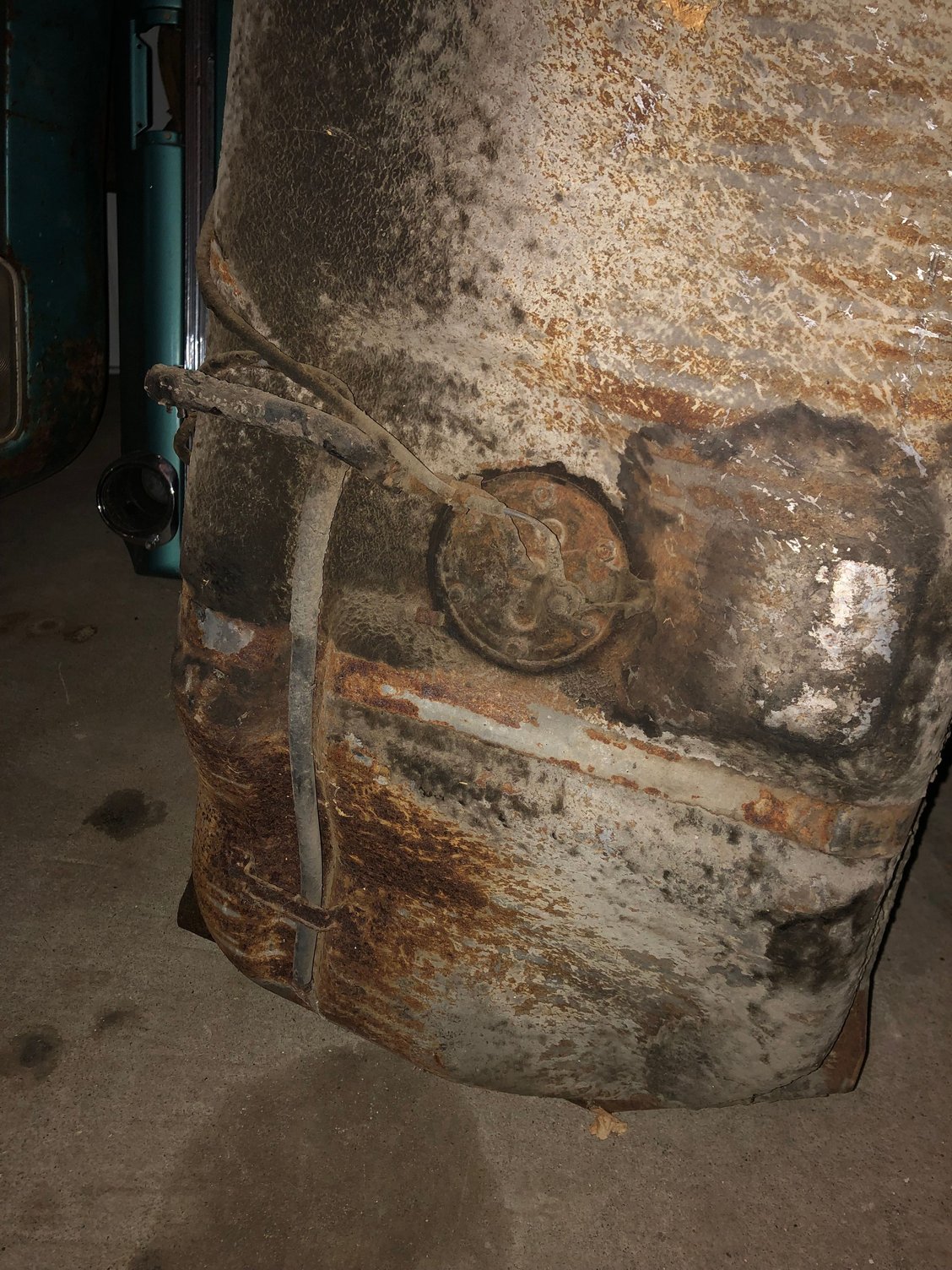

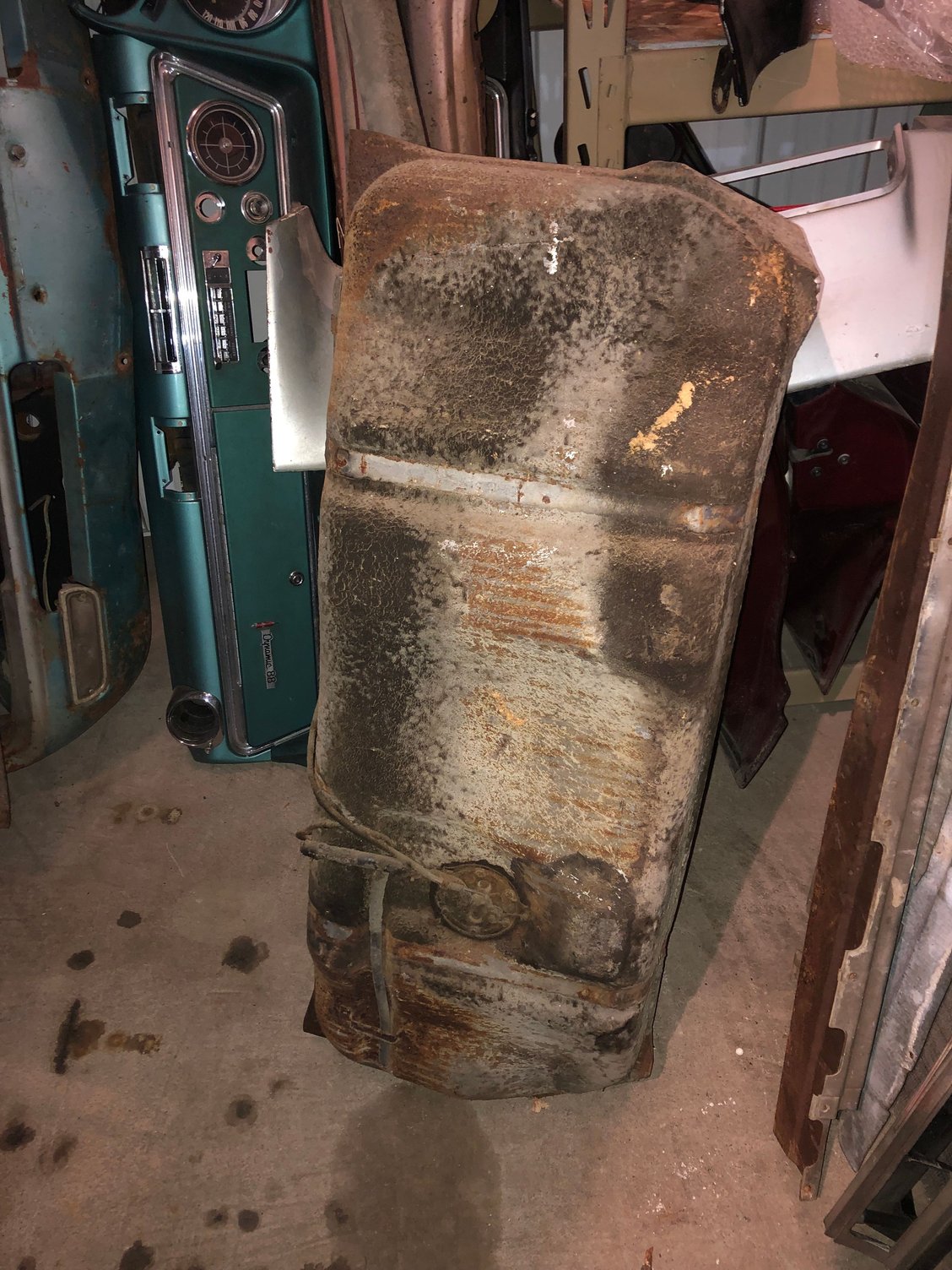

I’d need to dig it out. $400 for a good tank. Sending unit wasnt with it.
Old Feb 9, 2025 | 01:05 PM
deaddds's Avatar
Joined: Sep 2009
Posts: 2,858
Found this one with sending unit in it. Untested of course.
