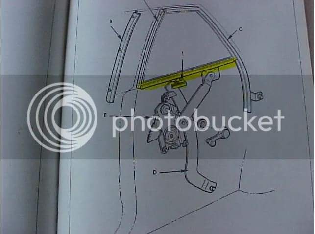

This is the part in question. What the quarter windows in a 2 door post sit in.

Here is the channel, you will have to cut and weld the brackets onto the channel, not sure on size but this should give you a starting point
https://www.restorationspecialties.c...nel_c_321.html
It's a U-channel that the rubber sits in and squeezes the glass
Regards,
Jim
