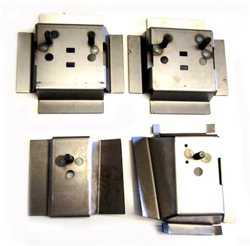

If you're taking out the bench seats, you'll need to install bucket seat mounts on the floor pans. The 2 types of seats are not interchangeable. Measure the height from floor pan to ceiling and compare that to the camaro seats. You can also use Grand Prix, Grand National, Monte Carlo, Buick Regal as donors. Just an FYI, Parts place makes the seat track mounts (part IN8514Z)
