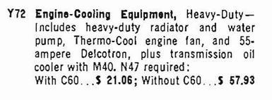

I don't know the specifics for your car, but a tow package usually consisted of things that made it both easier to use the car and easier on the car. Most certainly it meant a heavy-duty radiator, a heavy-duty transmission or transmission cooler, a heavier-duty alternator to handle the heavier electrical load from the trailer's marker and tail lights, and often heavier-duty springs and stiffer shock-absorbers. Of course, it typically included a trailer hitch and a trailer wiring harness as well.
I don't have the 1981 Specs, but here's a section of the '71 Vista Cruiser options page. If you planned to do trailer towing, you would get options F41 and U89 for sure, and you could substitute the G66 "Superlift" shocks (air shocks) for the heavy-duty shocks if you wanted.
It was not part of the towing package, but you might also have gotten option Y72 as well. The C60 referred to is air-conditioning. M40 is the TH400 transmission, and N47 is power steering.
Nowhere does it show a trailer hitch as an option. They apparently left that to the owner to find after he got the car. Not surprising given the large variety of hitches available.
I imagine the contents of a "tow package" were pretty much the same in 1981 as they were in 1971 and probably the same for most any year. The requirements for trailer towing have been pretty constant over the decades.
