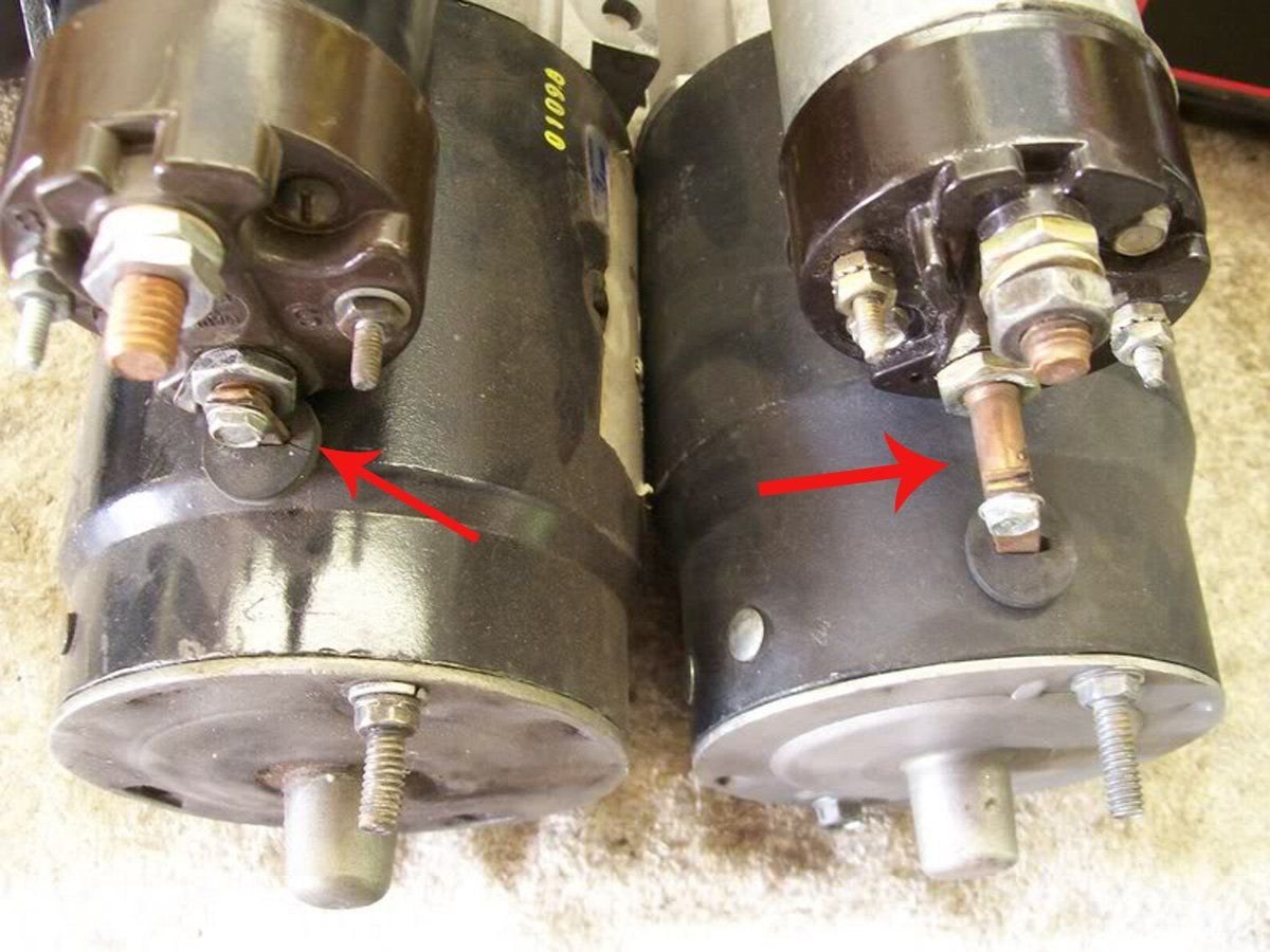

Keep the original. Look closely where a tab(s) come out of the starter field case with a screw through the tabs to the solenoid. How many tabs does the screw go through on each starter. Does the screw go through a spacer about 1/2" long or do the tabs line up with the end of the solenoid?

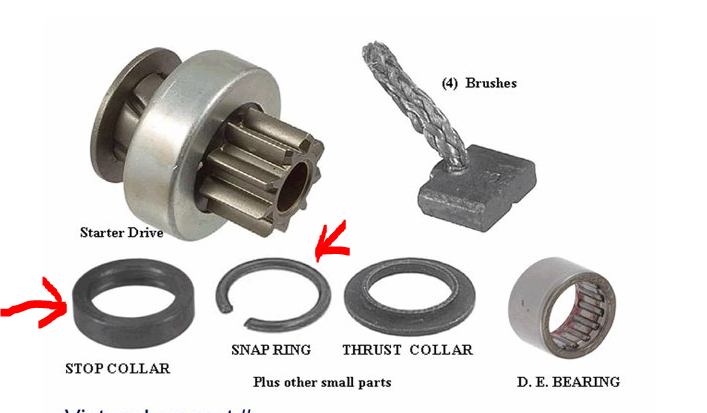

What happened is...the solenoid kept the starter engaged due to the drive overextending keeping the copper disc in the solenoid engaged on the positive bus studs.
Usually, the gear stop collar and or snap ring is busted, Other causes are a bad drive mechanism, the starter solenoid itself, or the starter end bell/nose is broken(flywheel end).

Make sure you get the correct high torque motor if you decide to roll the dice on a reman,
Clean both ends of both the large battery positive & negative cables.
High Torgue on the right vs Low. Note the motor body on the high torque is longer.

dr, I think it has to be the longer body AND have two tabs mated together under the screw to the solenoid to be a high torque. Someone please chime in if they know for certain.
When I get the old one out, I'll compare the two and see what I'm working with; I was planning on keeping the old one just in case (I've learned to keep old parts over the years on my classic builds)
I do not think the reman has the longer bolt stud, but will make sure to check. I really appreciate the info!!

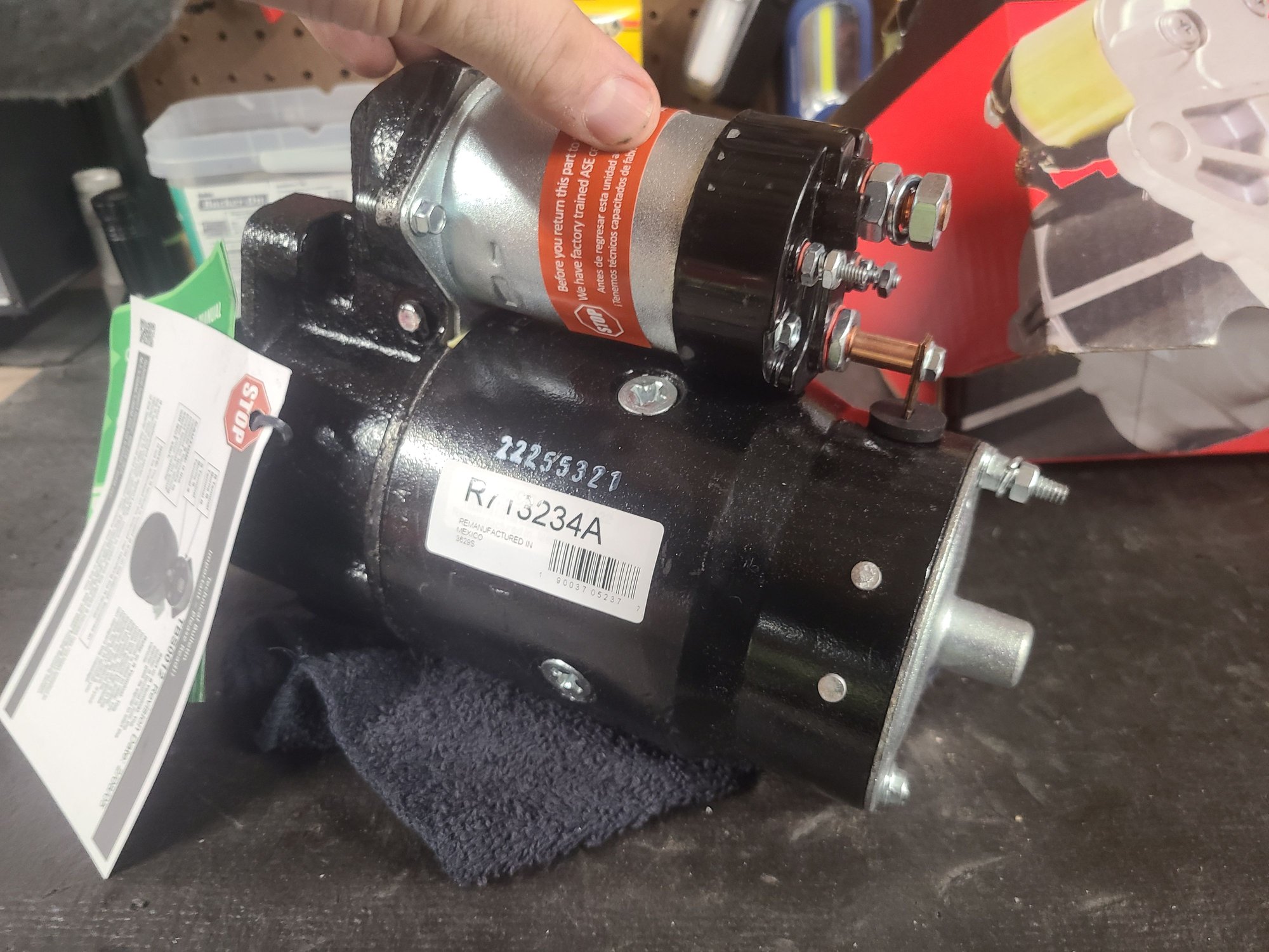

Posts: 12,828
Also, there's a number on that bad boy, just relay it to us.

So the reman starter was in fact a high torque starter, exact duplicate to the one that was in the car. 3 wires connecting the starter (yellow, purple, and battery), and of course the 2 mounting bolts. No ground strap that I could see anywhere. Bolted right up, and started no problem. Took about an hour. Tested it thoroughly and made sure all connections were clean and tight.
I appreciate all the info guys. It helped a ton. Reman starter was $125 total, after taxes and no core charge.
