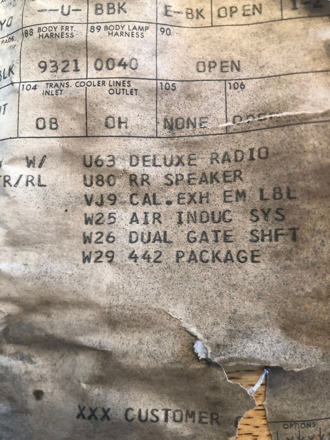

Yeah, I have not found a build sheet anywhere in my low mileage 1972 Cutlass 442. It was built in Arlington, Texas. None on the gas tank, none under the carpet and none under the front bucket seats. There is a paper in one of the halves of the rear seat by the seat springs but I did not replace those seat covers so I can't be sure. I may order the rear seat cover from Legendary and install them next winter so I can see what that paper is! I do have the original window sticker so it is verified to be a true original '72 442! See part of window sticker below.
I guess this will serve as verification, but I'd love find a build sheet!
I've found numbers matching for the engine but not seen a number on the TH400 yet. Are there other numbers I should be concerned with?
It is neat that the above owner has a 1972 455 2bbl Cutlass 442! Really neat!
