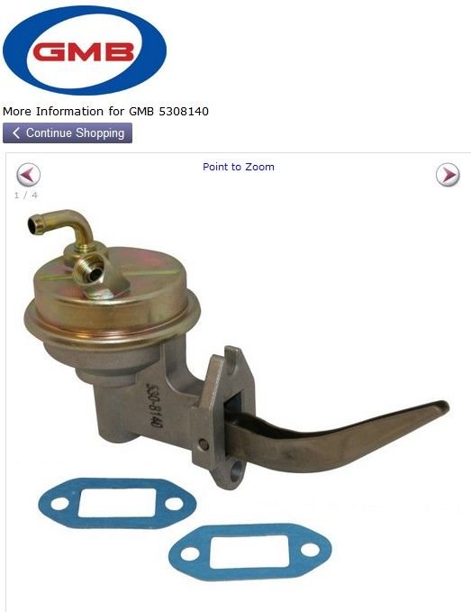

Old Aug 13, 2022 | 10:33 AM
Posts: 26,056
Me again. Fuel pump removed, old gasket had some type gasket sealer. All old gasket sealer & old gasket removed down to bare metal & cleaned with engine degreaser then brake cleaner.
QUESTIONS:
1) I noticed regardless of manufacturer they ship a fuel pump w/ two identical gaskets - this GMB is no different. Why do they ship two identical gaskets? In case you botch your first attempt or some other reason? I wouldn't think I'm supposed to apply/install two identical gaskets on top each other.
2) Should I apply a gasket sealer to both sides of the gasket (including the new fuel pump)? Fuel pump doesn't need a gasket sealer? If I should apply a gasket sealer, here's what I have in my arsenal at the moment. Suggestions?
a) Permatex - (Green) Gear Oil Specialized Formula Gasket Maker - What I generally use for sealing differential covers, transfer case covers, etc.
b) Permatex - (Blue) Fast Drying Hard Setting Form-A-Gasket Sealant
c) Permatex - (Gold) Ultra Copper Advanced Formula Maximum Temperature Gasket Maker
d) Permatex - (Red) Red RTV High Temp Gasket Maker
Thanks for looking.
Old Aug 13, 2022 | 12:47 PM
Posts: 26,056
I went w/ two gaskets plus light coats of Red RTV High Temp Gasket Maker (81160). Fuel pump in, AC compressor bracket next to button it up.

I've always speculated two gaskets in the box were for those applications with spacers.
This is my preferred method: I use only one gasket with Permatex #2 applied to both sides of the gasket, torqued about 26# with thread lock on the bolt threads as these bolts/nuts normally vibrate loose over time.
Hope this helps.....
Old Aug 13, 2022 | 01:23 PM
Posts: 26,056
All done. Torque value is 25 lb-ft. I used thread locker. I torqued the bolts to 25.467389203 lb-ft +/- 0.000000001
Thanks for the input.
