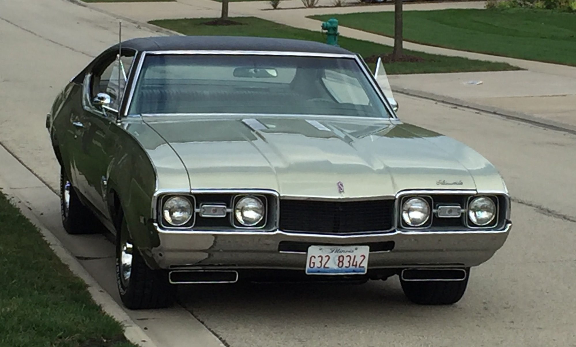

Those custom wheel covers are likely to be the envy of the Olds community!😁

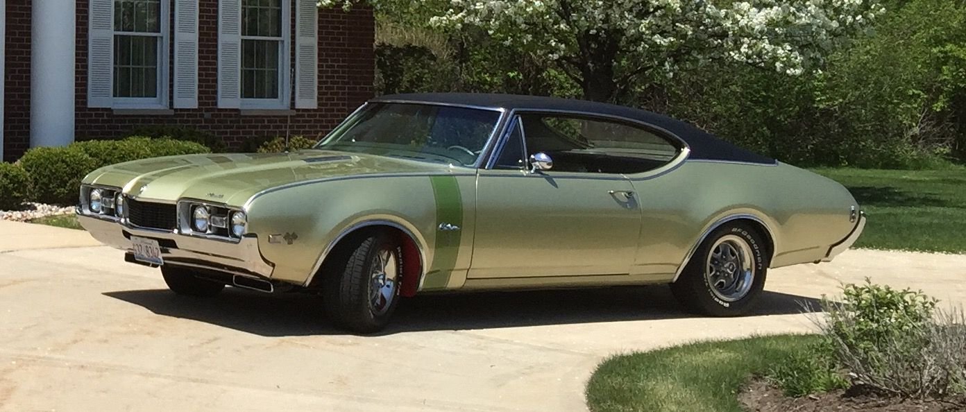

I dropped my 68 using Hotchkis components. Very happy I did. The car handled very well after that only needing a quick ratio steering box to really take advantage of the handling. You may laugh but that 68 cornered, FLAT! Derek Bieri once said on his show, "If you don't think 2 inches is a lot, ask your ex-wife!" I nearly fell out of my chair! It really makes a difference. A much needed engineering assist to the guys at Olds in the 60s.
This looks like a brochure from Olds. Remember when their cars looked stretched or elongated for the ad?

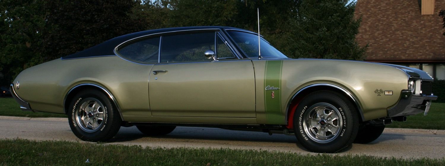

Thanks for info is your car stock springs, and can I bother you for a side picture to see how car sits Sorry to be a pain . Vinny

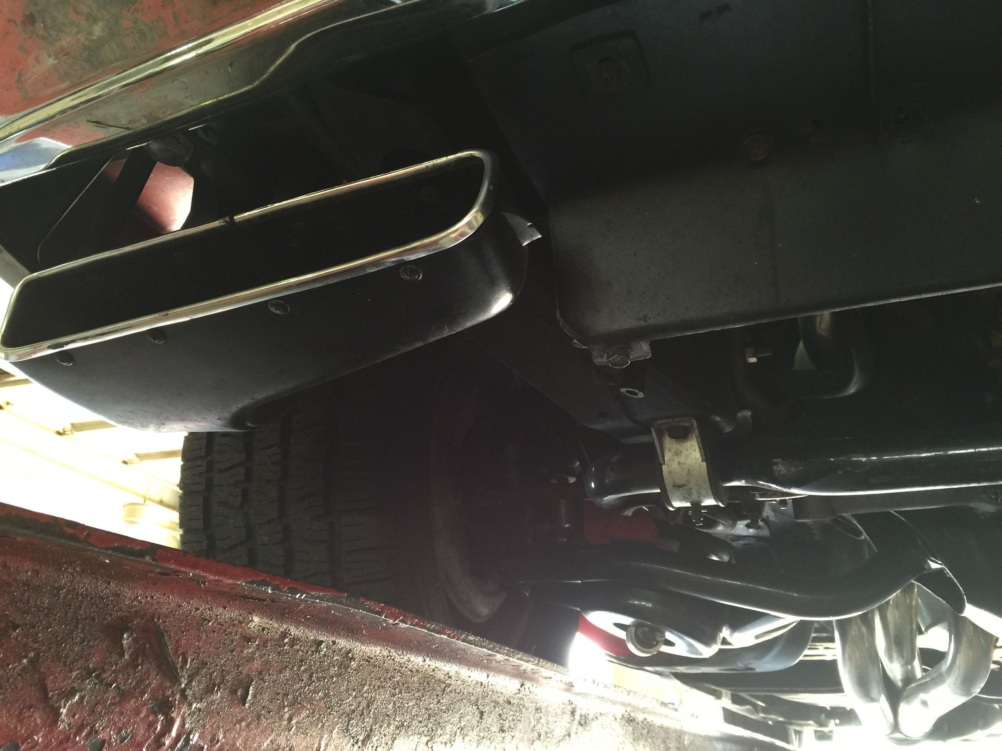

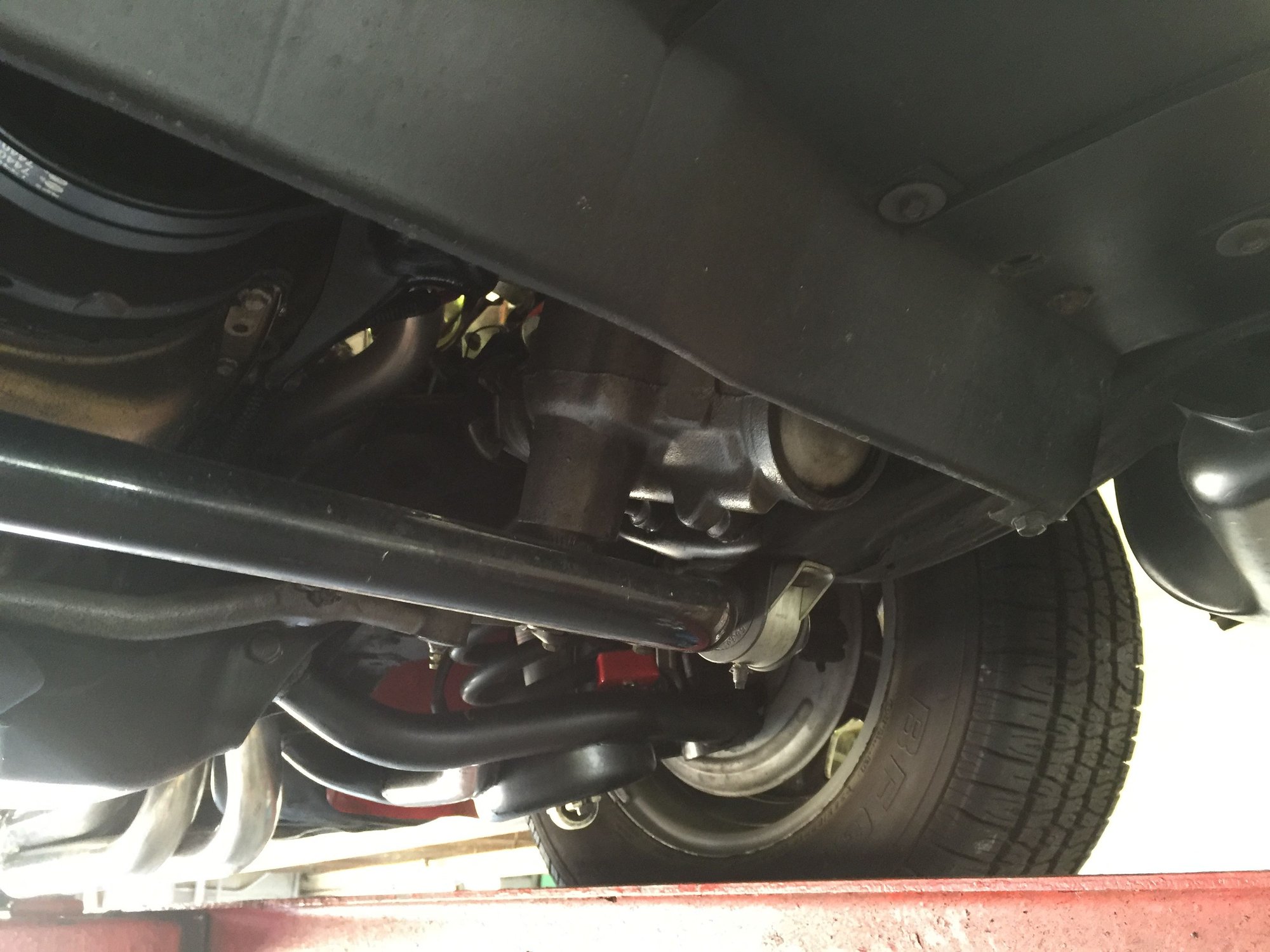

Sorry Mr. BOZ. Here is what I have. Side pic. Hmmmm.
Prior to the lowering. I had a small block in it for a while and then went to a BB w/ Aluminum Heads. It sat too high so I lowered it. I can't find a pic of the car from the side after the suspension work. It was up there as you can see.

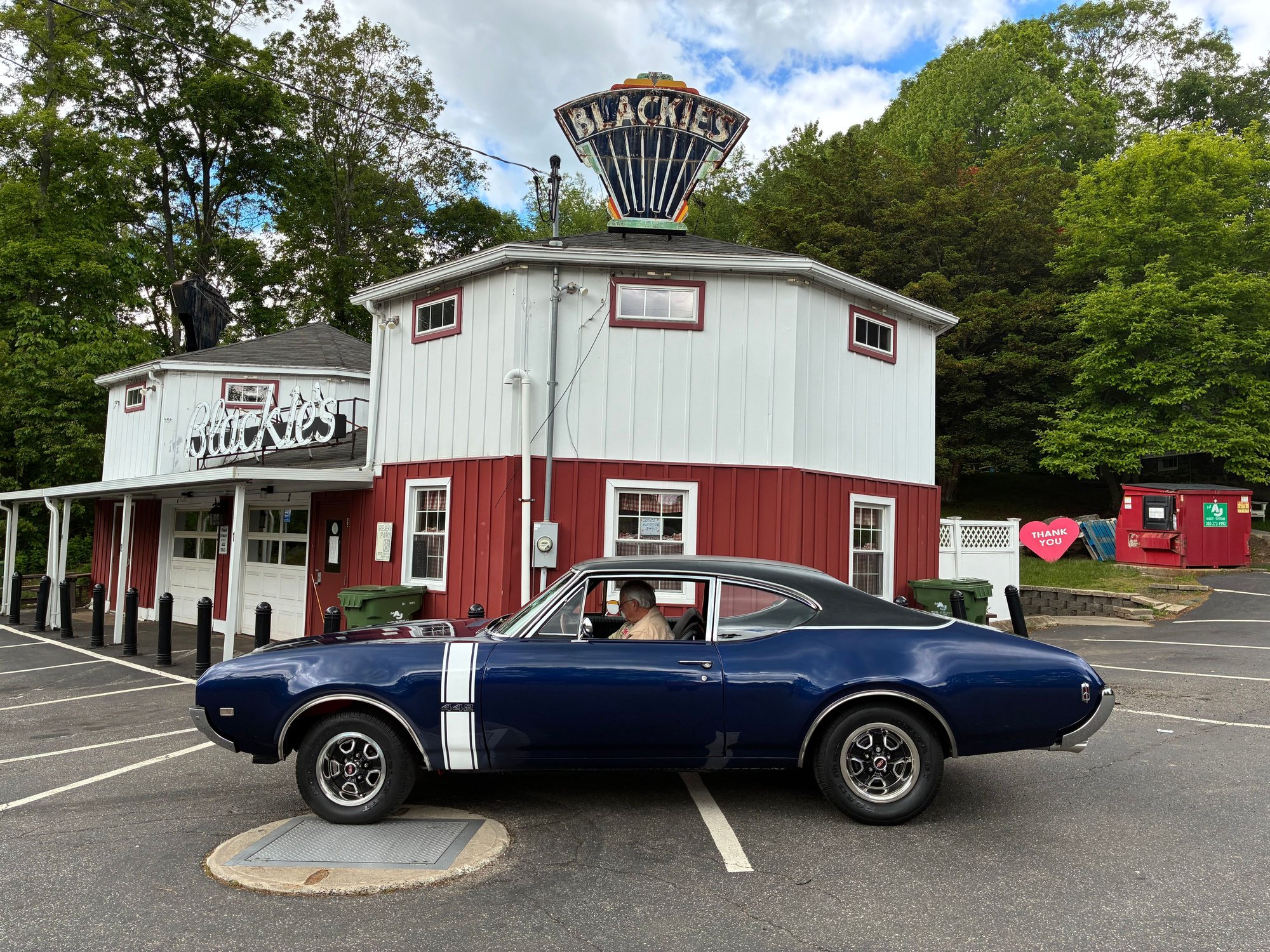

Old Mar 30, 2026 | 05:37 AM
BOZO442's Avatar
Joined: Jul 2022
Posts: 16
So you like my cardboard argent wheel covers. Iwas thinking of painting wheels argent but decided to leave them Blue
