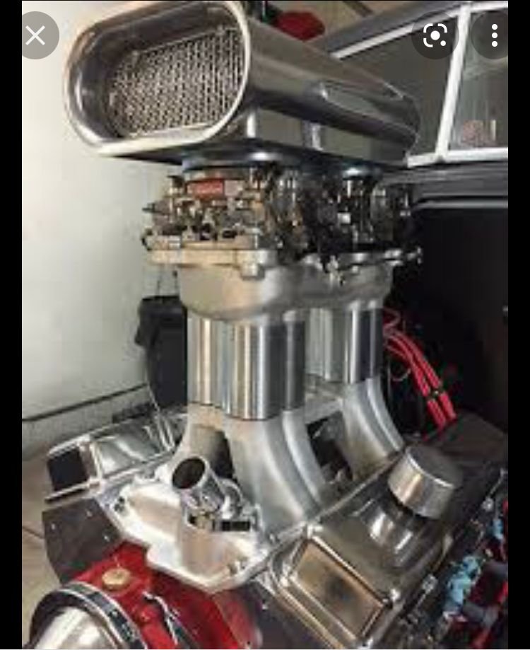

For the life of me, I can't find the intake anywhere. Any links/ideas?
Old Nov 28, 2021 | 02:22 PM
BillK's Avatar
Joined: Dec 2016
Posts: 1,970

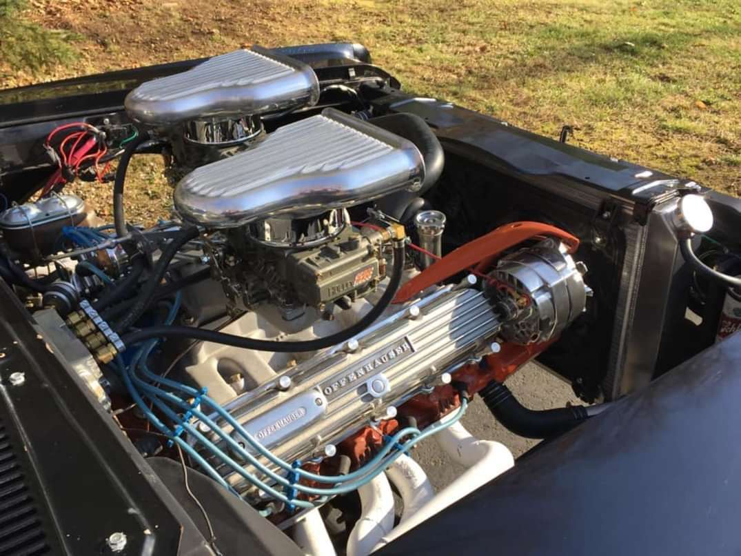

Almost looks like a Two 4BBL inline manifold that somebody has modified. Cant tell what seems to be bolted to the back carburetor pad.
I have a 2x4bbl Offy intake at the shop. I will take a look at it Monday morning.
Old Nov 28, 2021 | 02:24 PM
TimMC's Avatar
Joined: Mar 2013
Posts: 65
From: West Bend Wisconsin
offy 360 dual quad with cross ram adapters?????
https://www.speedwaymotors.com/Dual-...ge,400773.html
Old Nov 28, 2021 | 03:21 PM
hurst68olds's Avatar
Joined: Dec 2010
Posts: 1,580
From: Las Vegas, NV

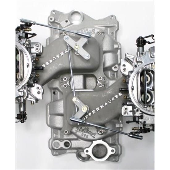

offenhauser #5497 universal cross ram adapters on a 455 dual quad intake #5589
Old Nov 28, 2021 | 03:35 PM
BillK's Avatar
Joined: Dec 2016
Posts: 1,970
There you go It was hard to tell by the picture angle what was bolted to the back flange.

Yeah, that's the intake on my '67 442. My only suggestion is to make your own bell crank throttle linkage if you plan to go this route. I purchased the Offy linkage but once set-up, it was too flimsy for my liking. I also installed a Lokar gas pedal for a '64-'67 Ch****le with a cable pull setup.

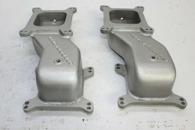

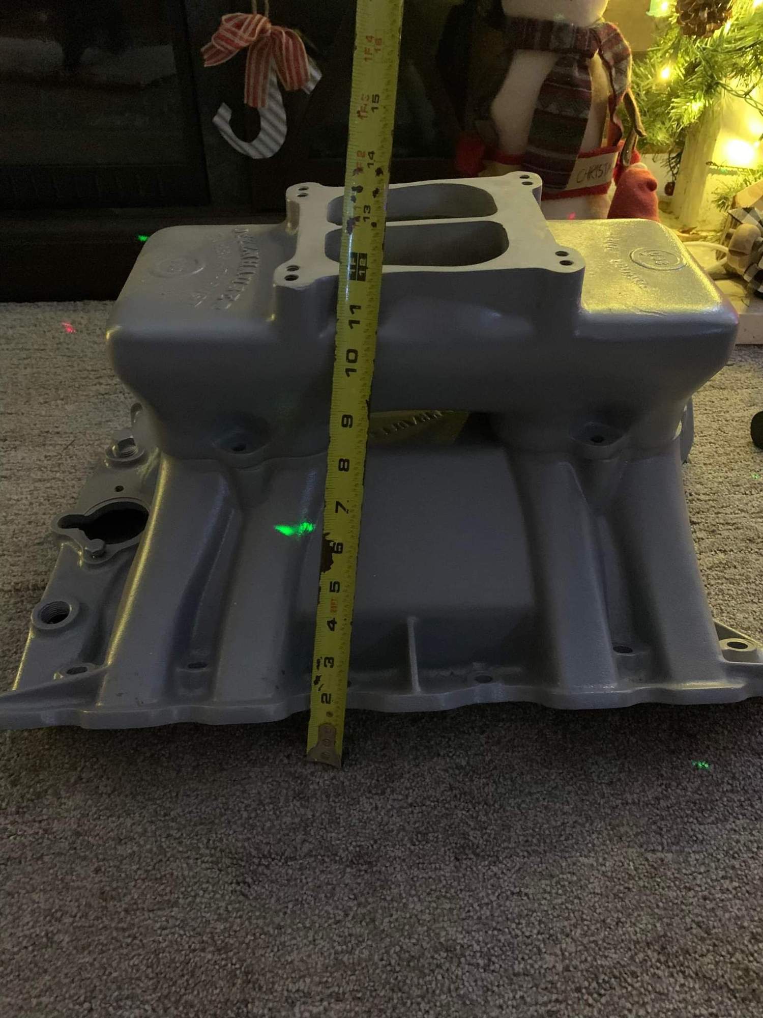

Alright, so I bought this one (should be shipped today). I'm thinking of just keeping the single carb set up for now, but I'd like a bit more height. Any suggestions for spacers between the intake can adapter?
Old Dec 6, 2021 | 08:23 AM
fleming442's Avatar
Posts: 3,858
From: Mt.Ary, MD
I'd have to see a side view, but it looks like a carb spacer would be the easiest, albeit funny looking IMO. You're probably looking at a custom piece for a runner/collector extension or a plenum spacer.
Old Dec 6, 2021 | 11:25 AM
Coastie's Avatar
Stock cars are too boring
Posts: 295
I'd rather avoid a carb spacer because it's already going to look hot enough with just a single carb.

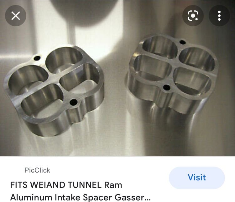

Someone did suggest these, but I'm not sure if they'd fit, or if the application would work.
https://www.ebay.com/itm/23422908136...d&toolid=10050
Old Dec 6, 2021 | 01:36 PM
young olds's Avatar
Posts: 2,044
From: Mt Vernon,WA
Old Dec 6, 2021 | 04:48 PM
fleming442's Avatar
Posts: 3,858
From: Mt.Ary, MD
Well, slap me on the @$$ and call me Sally. I never knew those existed! They look close enough to make work.
