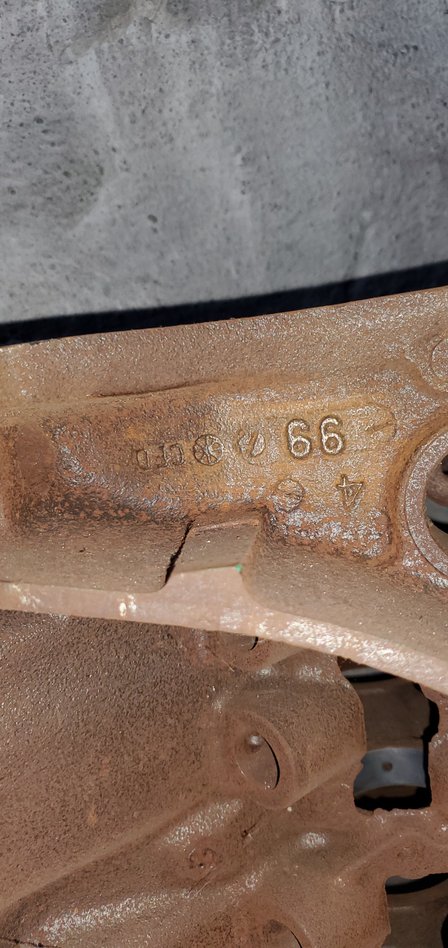

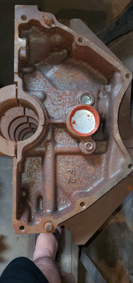

I have a 455 block with C heads but from what? any help is appreciated.

30M622283
3 = Oldsmobile
0 = 1970
M = Lansing assembly
622283 = 22,283rd assigned TORONADO VIN
the "C" heads are from something else 1967-'69

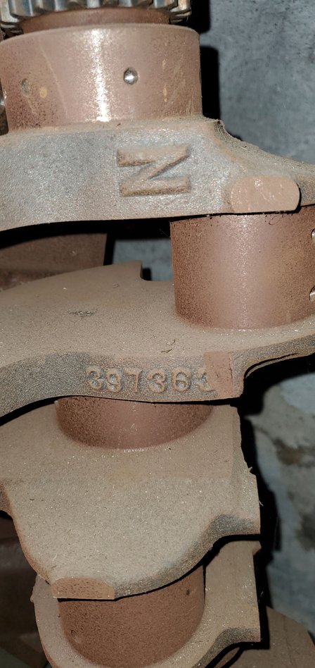

Now I have a N crank looks like 397363 any Idea what that came out of?
the delta or the Toro? Or could it have come out of either one?

N crank pic

That casting is very common and came in all but the 1968 forged steel 455 crankshaft engines.
